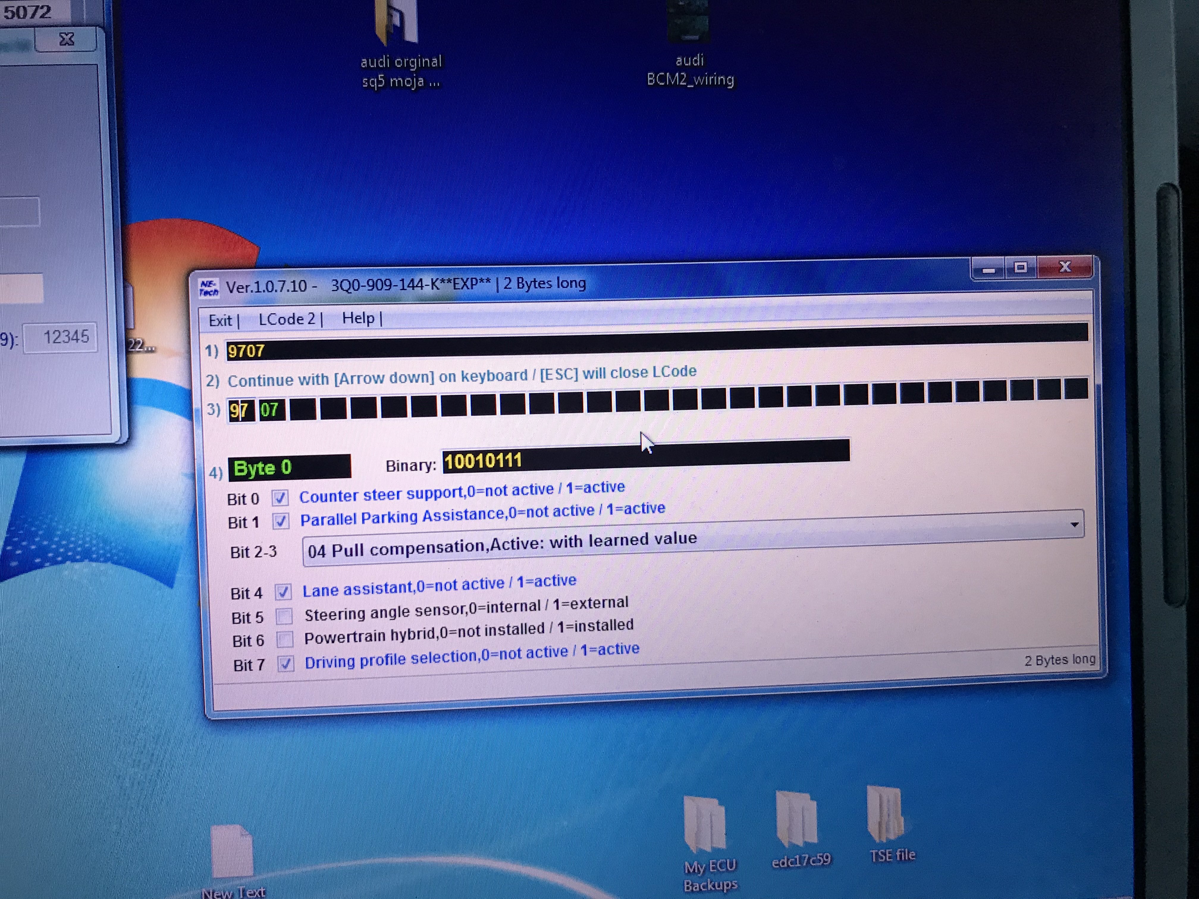

Torque steer compensation security access code
Hey good people, does anyone know what the security access code is for torque steer compensation activation?
I can’t find it anywhere.
also is it with learned or without learned settings.
thanks a million.
Is this for a VCDS setting as an official cable should allow security settings to be seen.
I found the code: it is 19249.
with that you can change the settings. I ve done it already.
