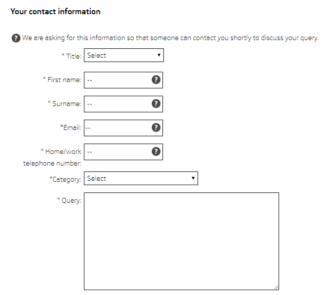

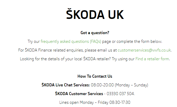

Dealers appear to be the least knowledgeable of everyone.
Contact Skoda UK with your VIN. They'll tell you 5 years, but also the mileage...
https://tools.skoda.co.uk/contact-us
