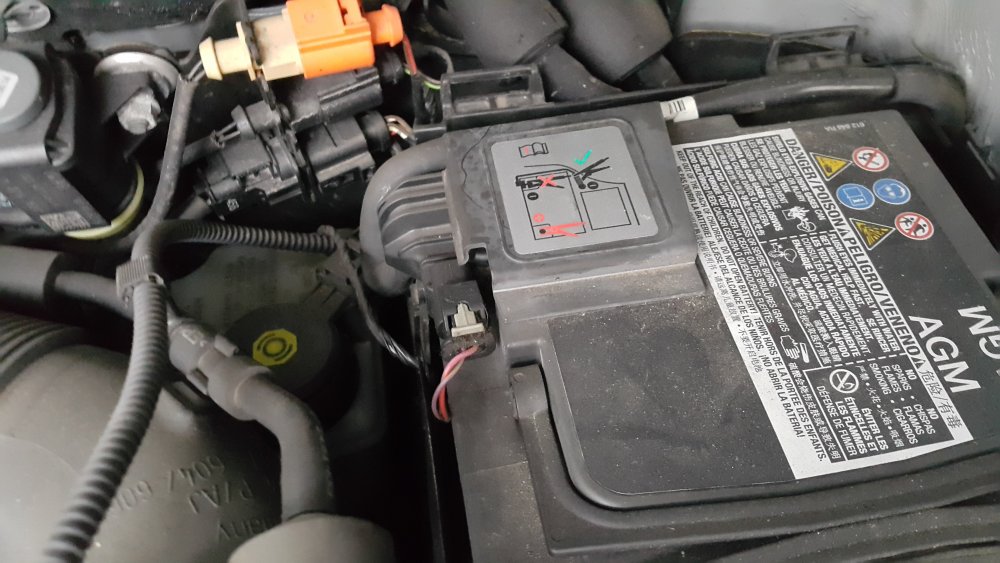

To "jonathan.tong" - I bet you need. If you have this two little cables going out of your battery, I believe you need coding.
Edited by tuningmania
I would also say that it will need recoding...
It needs coding to tell the ECU the battery has been replaced with what manufacturer ,type and amp of battery so that the cars Smart charging can do its stuff
Amy one with VCDS can do it for you..#

The reason specialist is suggested is to make sure you have the right sort of battery fitted and it's correctly coded. If a standard battery was fitted to a stop start with regenerative charging then A) the battery wouldn't last long B ) Stop start may not work C ) It has been know for the battery to explode

For the record, I went with a Varta E39 (570 901 076) silver dynamic AGM battery from Tayna. I took it to my local dealer/specialist who fitted, coded and did whatever else they needed to do. Everything seems to be working just fine again - for example the stop/start started working again on the return journey, having previously stopped working.
I think they charged me half an hour which I was happy with - and they kept my old battery which they also confirmed as faulty.
