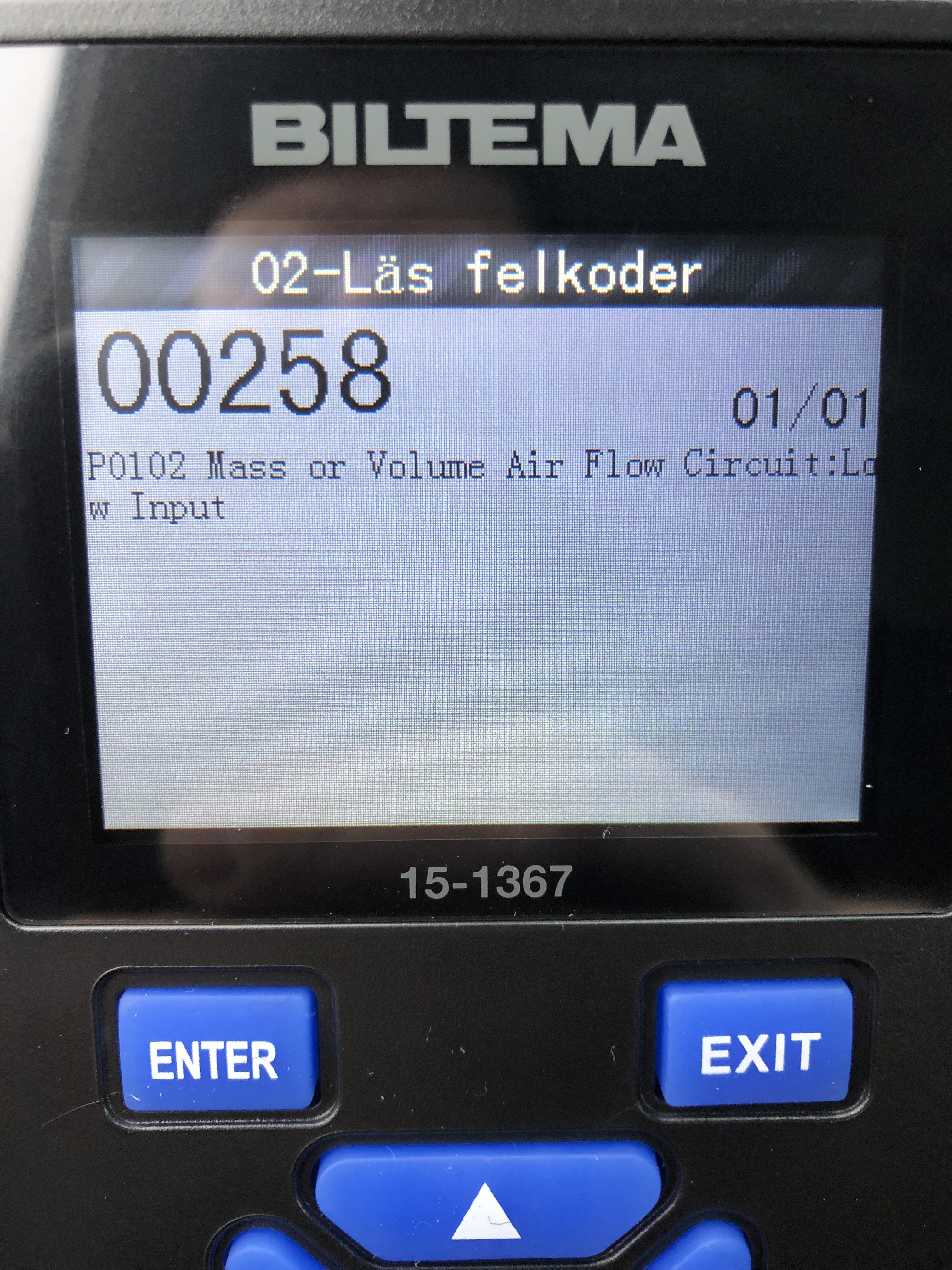

Okay, so I got this faultcode. Hoping its the sensor. But what eles could it be?
