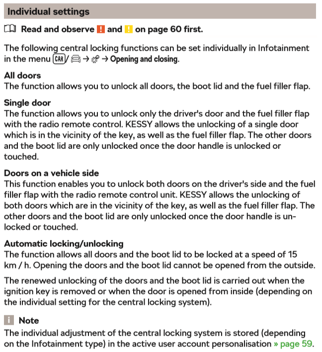

You can set the car up, so that when using the key fob, one press of the unlock button either opens all the doors (and fuel filler flap), or just the drivers door...

Thanks for all your help, I think I may have solved it now, I have KESSY and need to do the double tap to open the passenger doors, but as you say I can turn this off in the multitude of menus...  The problem I have with locking is because, and as in the words of the late, great Steve Jobs, I was holding it wrong.  Basically, by grabbing the whole handle then pressing the nub, I was both locking and unlocking at the same time which confused the car, and made it give up on the KESSY.  So now I've adjusted my technique to not grab the handle and just thumb press the nub.
