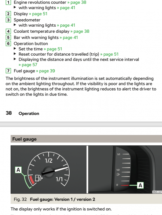

It’s your Kodiaq kindly telling  you it’s dark and you haven’t got your headlights on. If you leave the light switch on auto you don’t get this problem.
From the owners manual....
Thanks...the only thing is the light switch is always left on Auto...which is what puzzled here...ingition off>on saw the lights come back on...she even made the point that the headlights were on ...although in the video its hard to be sure. I'll monitor it and see what happens...its either headlight switch not on auto or some electrical issue about to show its head I guess.
