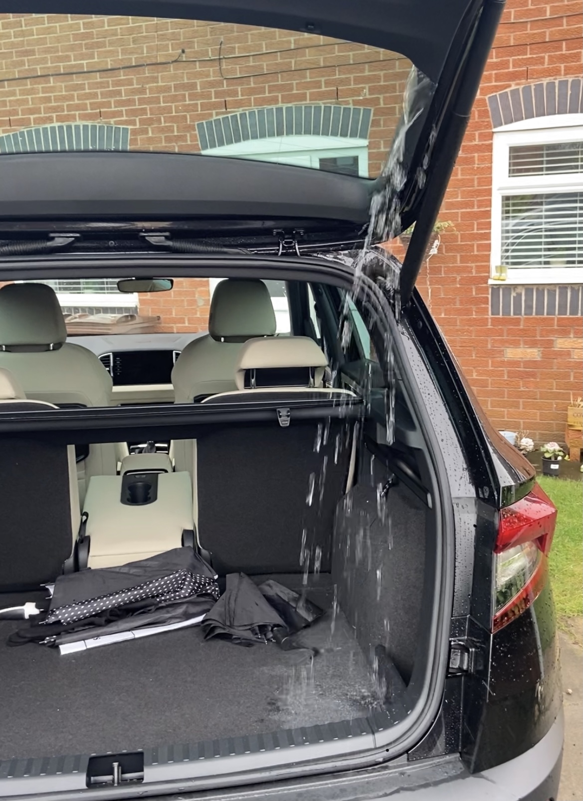

My first post on here after buying a brand new Karoq Edition (panoramic sunroof) 2 months ago.
I've also had this issue with water coming in from the boot lid when it lifts up.
It comes in mainly on the right side but has also been happening less so on the left side too.
I haven't noticed any ingress in the footwells yet but it's early days I suppose.
I have also noticed condensation in the front headlights and the driver's electronic seat adjustment has been a bit of a problem also. It only works when it wants to and is very temperamental (I'm not sure if this is down to water).
The car is currently back with the dealership awaiting a fix. They have provided me with a Fabia as a courtesy car.
I bought it outright so I'm not sure how I'd stand in terms or sending it back as a bad job. Very annoying on a brand new vehicle.
Are there any grounds for sending a car back for a refund or a different model so soon into ownership?
Looks like your tailgate is filling up with water and pouring out of the inside trim when it lifts up.It is either the rear windscreen which has popped its seal or possibly the rear windscreen wiper - both are comon problems with the Karoq but Skoda still deny they have a problem. I don't know how you stand  with trying to return your car I have the same problem as I bought mine outright and have water ingress in the front footwell. My car has been with the dealership for seven weeks but they say I might get it back next week. My issue was apparently the front windscreen which had popped it's seal. They have replaced the windscreen but have been waiting for a new headlining and other parts to put the car back together. I know we had Christmas in between but it really is not good service and they clearly have issues with their production line if the windscreen are not being fitted properly. I have little confidence and would be kicking up merry hell if it wasn't for Covid .

My leak turned out to be the rubber electrical trunking between the car roof and tailgate, not sealing after a rear dashcam was fitted, sorted it myself and car is now bone dry. When I originally booked it in though I was offered either a Kamiq or Scala, neither really suitable for my two dogs.
