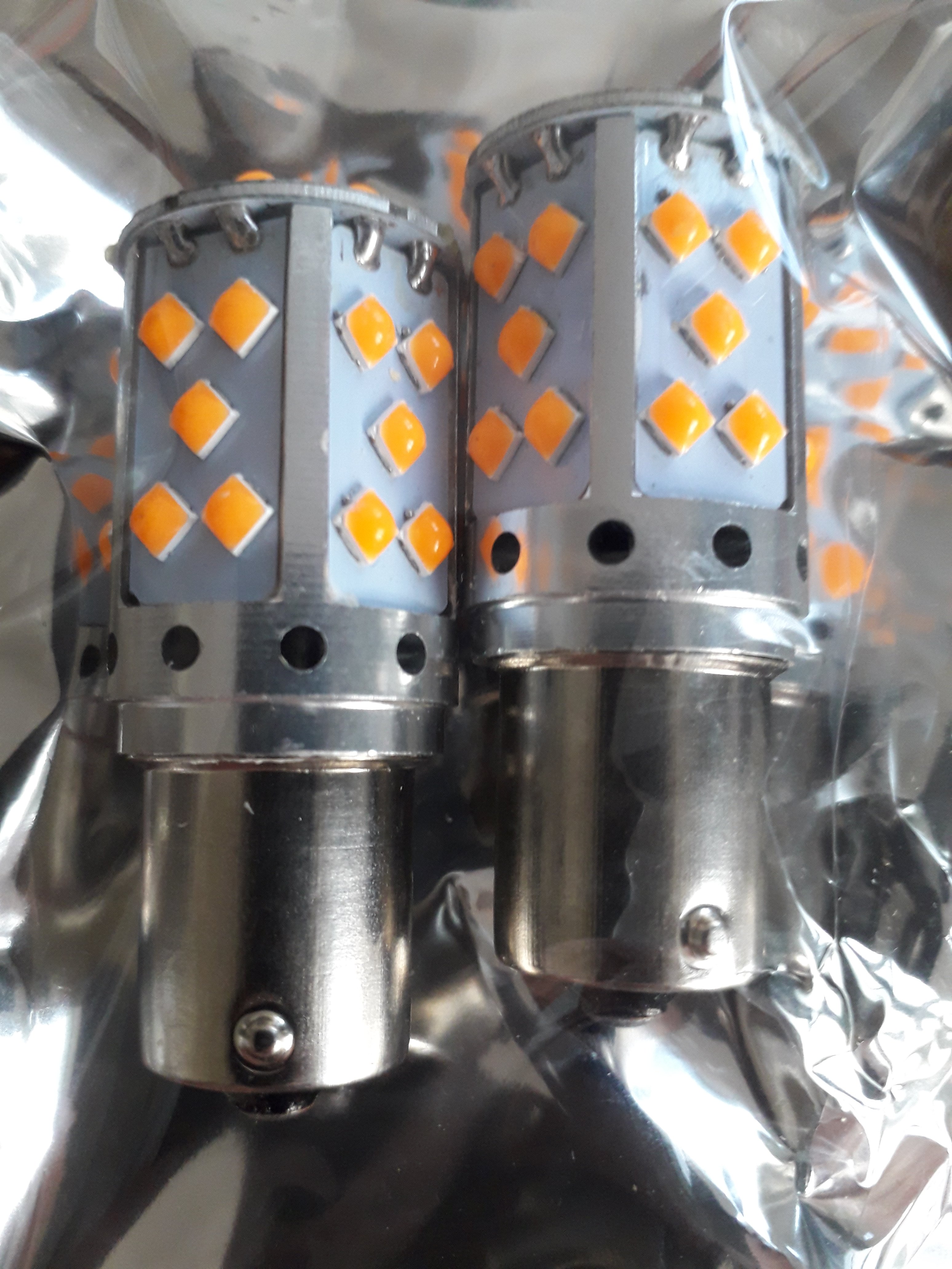

  • I have this LED's and they are great: https://www.aliexpress.com/store/product/Canbus-Error-Free-No-Hyper-Flash-Amber-Turn-Signal-BAU15S-BA15S-PY21W-1156-S25-LED-Bulbs/1396454_32945895534.html?spm=211
  • Hi!   No problem. No, for $15 you get one pair (2 bulbs). Description is wrong.
  • They look good! Two pairs ordered!

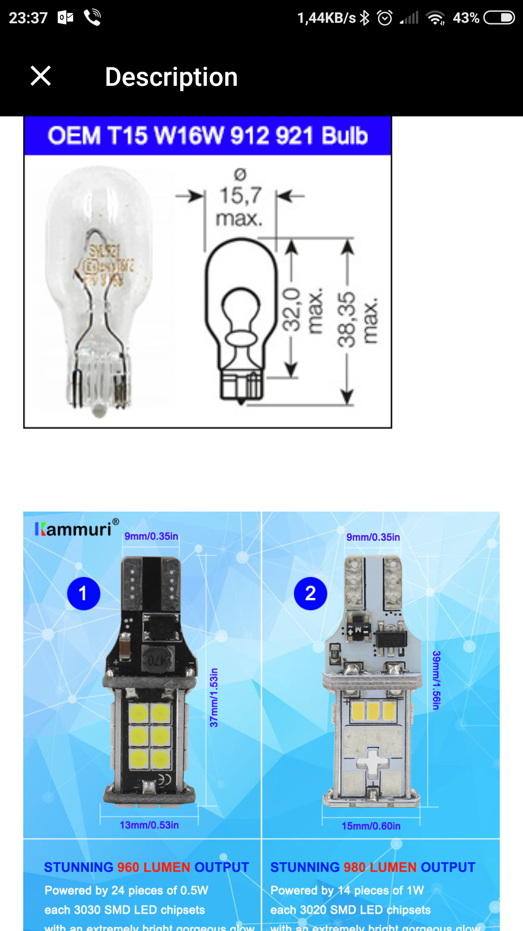

Unfortunately the brake / tail bulb on the Superb is T15 W16W. I'm not sure if these LED bulbs can dim to operate the 5W tail mode, and then get brighter for the 16W brake light mode.
Think I might need to buy some and try it!
But then I'll need the T10 W5W bulbs to complete the look, but I think they're too long...
Decisions. decisions :D
Glad to help :D Thats's interesting. Never seen this before because I never owned superb. :-)
You can ask sellers if they will dimm. Size is not problematic:

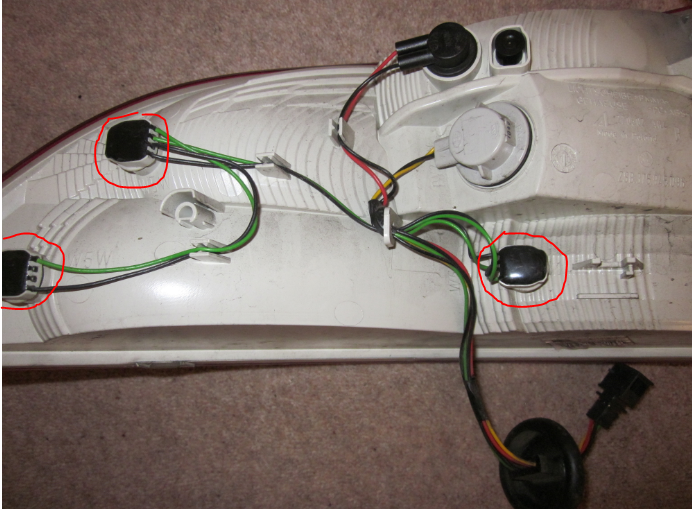

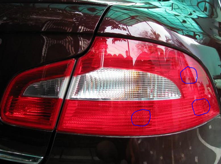

I changed all rear bulbs to LED and they work like charm. Combi version in each rear lamp has 3xP21W white, 1xPY21W amber and 1xT10 white clearence / position light. You can see picture attached. From same seller I ordered all bulbs. But he has no white in his store anymore.
I will post video wich shows reverse bulb in action. Shines like heaven.
This rear cluster looks great the the revers bulb is amazing!!!!

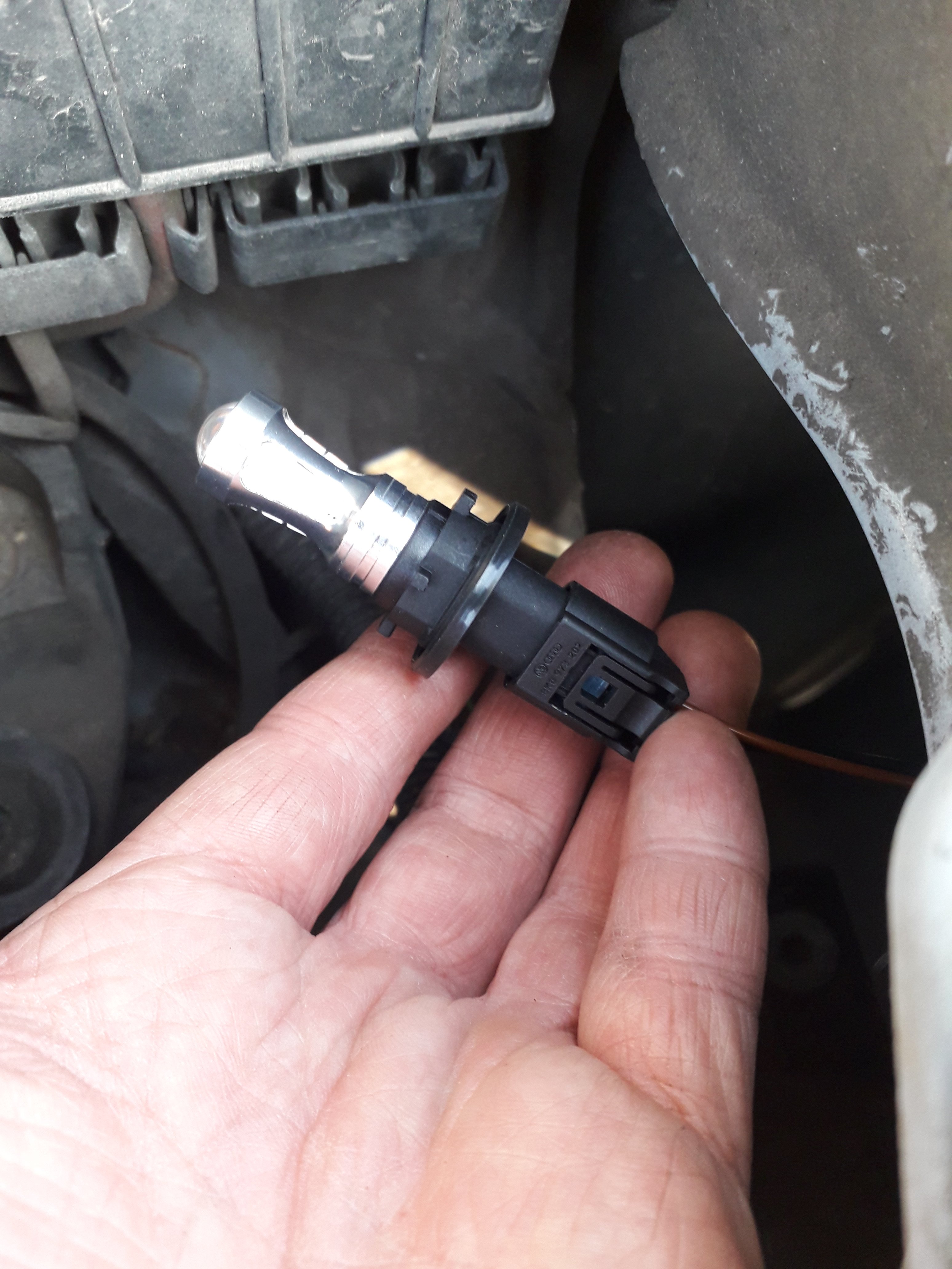

For the front side lights I used these bulbs as they fit and don't hit the lens. What I don't like is they are black!
I have seen RED led behind a red lens and I dont like it. It looks to red I know that sounds stupid but I think its to dark!

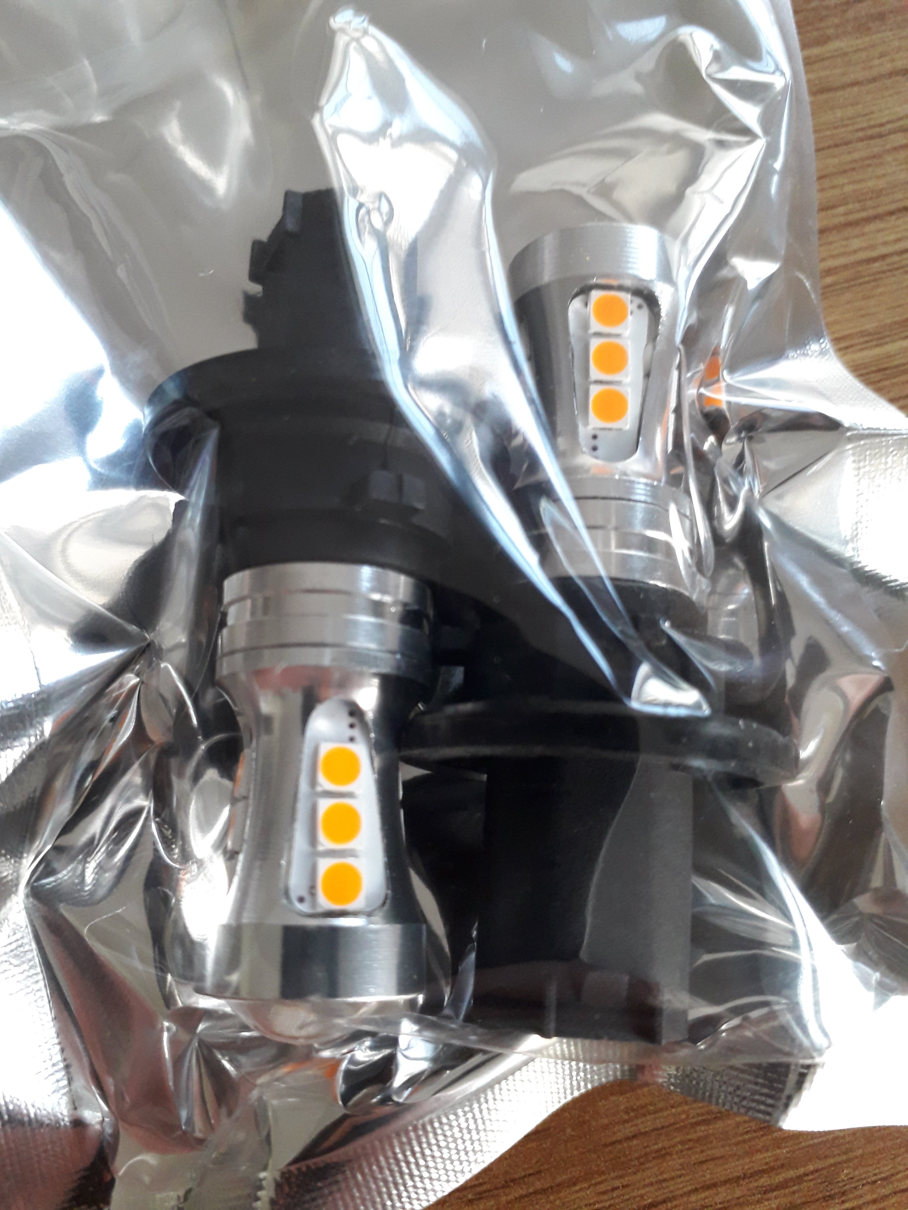

Wow, those T10 are exactly the same bulbs I ordered. In 2 weeks will be delivered:-D To they get hot? Housing is made from aluminium? Do you have pictures how they shine?

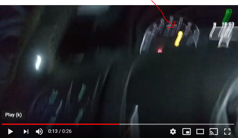

Blown bulb warning in the video you posted :-(
For you I will take pictures tomorrow. Like I say I don't like the black on show jut like I dont like orange bulbs on show its a personal thing I guess. But as you know we are limited on space!!!

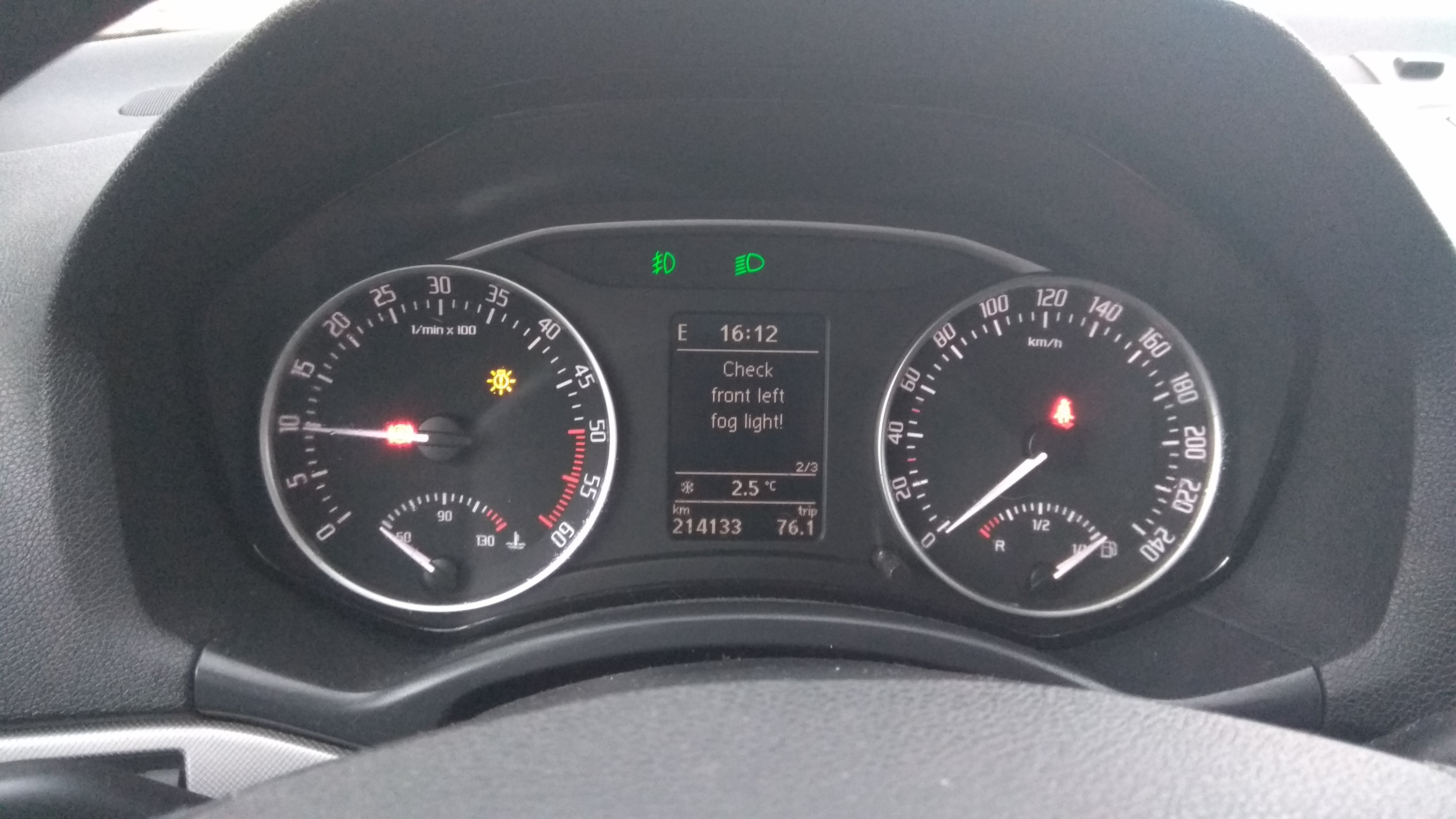

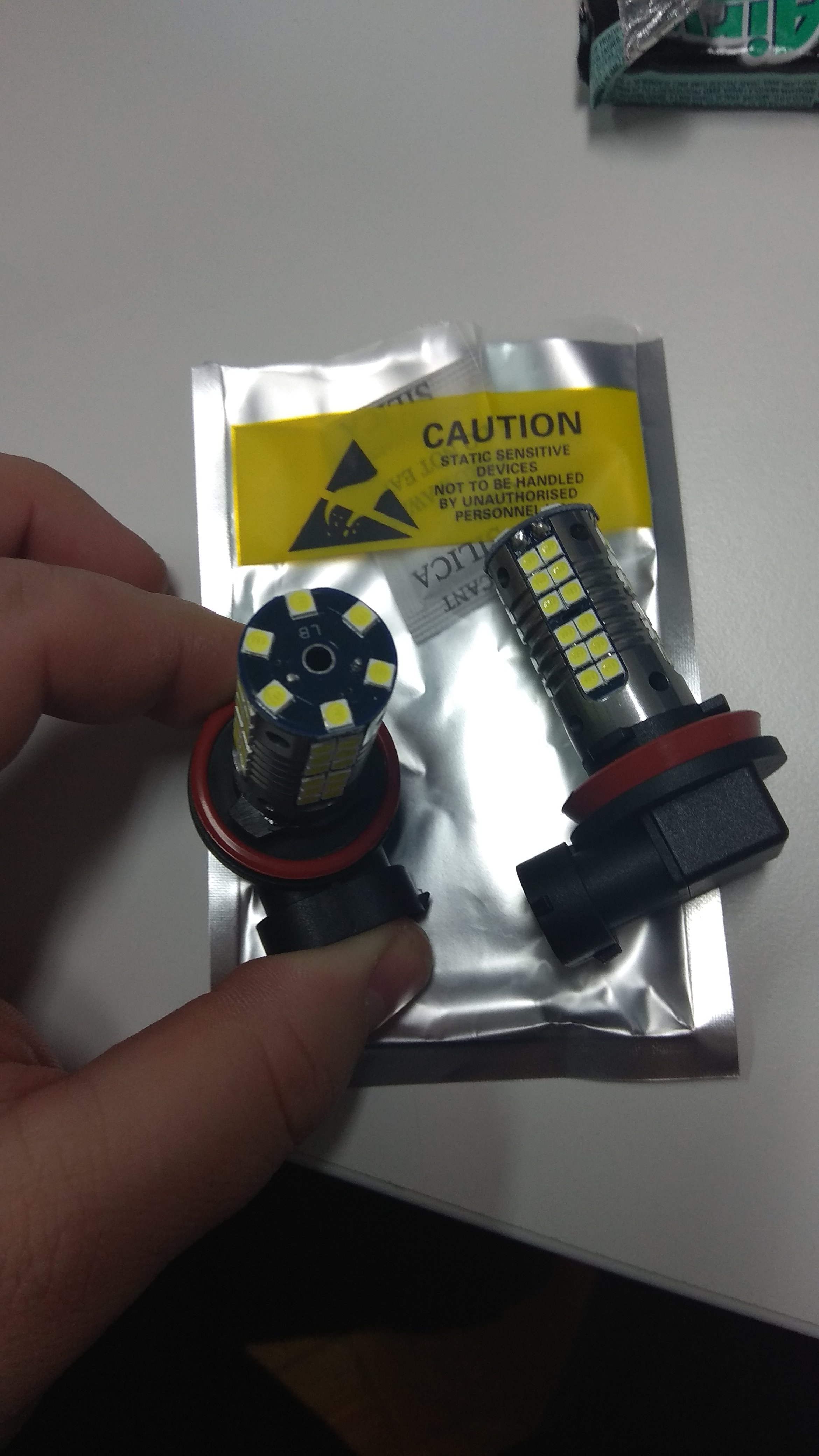

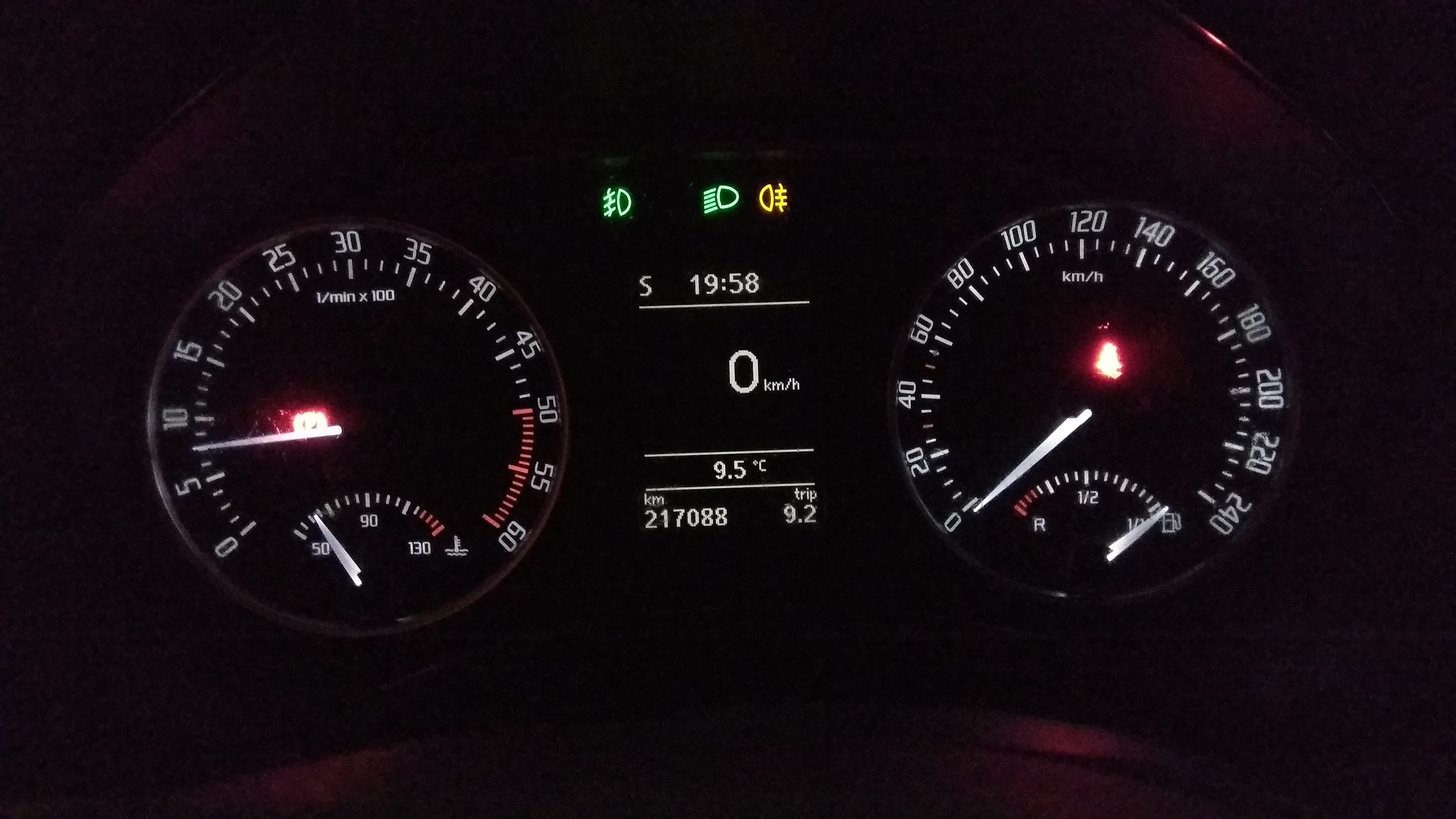

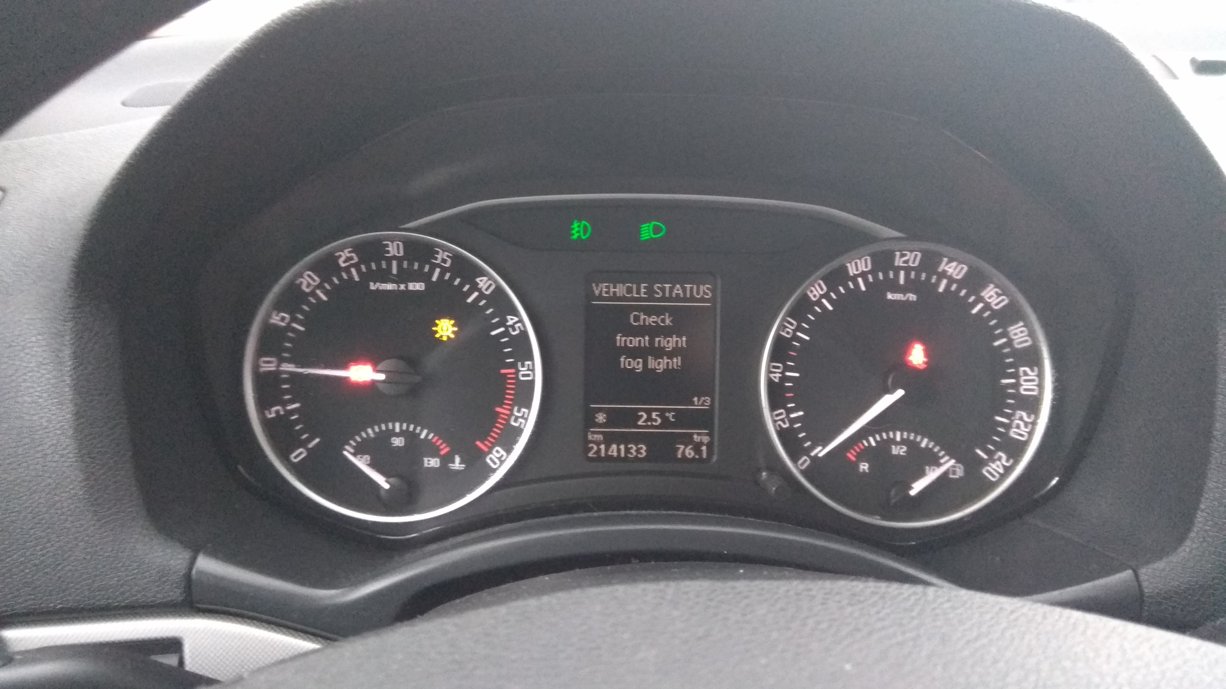

Yes, error is produced by H8 LED fog. :-)
This ones are listed in Vendy store at A L I. Seller says they are canbus ready for octavia 2 fl. But they are not. However, on O3 they work great. :-)

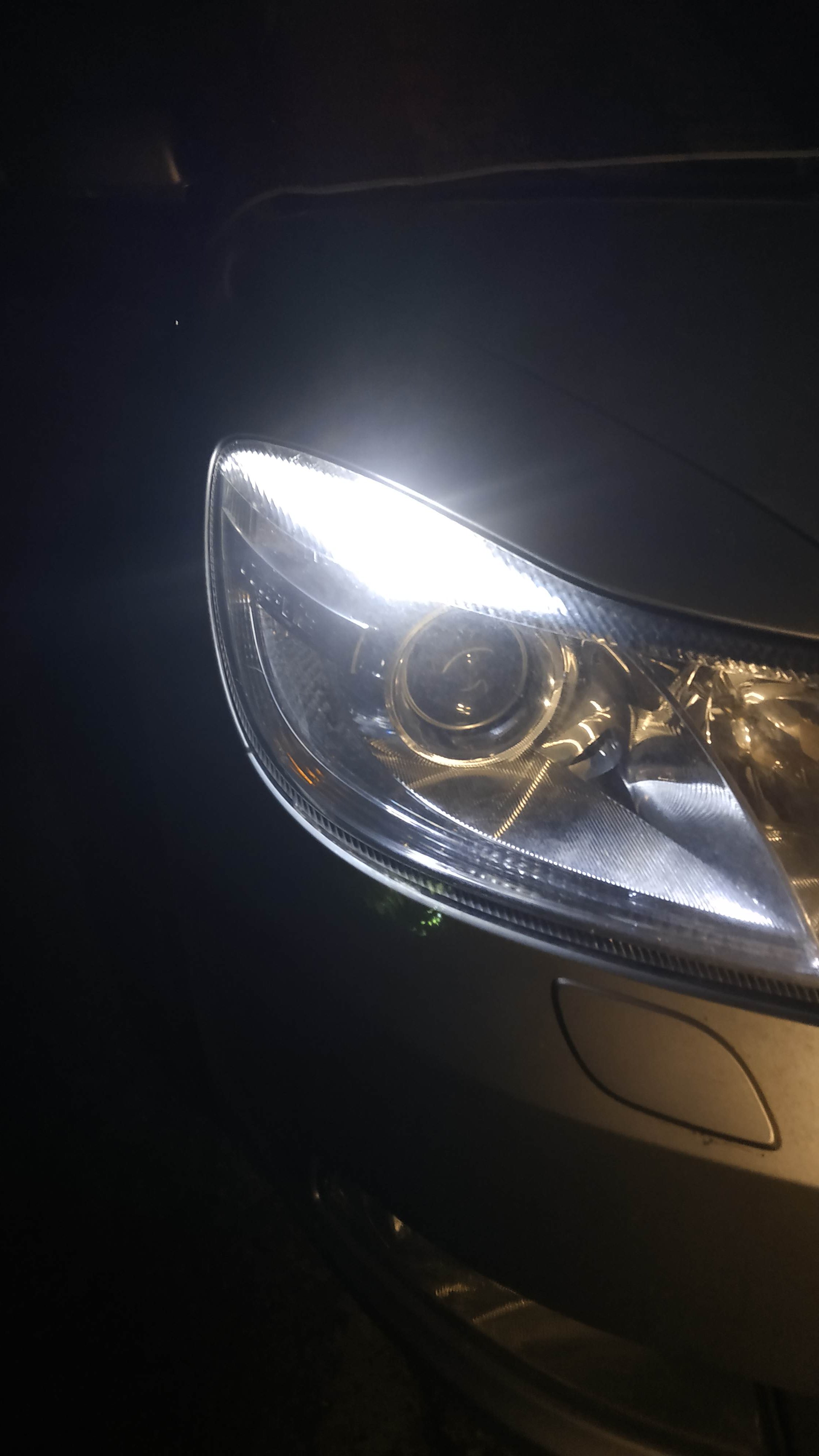

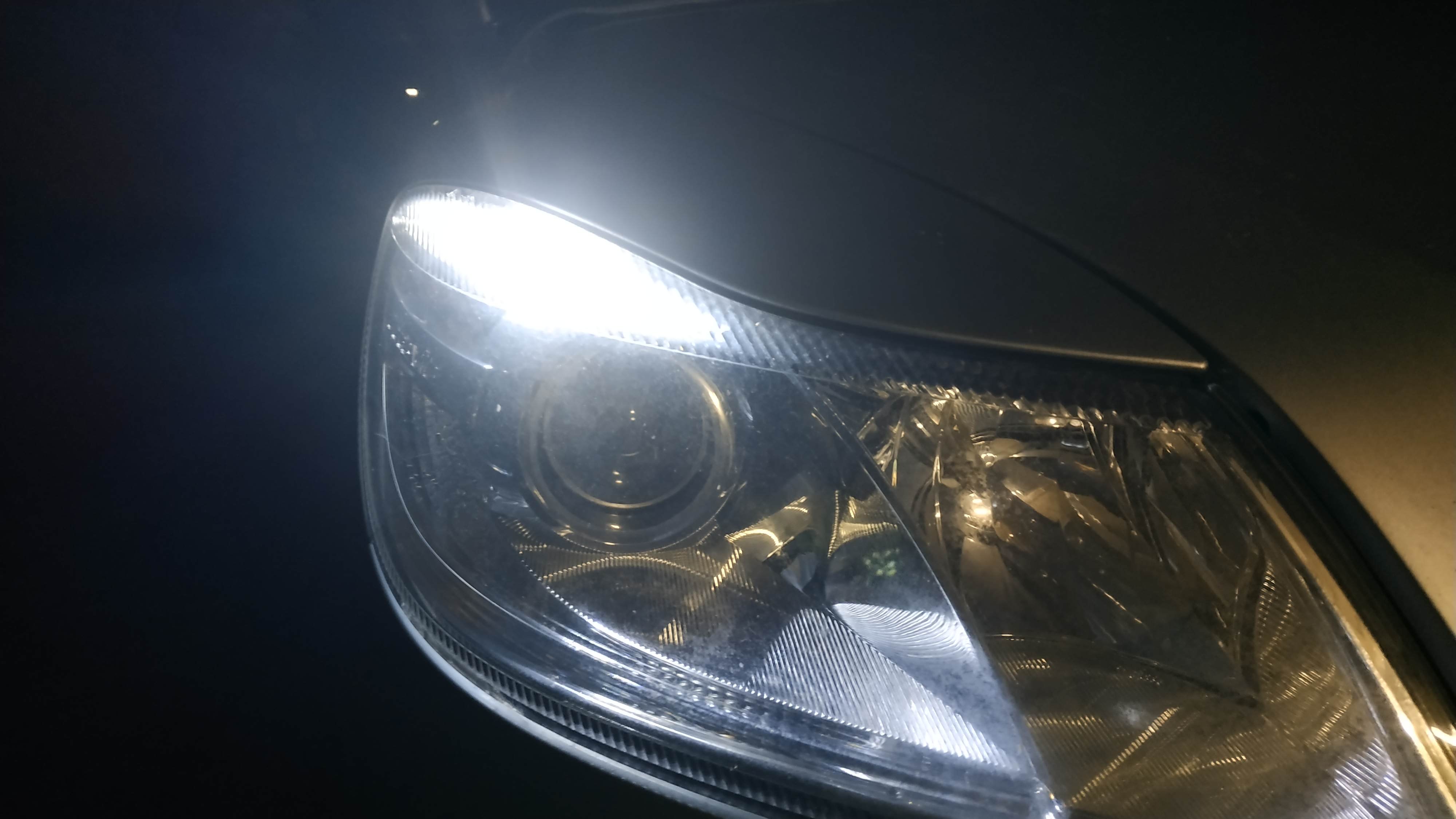

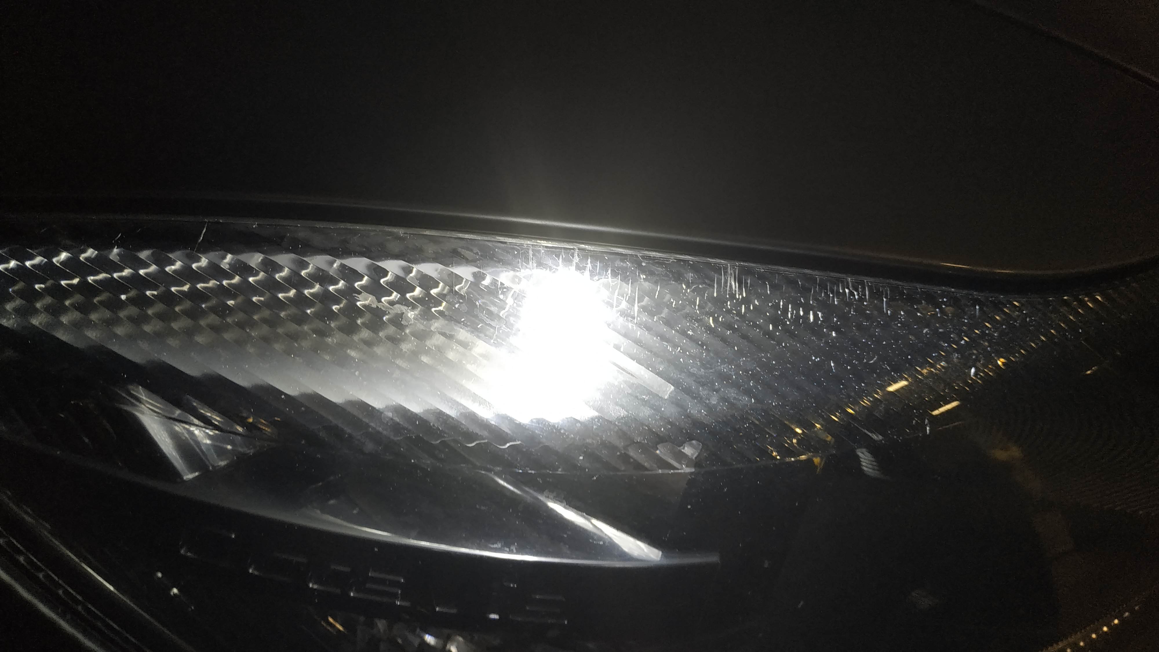

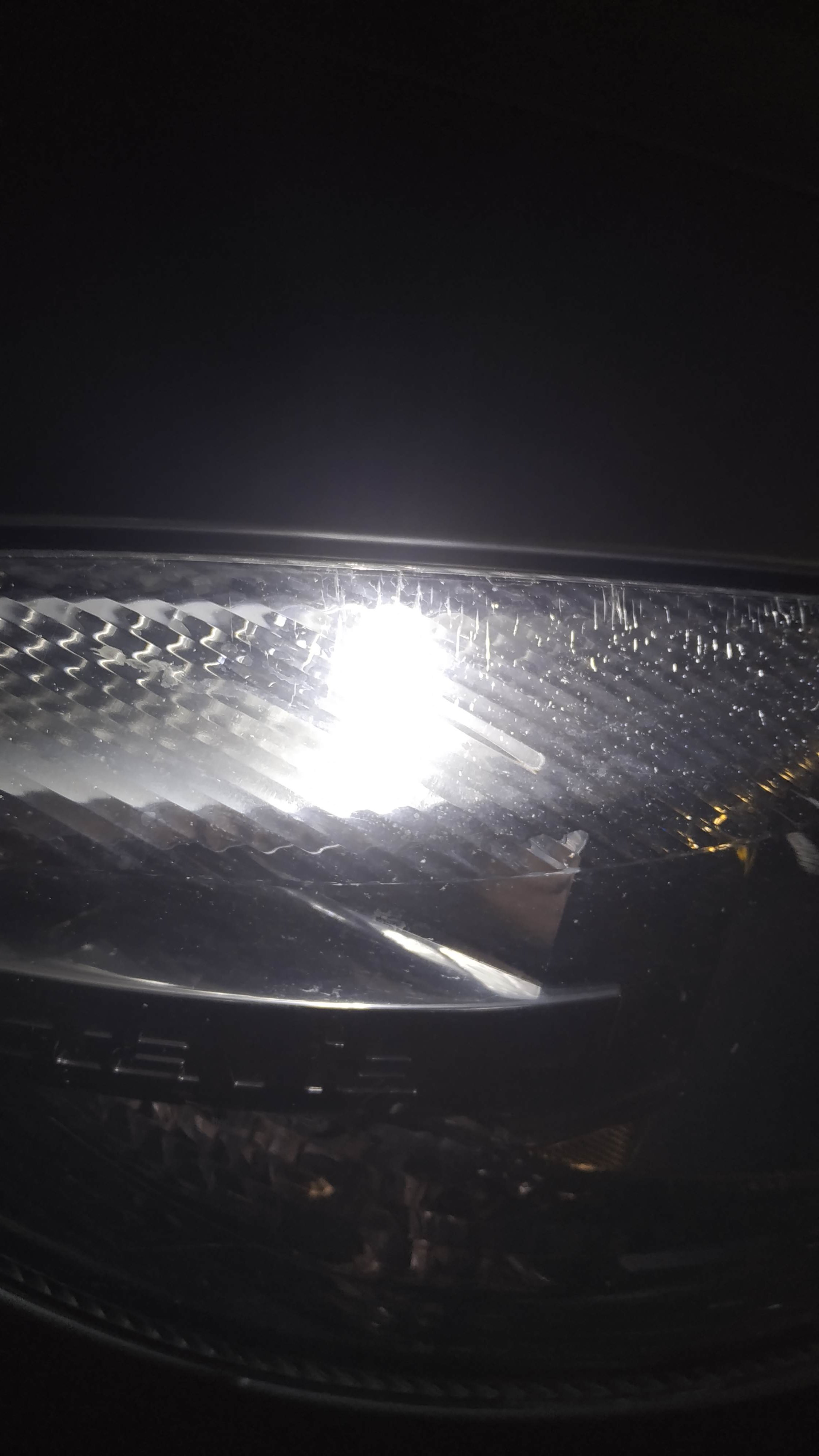

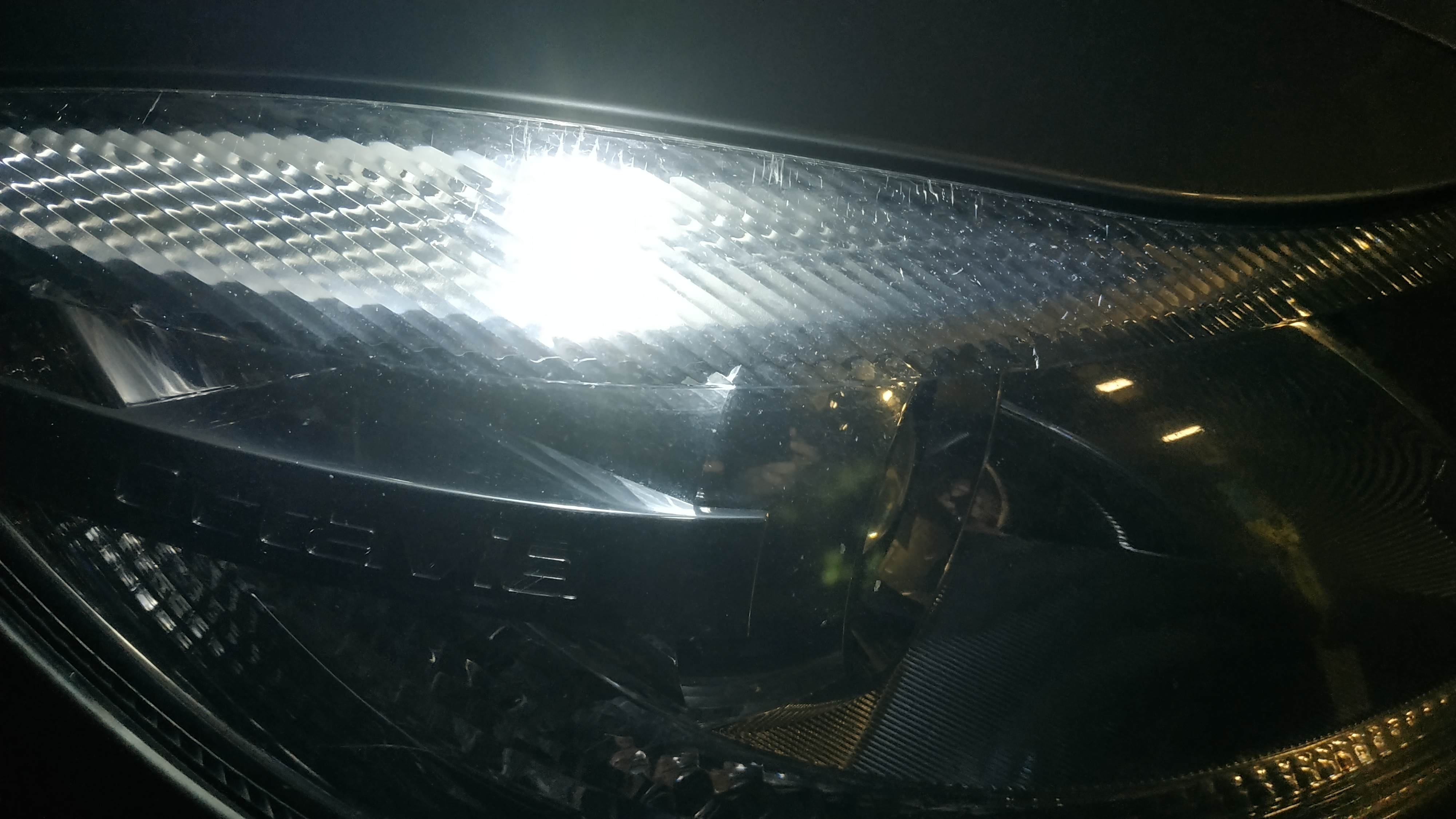

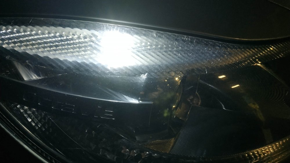

Here you go
Looking great! ty :biggrin:

No...only unsolved problems with H8 LED blown bulb error on dash. Tried regular 8Ohm resistors but they are hot as hell. I'm thinking to get this resistors:

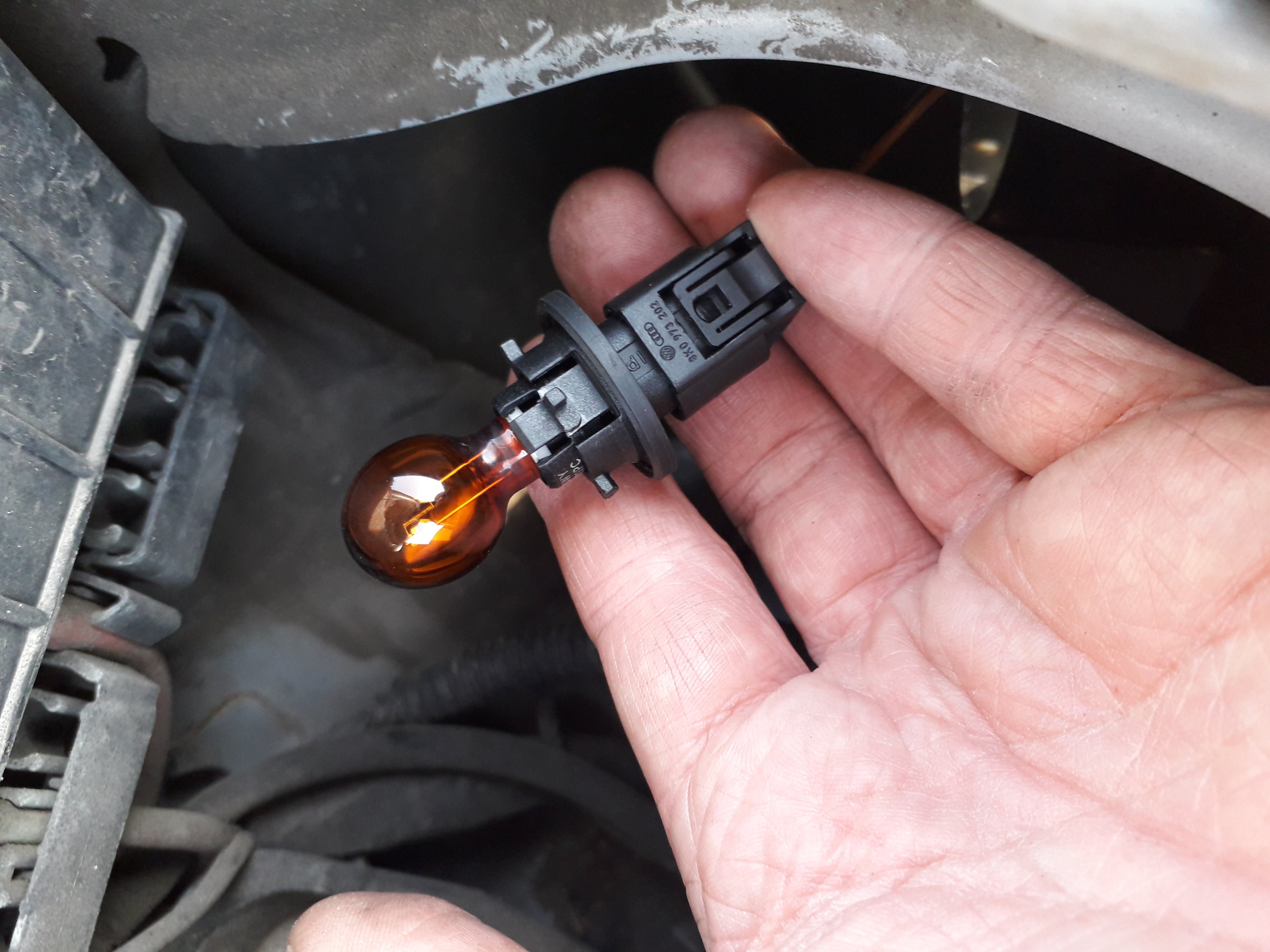

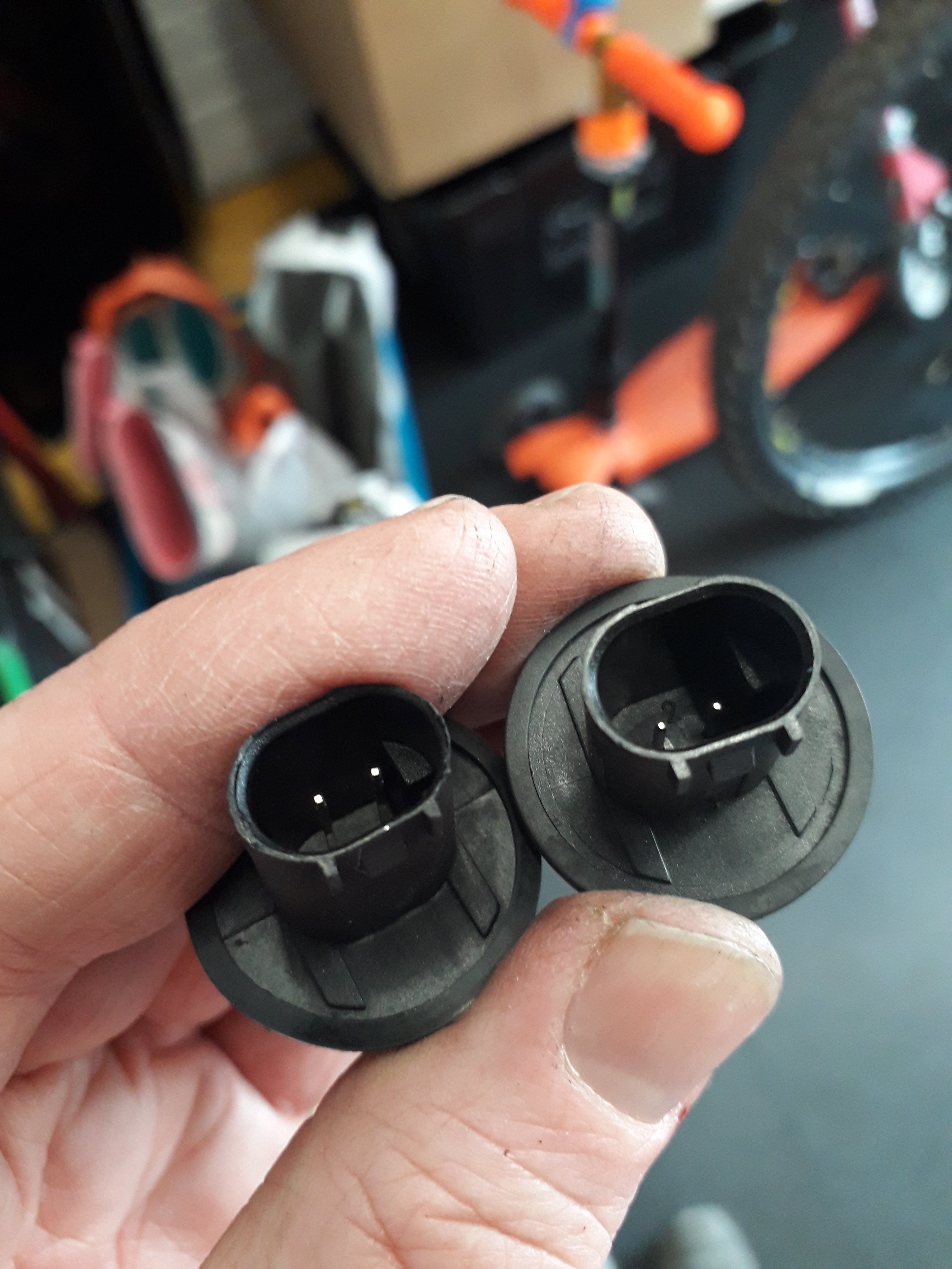

No such luck with the fronts though.

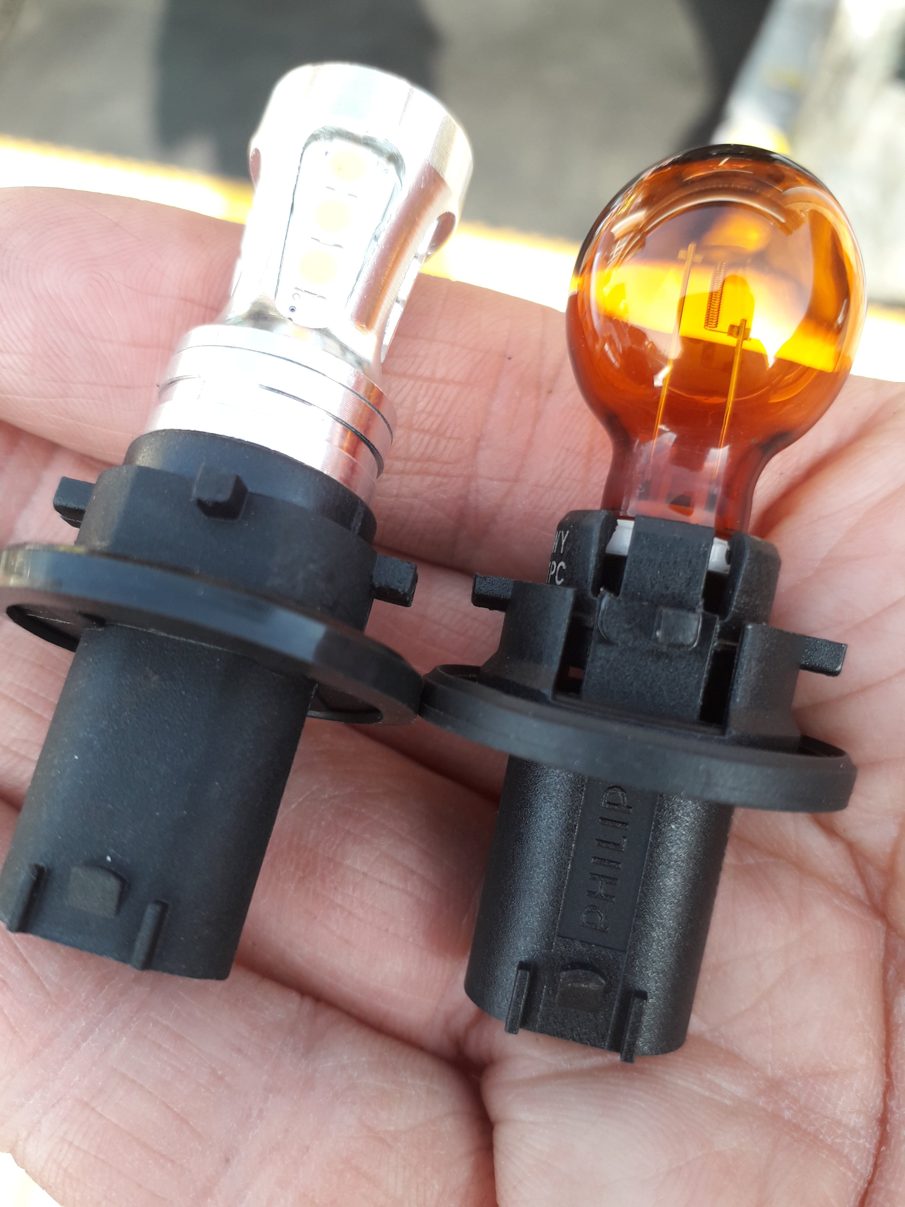

The metal prongs inside the LED bulb caps are much longer than those on the standard Philips incandescent bulbs, which prevented them from fitting into the bulb holder properly. They worked but the longer prongs prevented the bulb from fully seating into the holder.
LED on the left, original on the right...
I tried shortening the contacts with a Dremel type tool but they snapped :-(

Ordered one pair today. I expect them to be delivered next week. Seller says those resistors are not so hot as ceramic ones because they are exactly fitted for o2 fl H8
Resistors are here, and they are great. H8 fog LED's dimming nicely. :-) After 10min resistor are barely warm. Just enough resistance to work without error on dash. Very happy. :-)

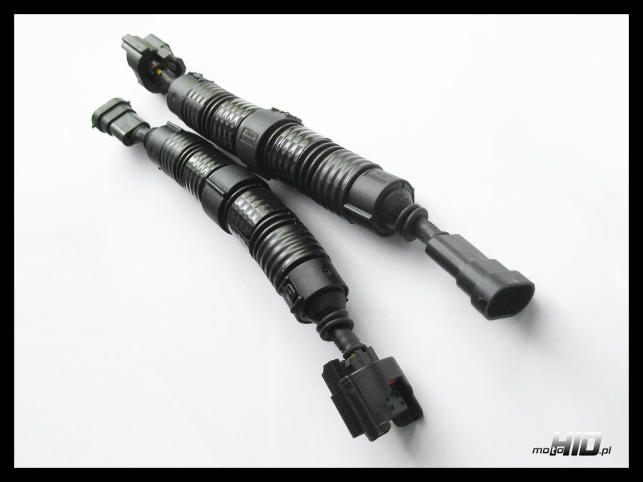

Do you have a link to the resistors, my LED fogs do not give a warning on the dash... but they also do not dim either :sadsmile:
Is the dimming a standard feature?
The cornering fogs should dim in the same way as they do in the Octavia.
I'm guessing LED's don't fade in or fade out as well as incandescent bulbs...
Yes they dim as std, but when you fit LED’s they usually stop dimming due to the low power needed.
These adapter looms with the resistor fitted just waste the extra power not needed in as heat, hence they use the normal power and will dim.
