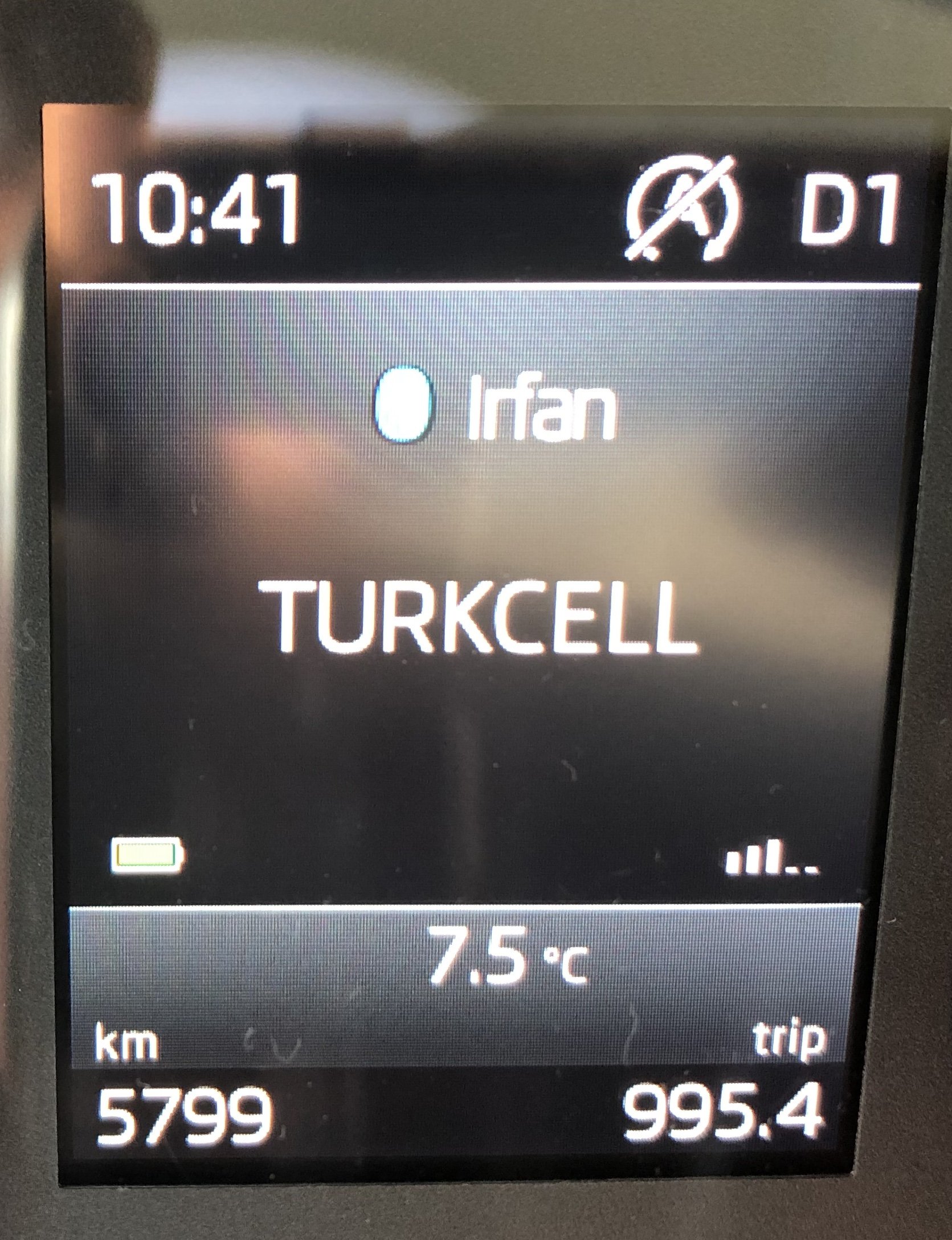

My car does not have phone charging facility but green battery state icon is present
I have the Edition model. I don't have phone charging facility. The battery charge icon is shown in green to the left of the signal strength bars.
