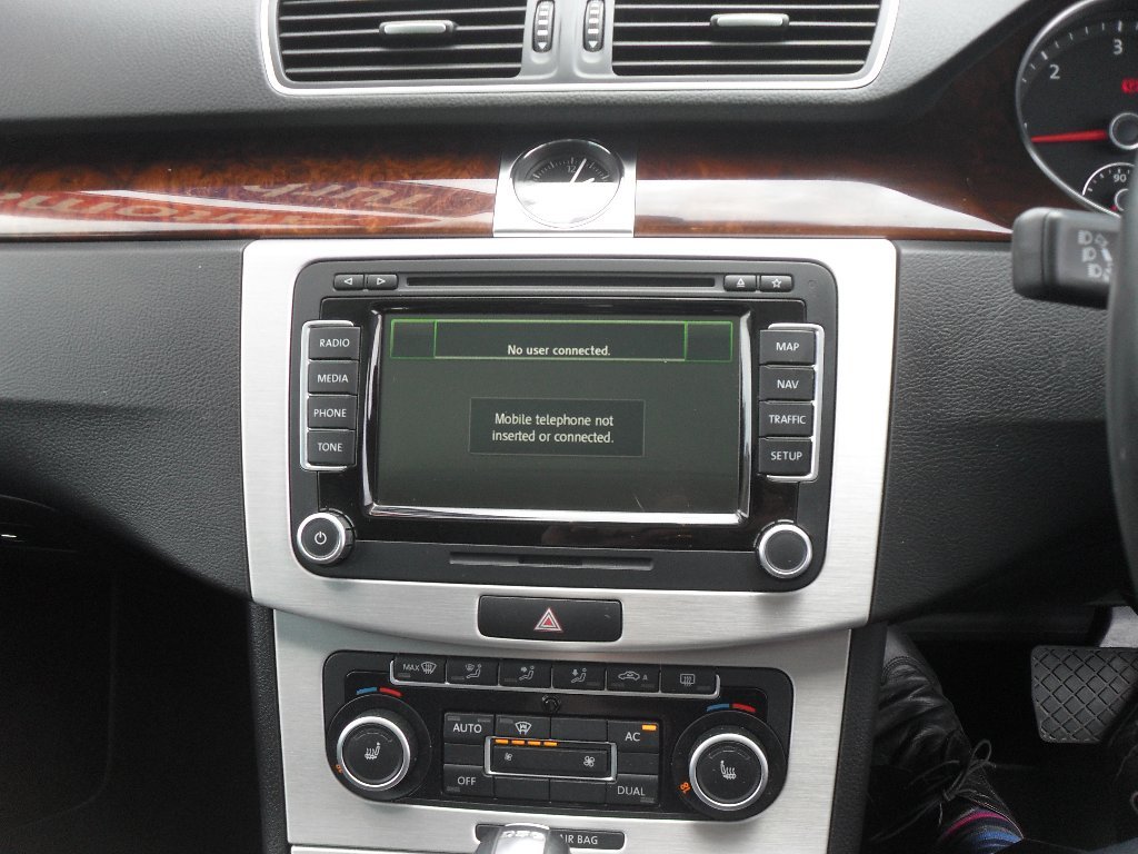

I did have full ! steering wheel control for my bluetooth which worked great before , but now its pants , not happy with the bluetooth on this unit for my phone as it interfeers with my built in vw bluetooth !, the sound package is a £1100 , upgrade on my car but it has no seperate amp like the dynaudio system !, I replaced the head unit as my rns 510 gave up on the sat nav , but every thing else worked fine , i wanted a bigger screen also,ive aded a pic of my standard head unit which will be identical to yourse,
