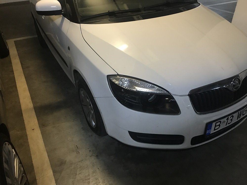

paint black headlights

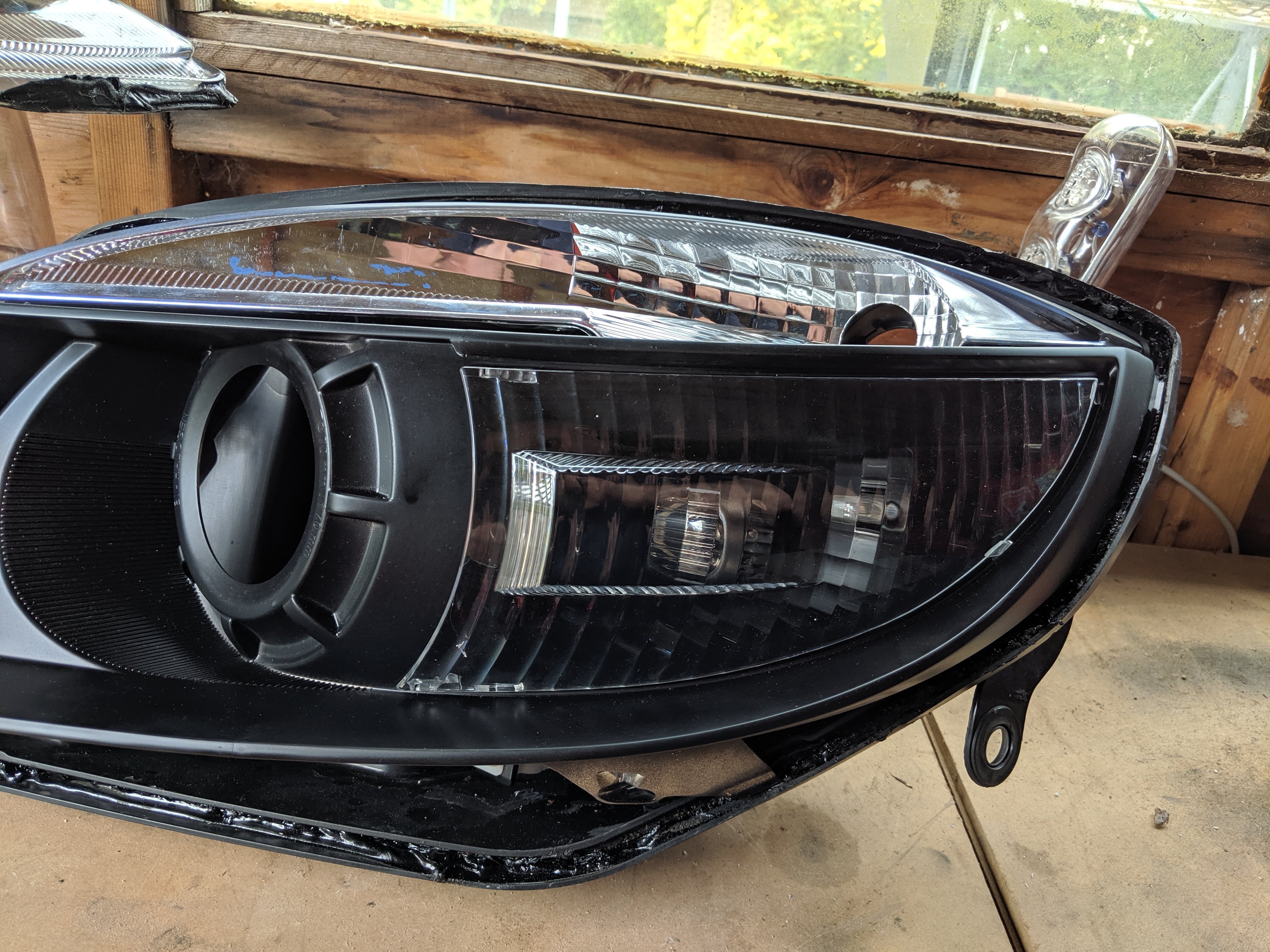

in the meantime I also got this.

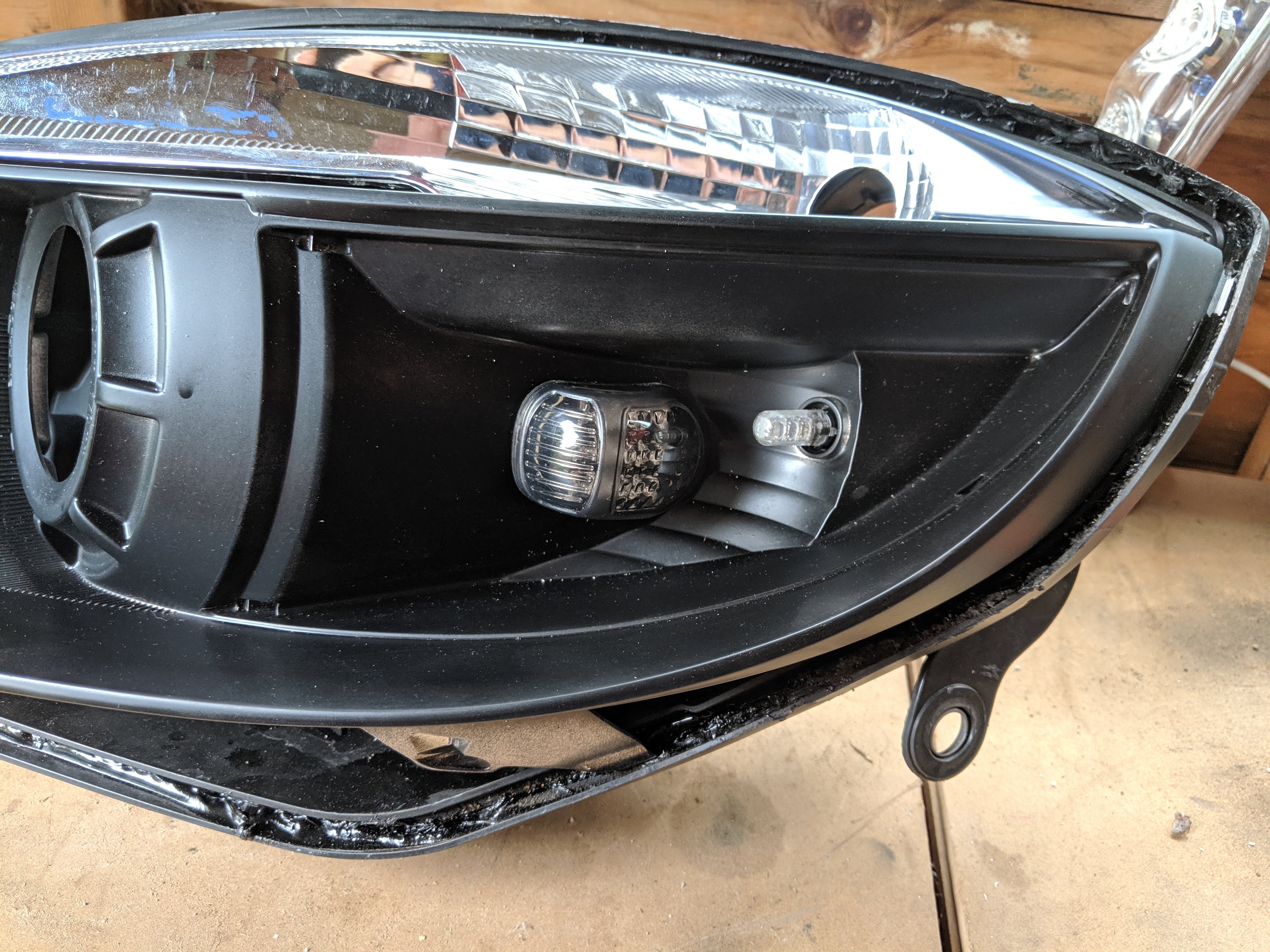

I've been inspired and started to get my headlights ready for the projector upgrade. I've added an additional led indicator in the side light reflector. Looks fairly stealth when the diffusion lens is back on 😎

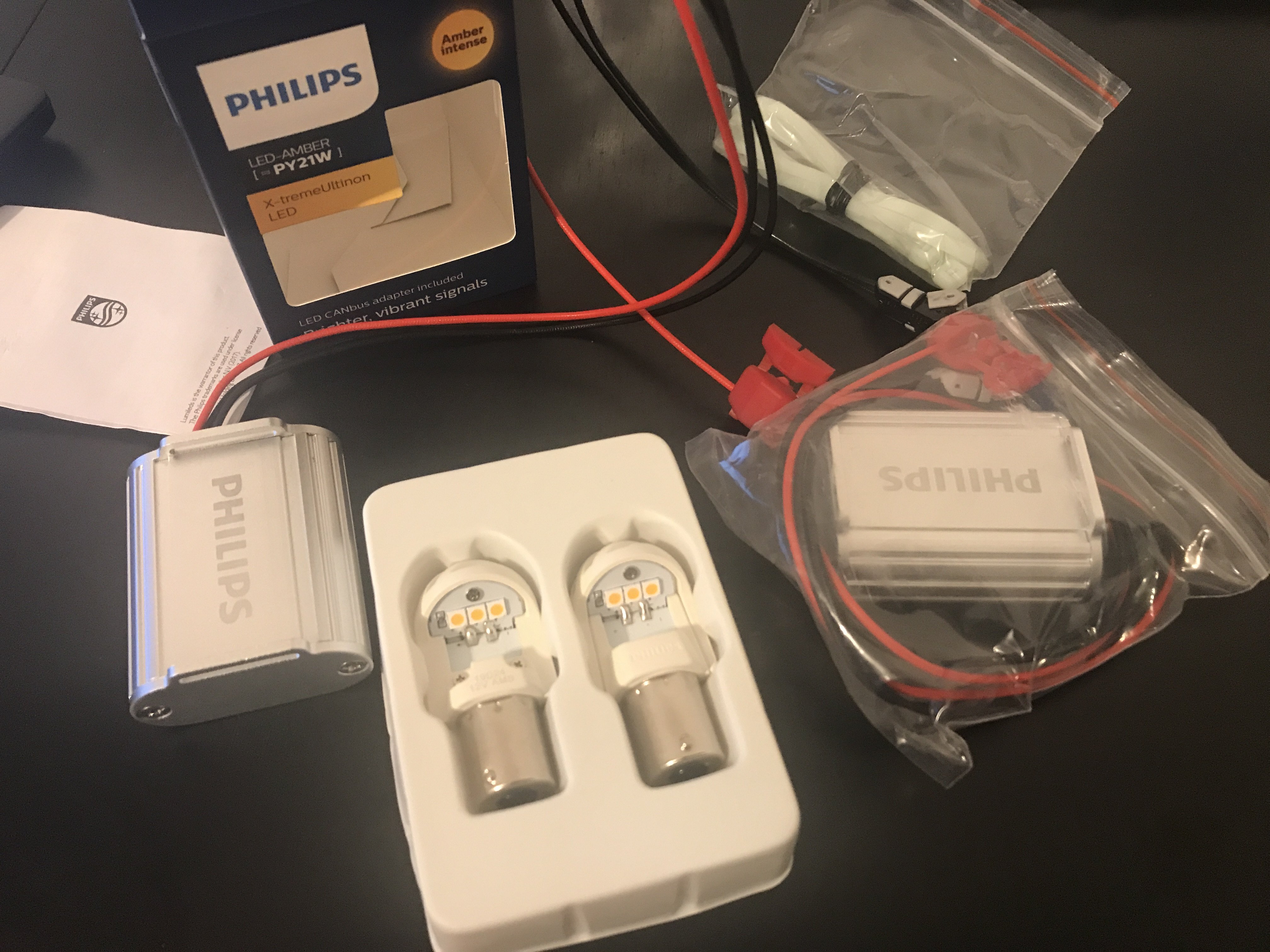

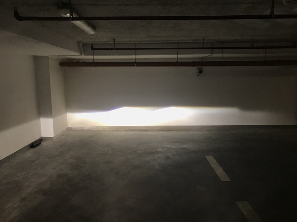

UPDATE: Don't buy Philips, it sucks. Just after 2 days, I got rid of the Ultinons and put some cheap 5000K xenon in that works like a charm. I had less light this with these stupid LEDs than with a small hand flashlight.
I had to modify the electrical wiring, add some + connection on the battery and add an extra relay. Default wiring is not compatible with H7 headlights, but not so hard anyway; I forgot to mention.
Got rid of the Ultinon signals also. They mess with the radio and dashboard for an unknown reason. It looks better with orange OEM bulbs after all.
