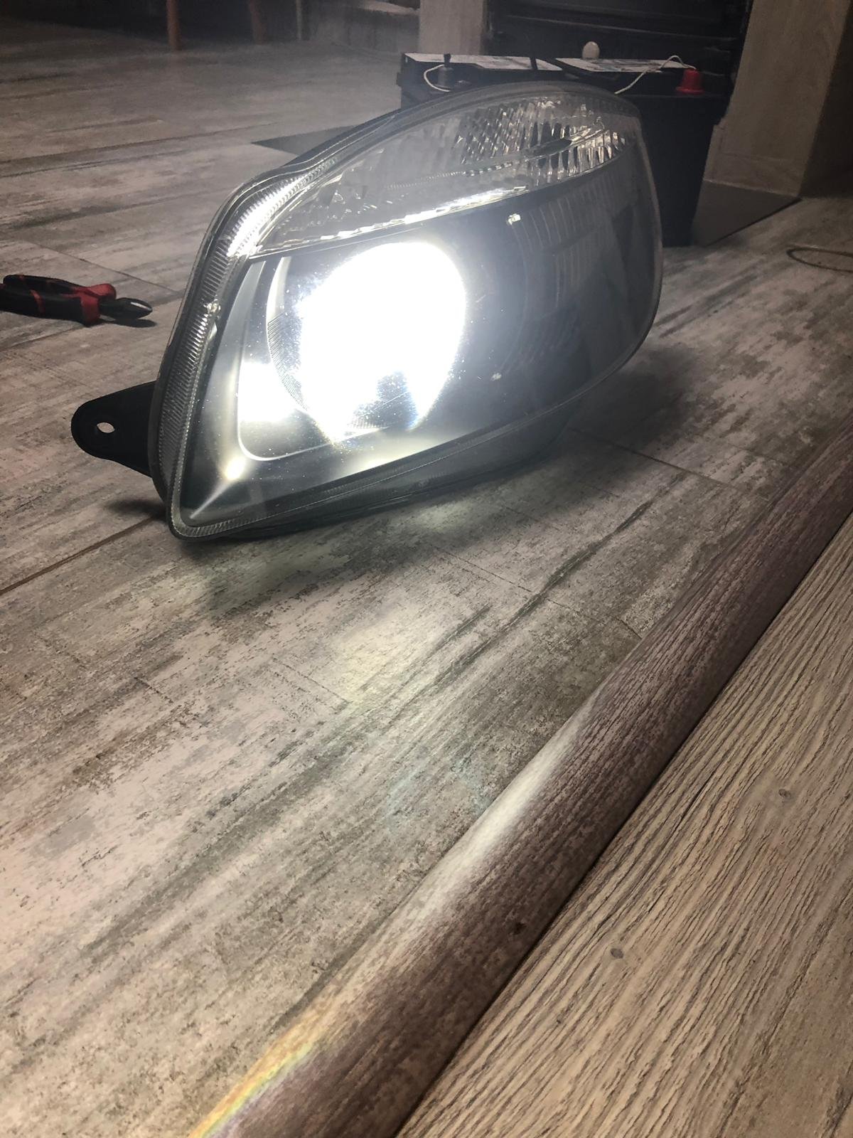

Greetings,

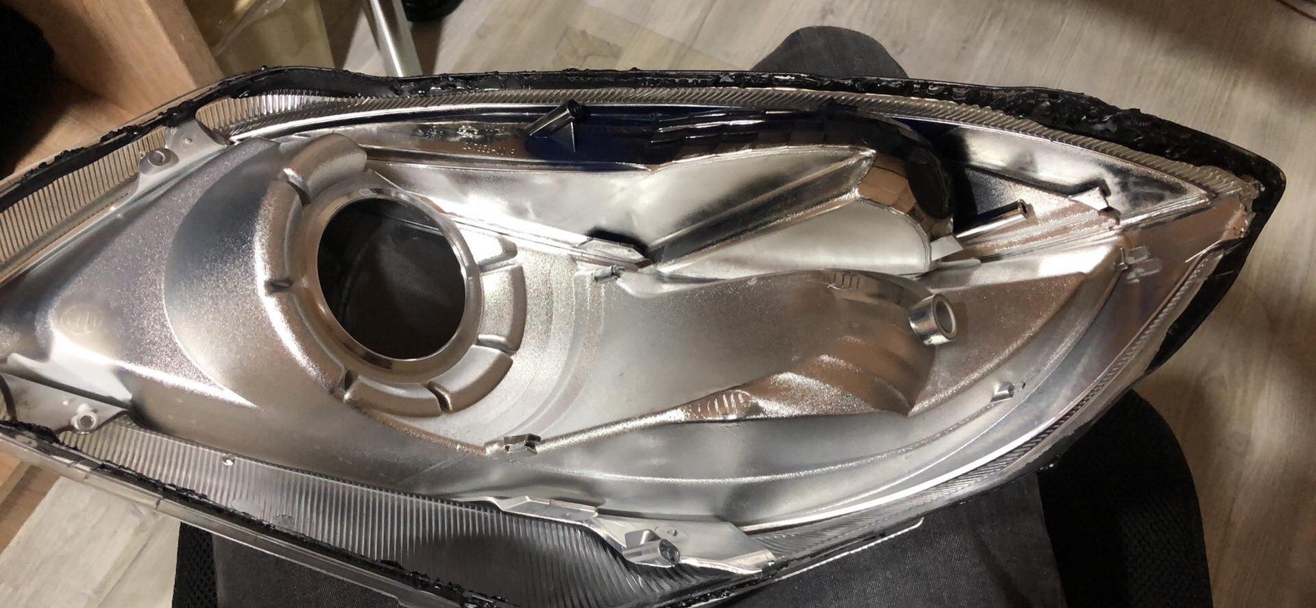

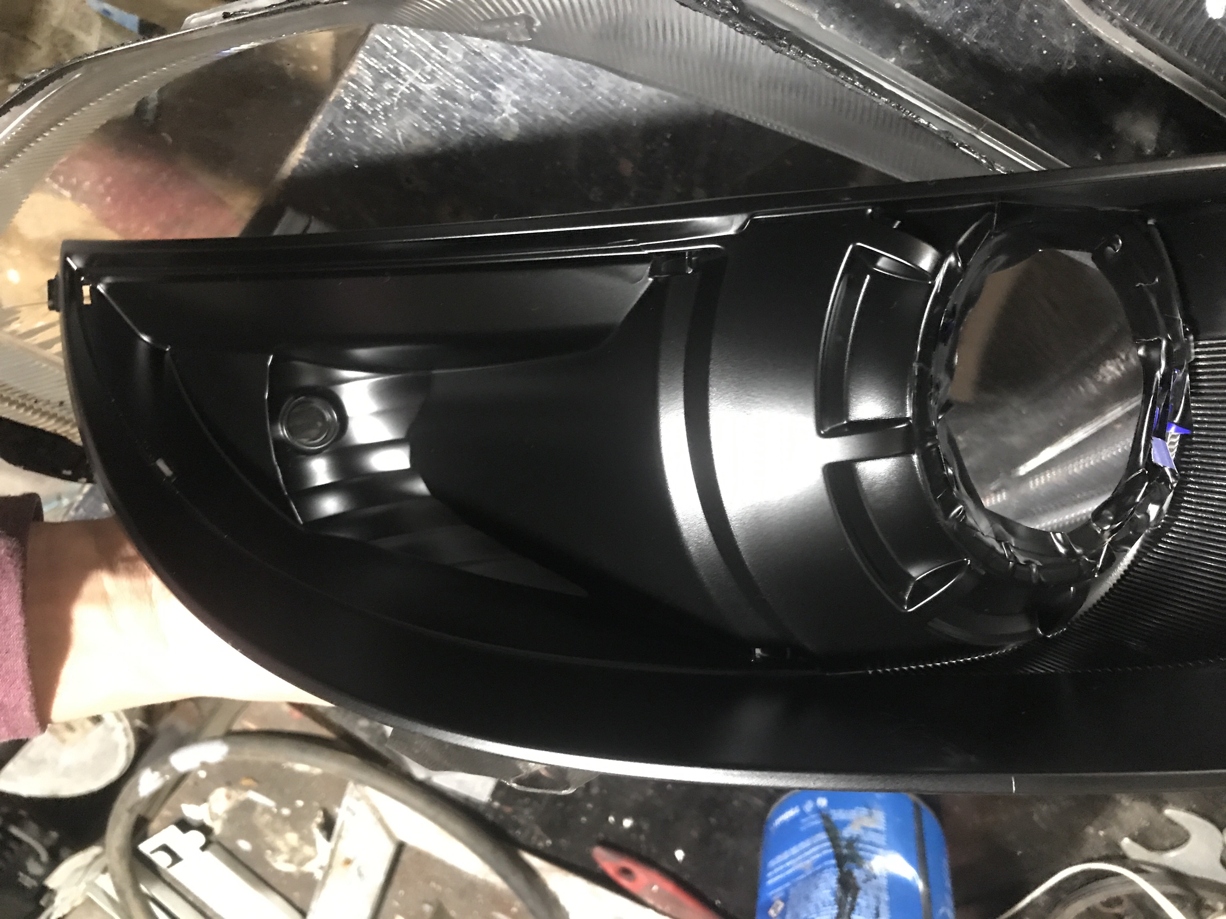

Inspired by Emanuel who has a nice Fabia, I have decided to buy some used HELLAs, open them and paint black as he did.
Unfortunately I have also painted the ring eye which I wanted to leave aluminium paint by mistake. So I brought some others.
Now the question: how can I paint the interior of the headlights without painting the eye ring also? Is there a special technique, a template to apply over it of some sort; anything?
Tank you in advance,
Albert
Masking tape?
26 minutes ago, Lyminton said:
Masking tape?
tried that; paint goes somehow under. :(
maybe i'm not doing it properly.
Tint the outside then use black silicone round the edges to stop it from peeling back
What we know as standard masking tape is not ideal for detailed fine lining as the paint "bleeds" underneath, its more for painting skirting boards in the house, you need a fine lining tape at the edge followed by masking tape behind it to cover the area....

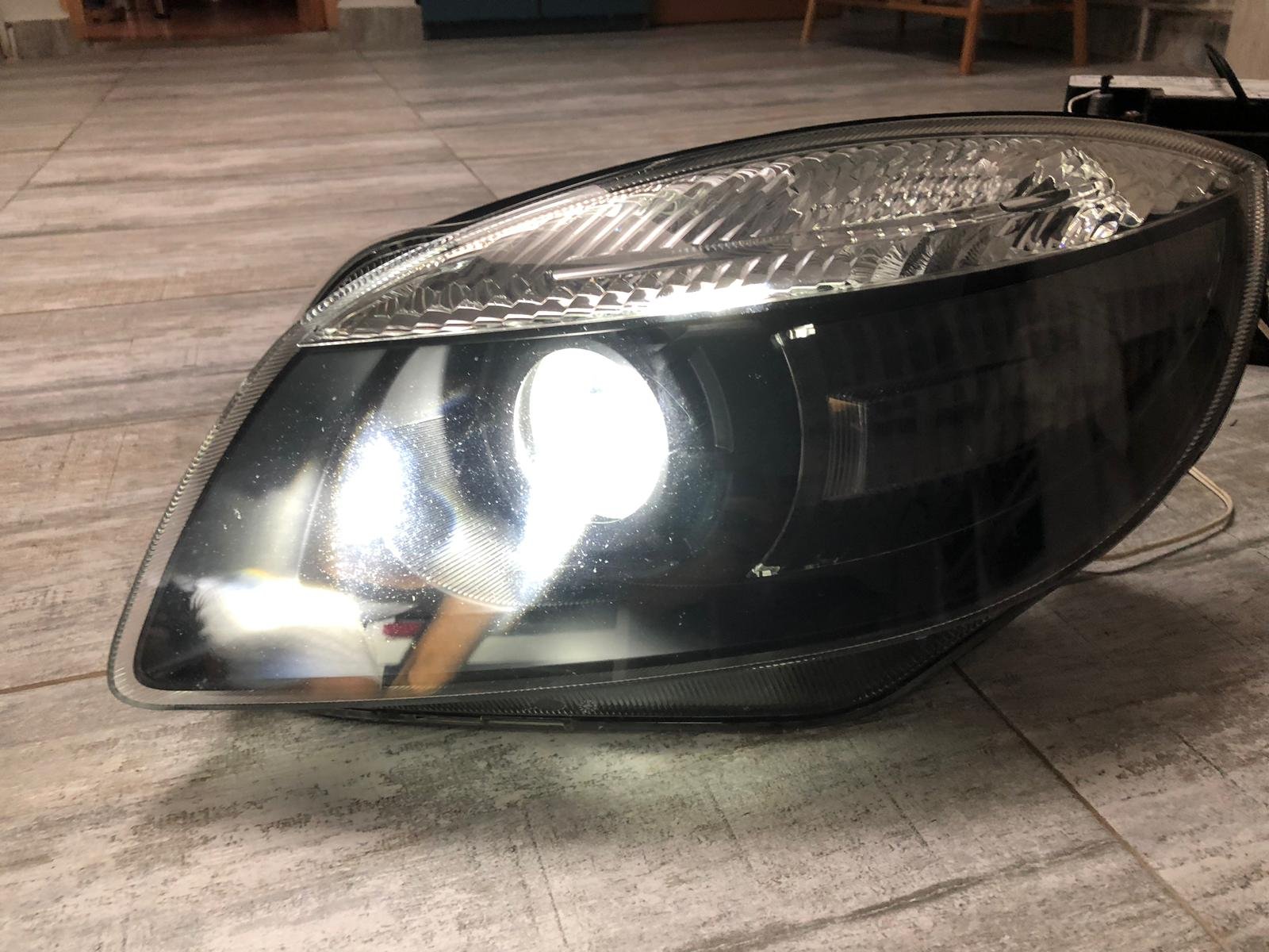

Thank you, UrbanPanzer for the tip!

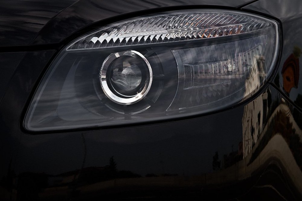

What exactly have you painted? I cant see a difference. I have a feeling your doing what i want to do. But just not had time to do it yet.

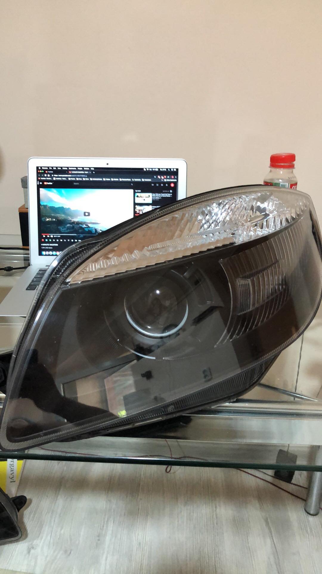

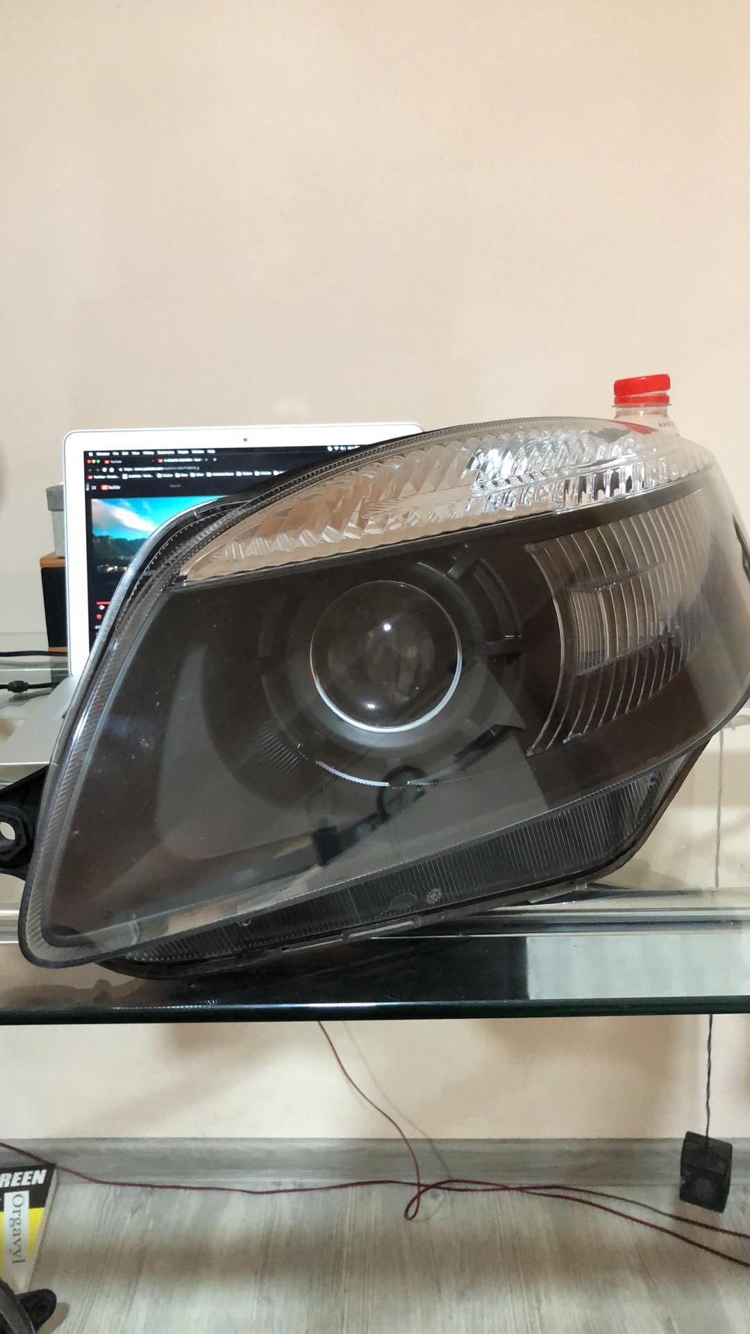

hes painted the reflector..........compare image 3 on post with last image....

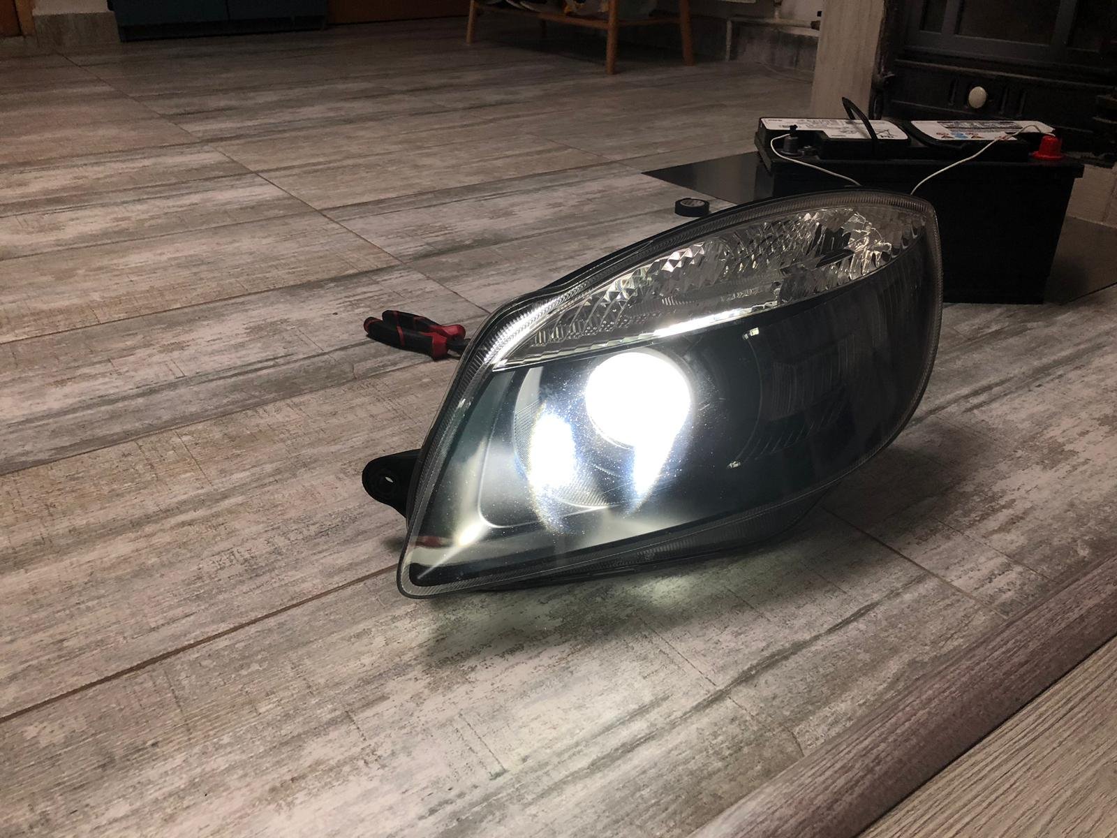

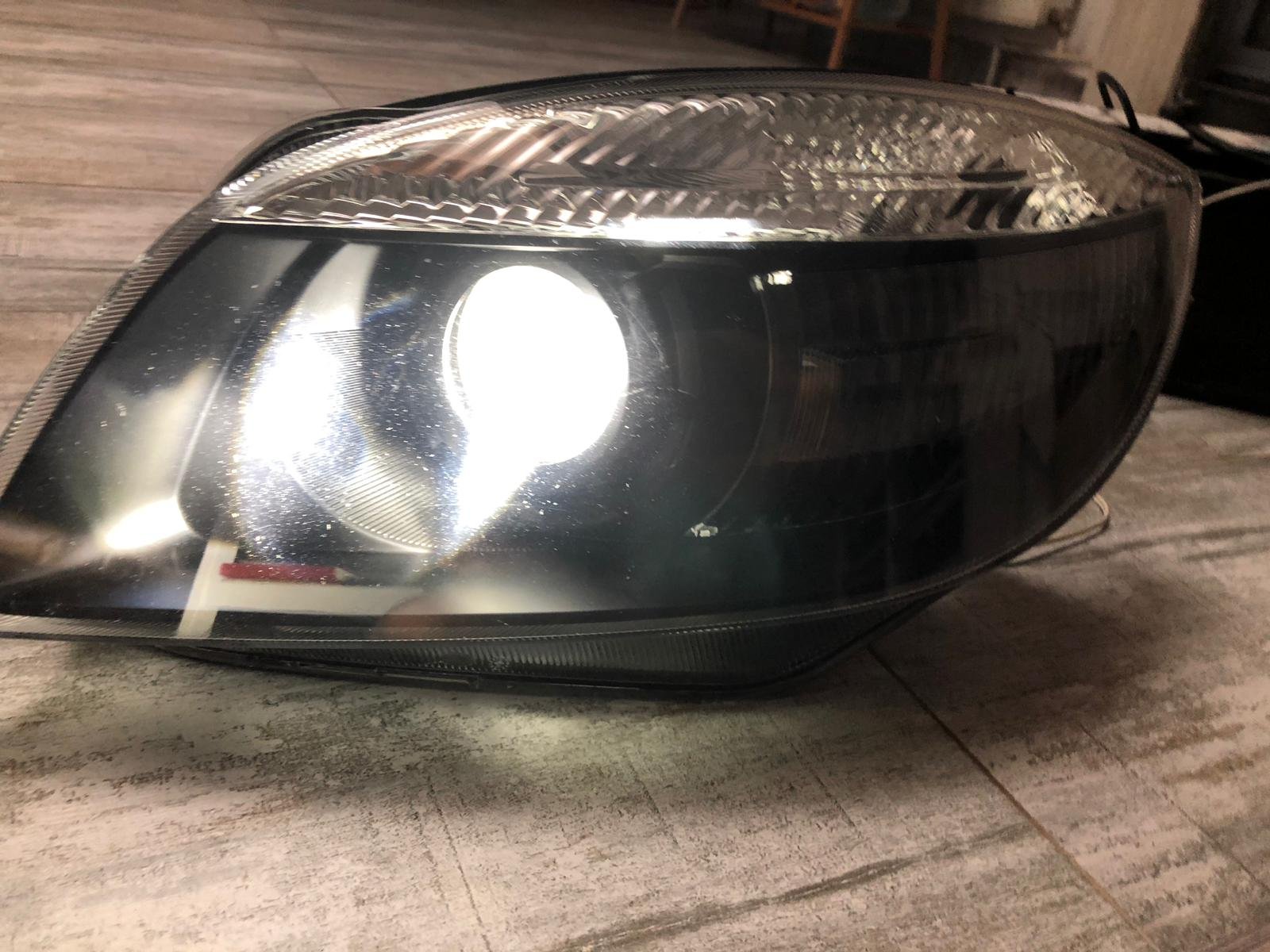

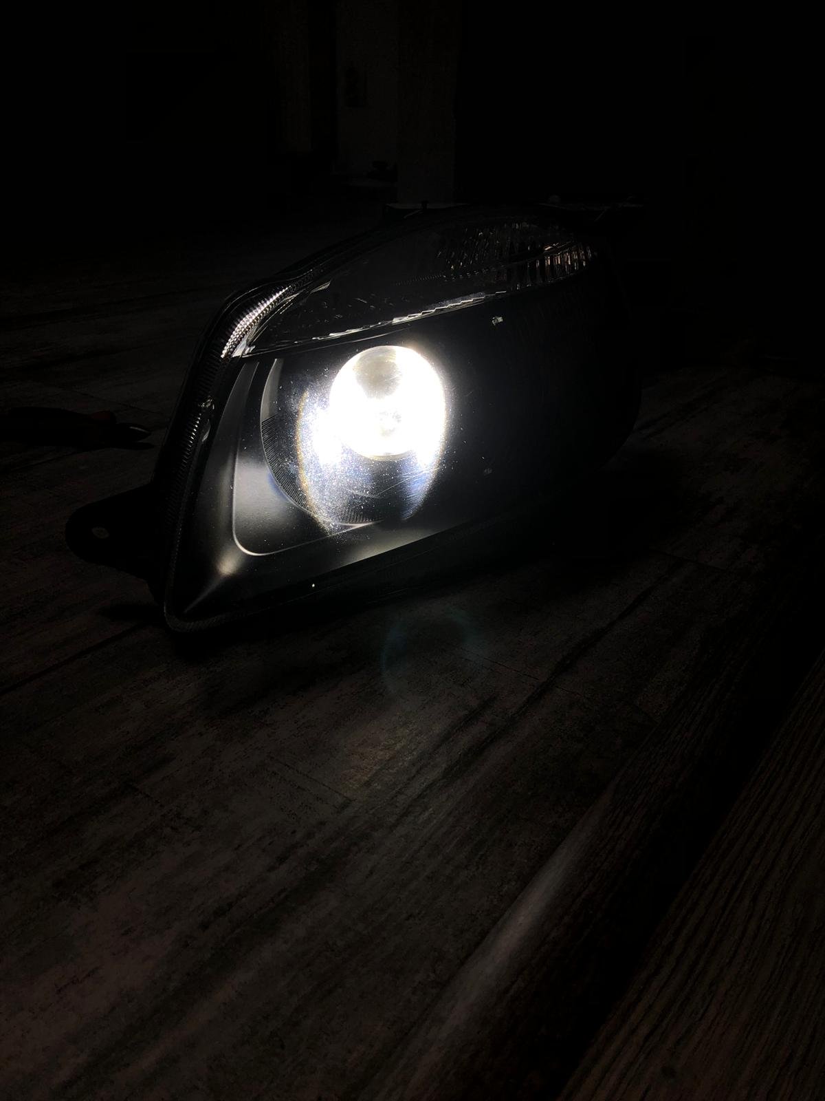

UPDATE: The LEDs work like a charm. No need for CANBUS for our headlights, no flickering. Long range beam/ flap also works well.
Though, I will insert a voltage and current regulator to dim the brightness. Pictures soon.

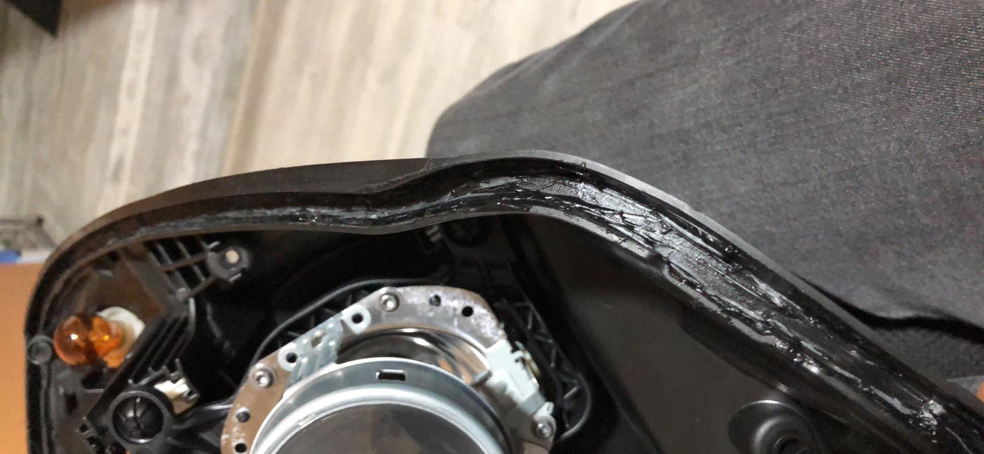

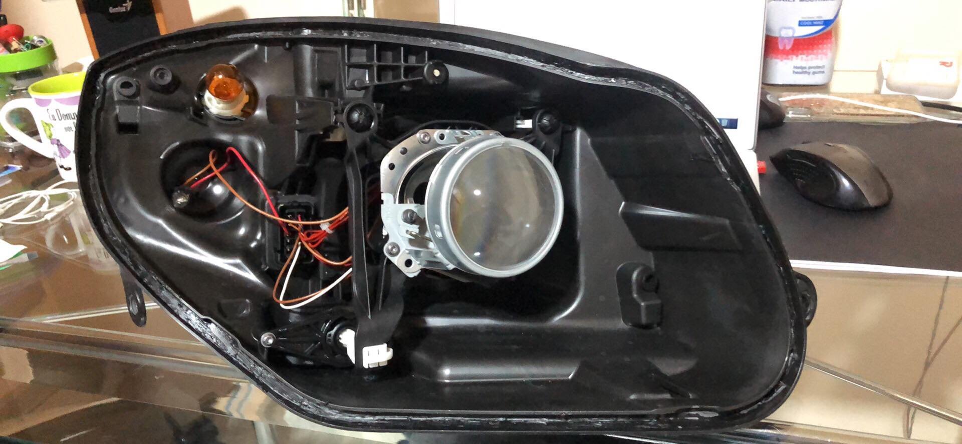

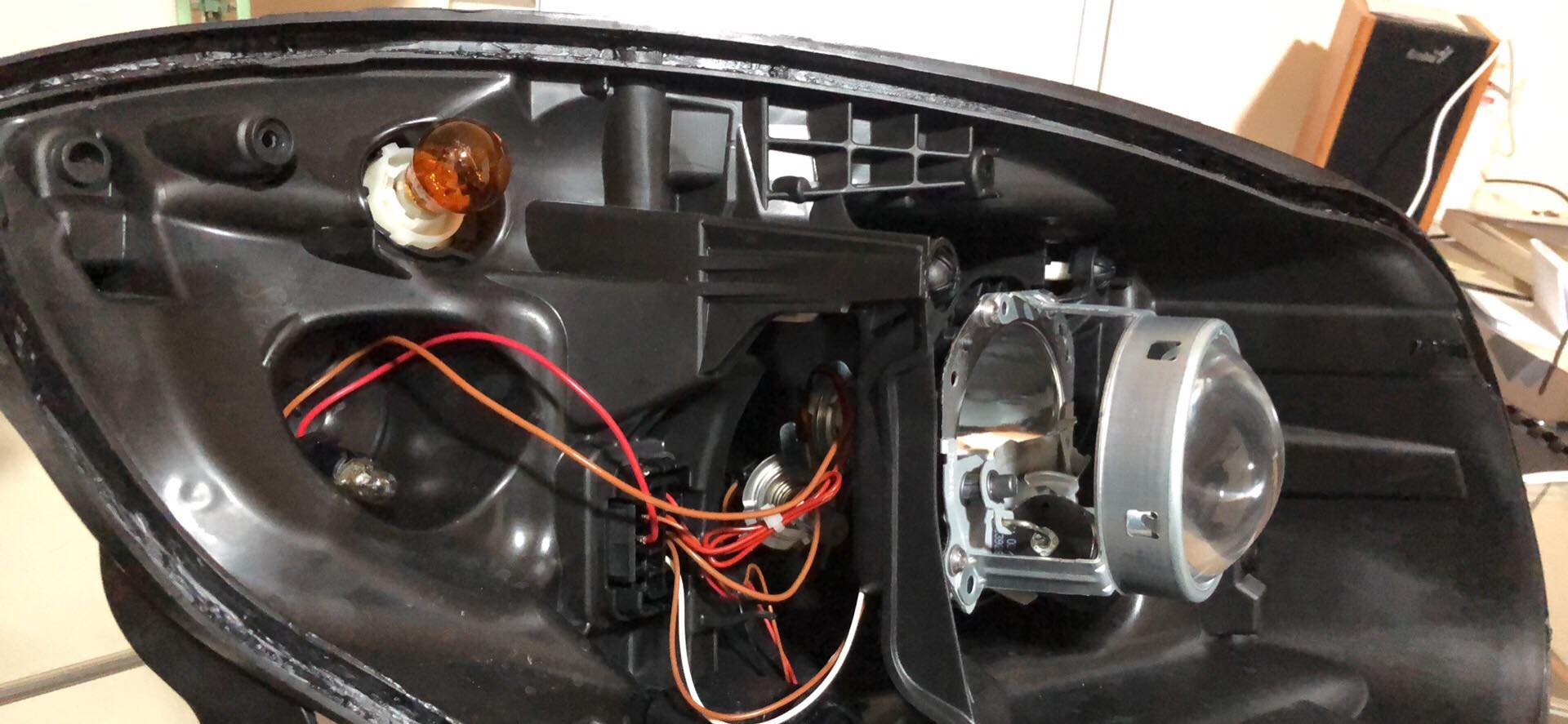

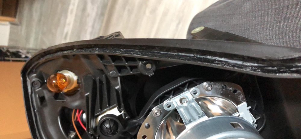

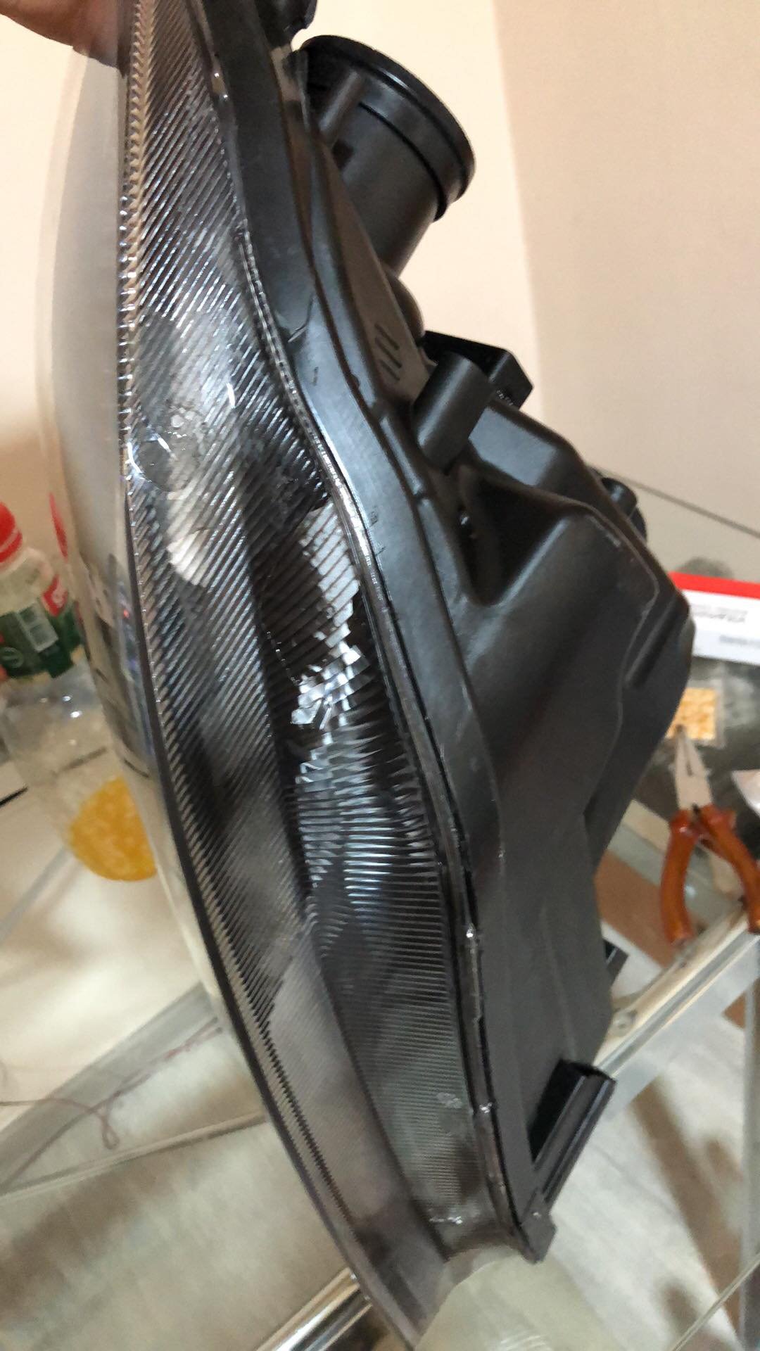

Do you have any tips for splitting the headlights? Did you put yours in the oven?
You don't need an oven for OEM Hella. The OEM mastic is soft, like a chewing-gum. I used... my hair drier.
The mastic I used[1] for the new enclosure had the same softness. After mastic insertion I just pressed the parts, tied them together with auto-straps[2]. Next day... I used my hair drier again, just to be sure, LOL.
I'll try to make a macro picture... you can't tell that it was opened, OEM like finish. I also put back the metal fuses through the mastic and the plastic enclosure.
I wanted (a must) the headlights to be as OEM as possbile, but rather black with LED.
[1]: https://www.emag.ro/adeziv-lipire-etansare-faruri-auto-xtremevisionr-455879/pd/DTL389BBM/
[2]: https://www.emag.ro/chinga-pentru-fixare-marfa-cu-clichet-carmax-25mm-x-5m-340kg-1-bucata-20753/pd/DKL85MBBM/

Have you got a shot of the beam pattern on a wall?
Did you have any staples in your headlight as mine looks sealed and pinned?
I did, and I've put them back afterwards.
