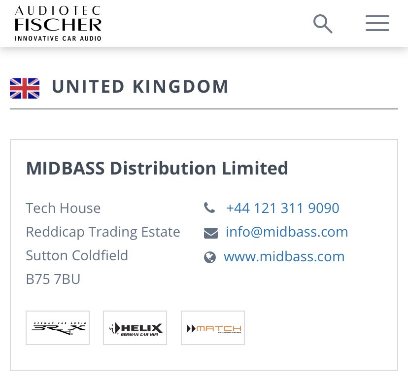

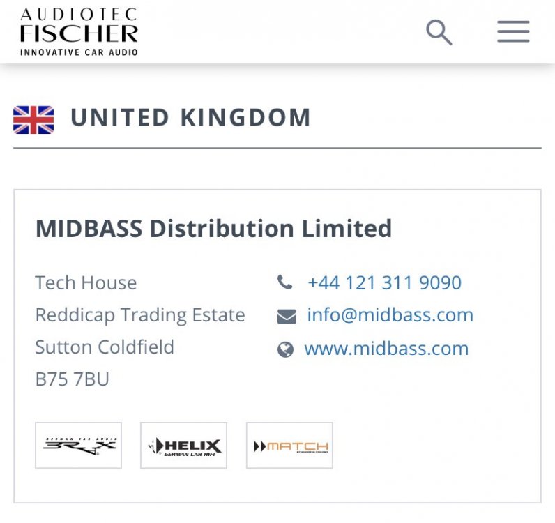

This is the contact details for the UK distribution of Fischer. Try giving them a call.
