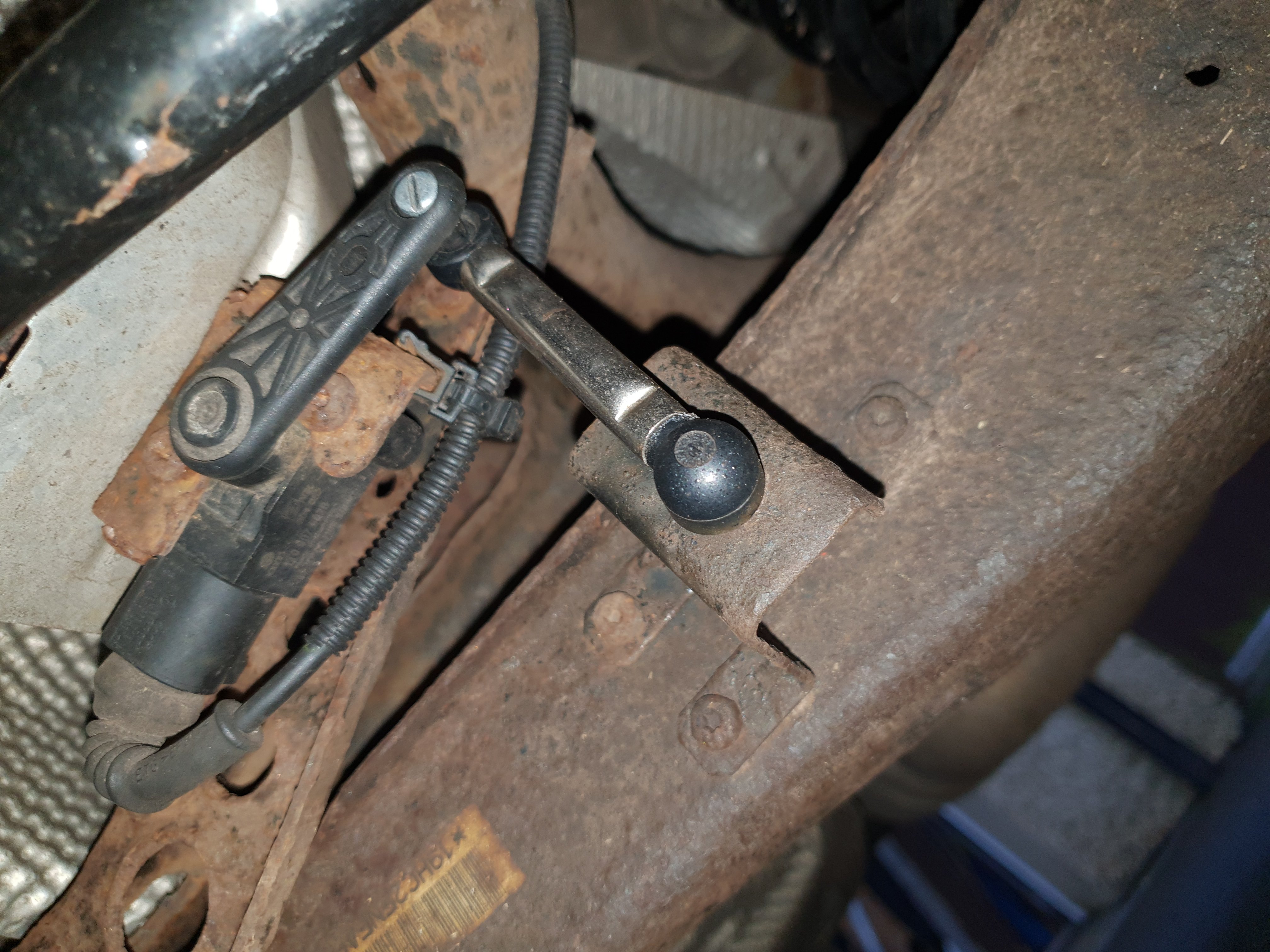

I have been under there just checked the rear sensor, there looks like a new screw has been put in at the end of the rod on the sensor, I suspect they didn't unscrew it before changing the spring and didn't notice before they unbolted the wheel arm, seems to be working ok though, I have a bit of weight in the boot to settle the springs a bit but lights still too low, seems like a reset of the range controller might resolve the issue,

Can you take a picture of the level sensor?

That sensor looks correctly orientated, sometimes they can flip the wrong way when suspension work has been done.
