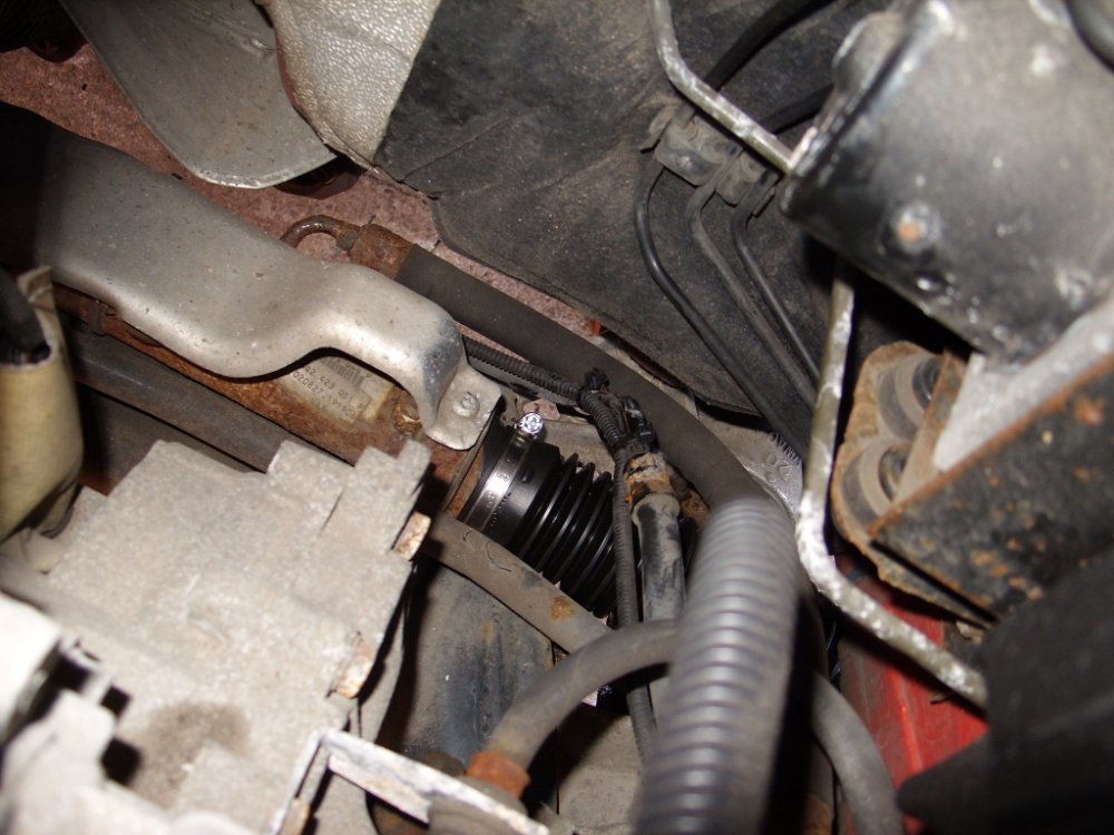

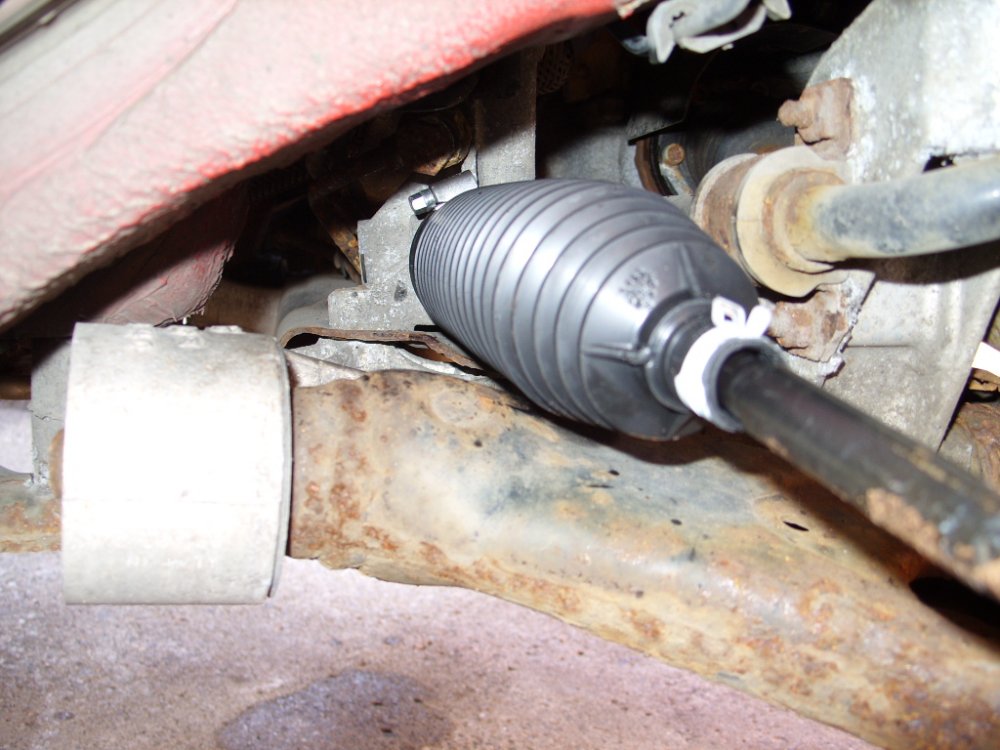

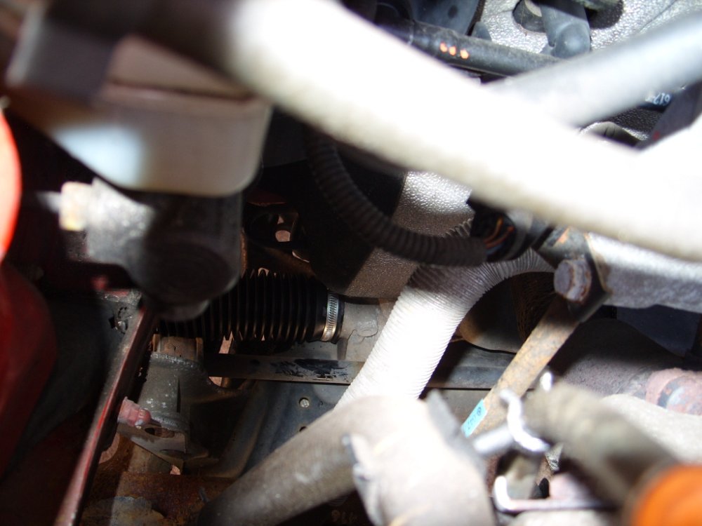

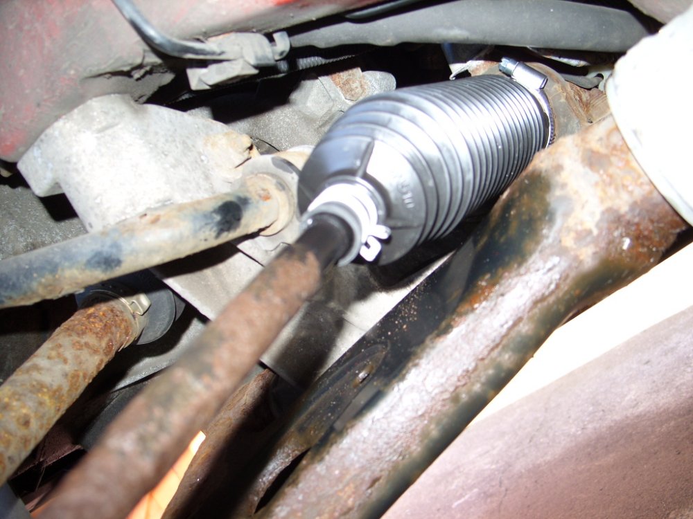

Did my steering rack boots back in July last year. It's very difficult to get the tool in to crimp the standard type inner clips due to lack of room, so I used stainless steel hose clips. I know some people would use cable ties but that's not acceptable to me, especially as the boots are made of quite stiff thermoplastic and could easily pull off if not secured properly.
