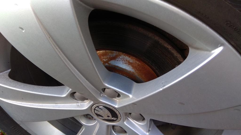

Rusty hubs no more!
Nice i need to do mine too! What did u use to spray them?
I will be doing mine once u change back to summer tyres when i take the wheels off!
Just used high temperature spray paint bought in Lidl. Hope it's not water soluble!
Haha shouldnt be lol

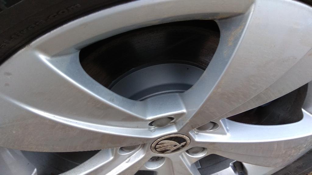

All that effort to cover the rusty hubs, yet your locking wheel nuts are exposed, and look to be corroding in front of my eyes :D
I noticed that though unlike the other nuts there is no plastic cover for it?

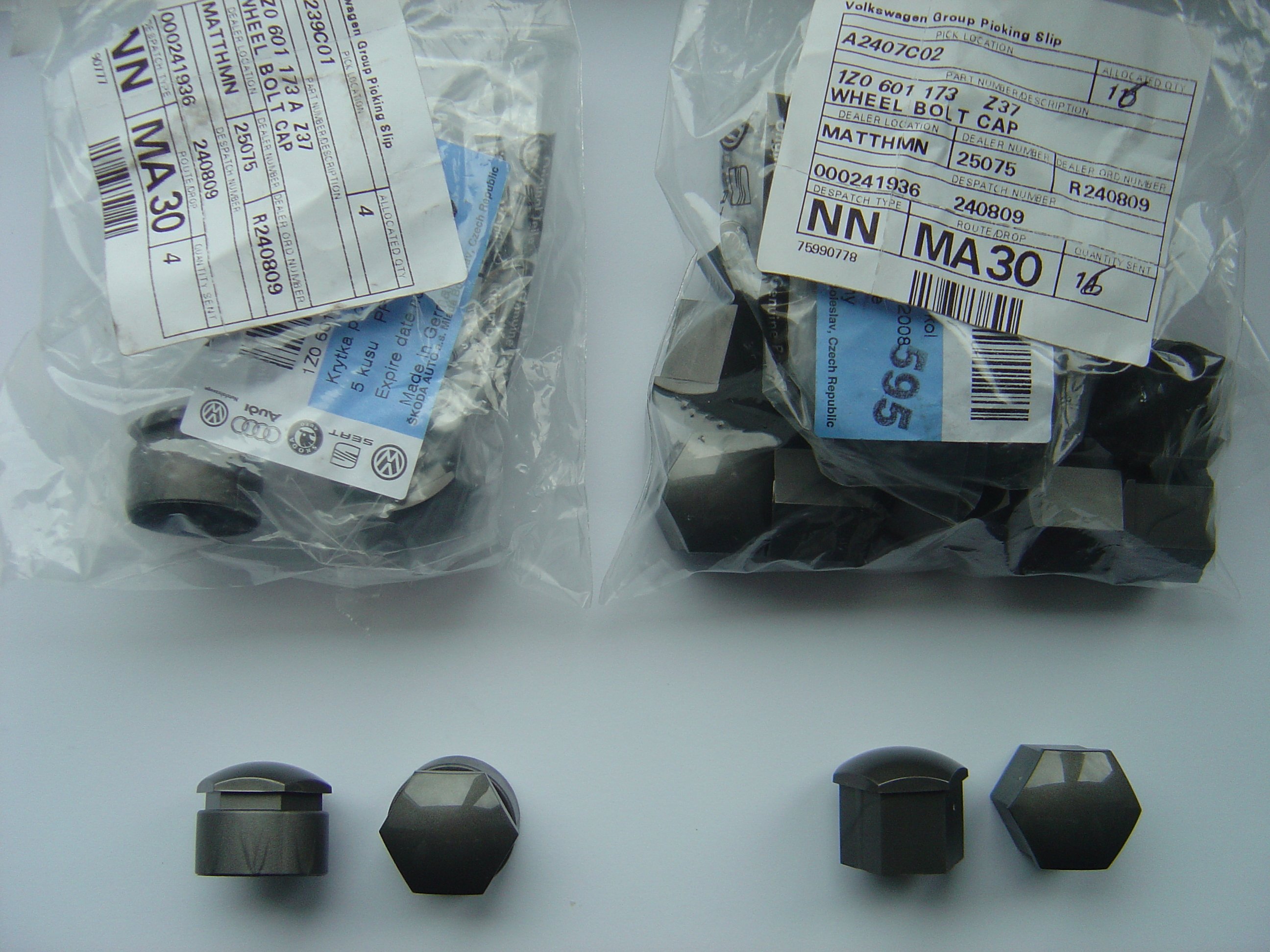

There is a slightly larger cap for the locking wheel nut (left one in the picture below), part numbers on the packing, but loads on eBay...
Don't be tempted by cheap chinese ones they are made of toffee and split the first time you try to fit them :(

Simple but gratifying fix for terrible looking hubs. Big wheel openings so nasty looking. Wheels off, sand off rust, clean, mask, spray.
I intend to do similar at some stage but will use cold zinc galvanizing spray, which is cheap, dead easy to apply, lasts longer than paint and is good to at least 400-500 deg C. (From past experience)
Noticed that not only is the locking nut cover missing but other covers are not fully pushed home, so could drop off. I guess this might be because the op has lost his plastic cover removal tool.
Edited by xman
I don't see the need for high temperature paint for normal road use, never had an issue with just using Hammerite. There is a lot of steel to heat up between applications of the brakes not to mention a big wheel acting as a heatsink.
@£5.99 a can or so it does the job in a few jifs, or sprays of the nozzle.

Yes look great. Just got my Superb and they have the same looking hubs. A definite job for me this.
