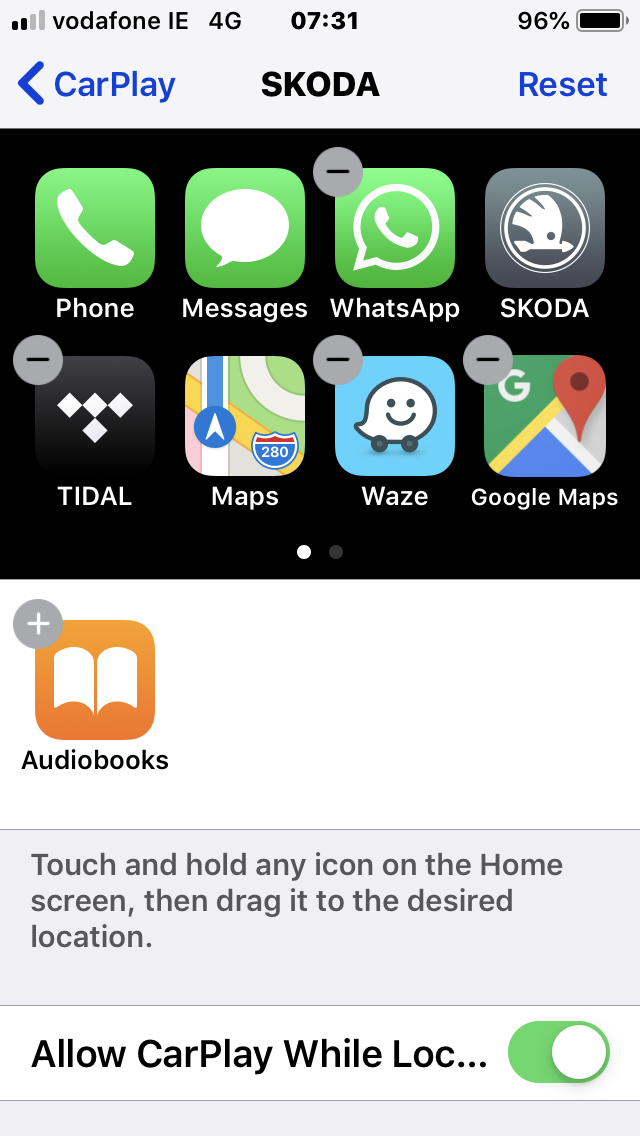

I think you need to add Google Maps to the CarPlay menu of your phone:
If Google Maps is down where Audiobooks is then it won't be shown in CarPlay until you drag it to the screen.
Hope that helps,
Nick
