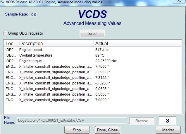

After reading on http://skoda-fabia-israel.blogspot.com/search/label/engine where he instruct in checking intake adaptation values (these values are adapted due to timind differences between crank and camshaft), and they should give you a pretty good idea if you chain is elongated. Is the adaption values high, the chain is too long, and the engine therefore have to compensate a lot. if you scroll down a bit on the link, you can see some examples of the values from engines with a lot of chain-noise, and from engines where the chain just have been replaced. My own adaption values is par with the ones of a just changed chain, and my chain has droven 120.000 km. So im thinking something like, maybe im lucky that my chain is just happy, and by changing it, i could induce new troubles, and the next chain only will hold up for like 40.000 km.
Here is my values from the ECU X_intake_camshaft_signaledge.......
