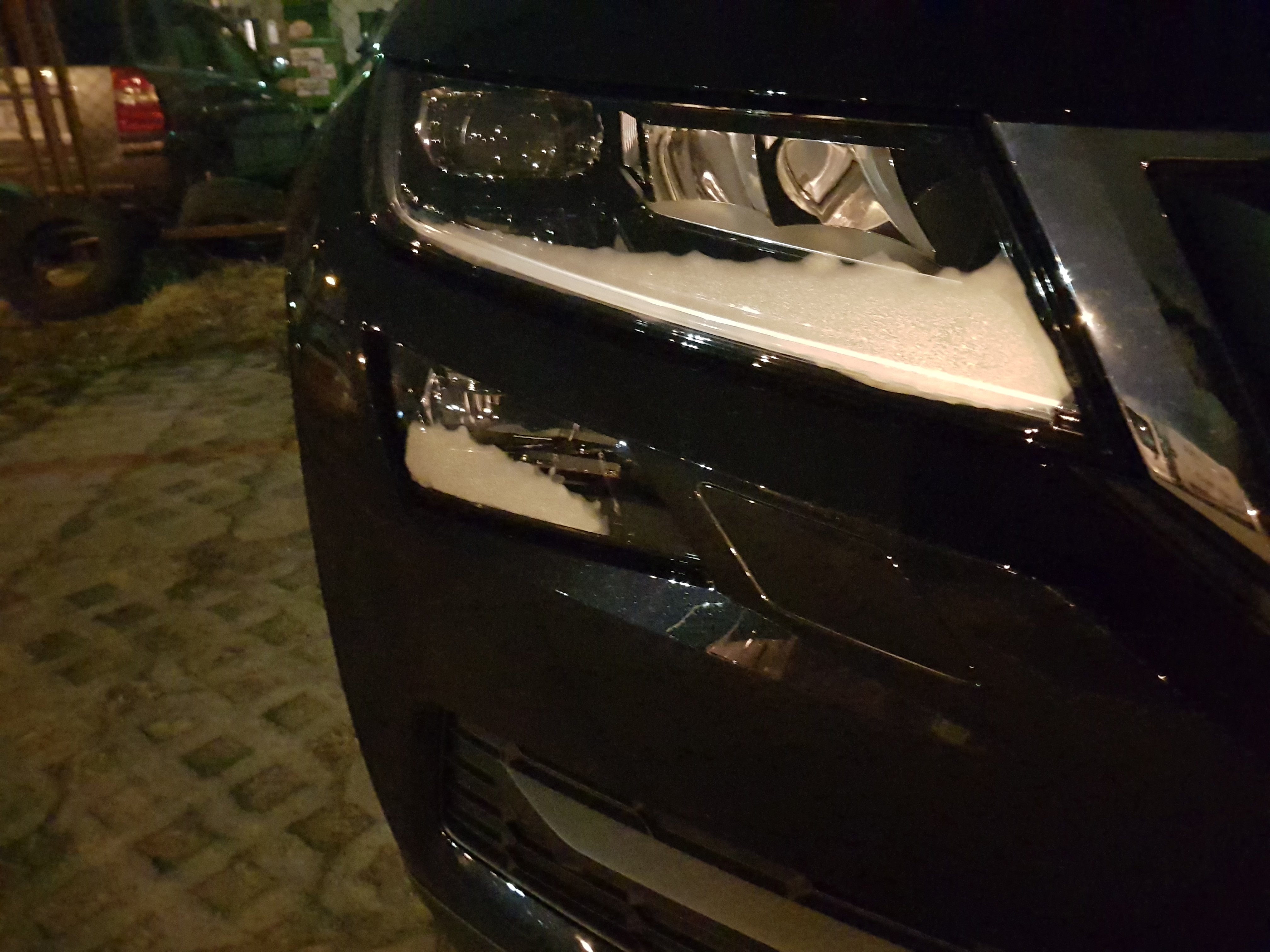

I had this problem as well - both headlights & foglights. I emailed few pictures to my dealer - and they asked me to visit service for replacement on guarantee. Next day I had new lights. To be honest I was supprised how fast they solved this problem. But nearest time will verify if they succeesed.
They confirmed that 90% of cars with LED have this problem .... :worried:

why does this problem affect LED lamps more than halogens ?
Much lower temps so doesn’t burn off the moisture.
I agree with as Techle. Lower temps, maybe bad (or not good enough) construction of ventilation - that all.
