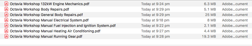

These are the PDFs I've managed to find this evening but no wiring or circuit diagrams :-(
