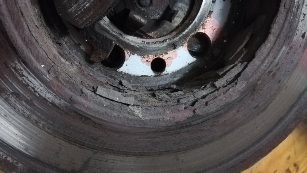

Brembo discs will not do you any good. I rather use original ATE. 110 tsi has biger brakes originaly, look at that option with bigger original calipers.
See picture for my argument against brembo. ATE brakes never came apart like these have in last 10 years of my driving the VW cars.
