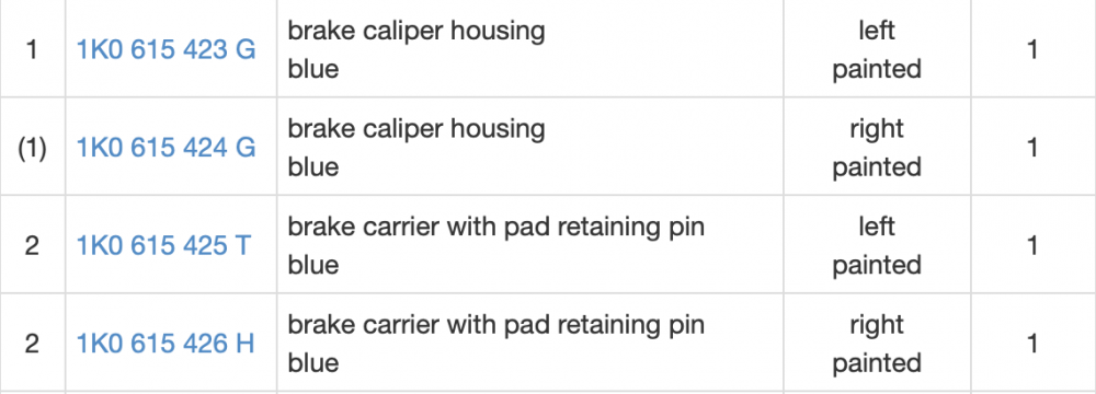

  • As far as I can see the mk6 Golf R had mech handbrake too. It was not electric until the MQB cars so should fit. Mk5 R32 certainly does, although remember the Golf R was 4x4 there will be differences
