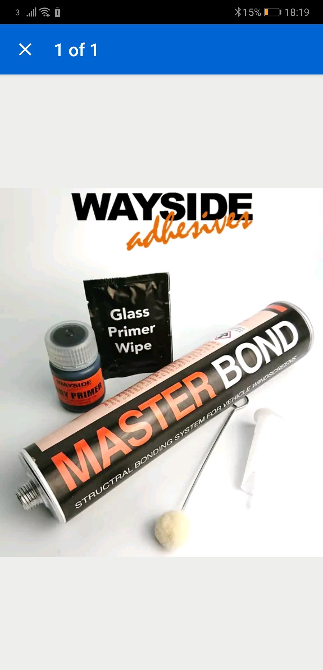

OK, what glue do you use, how do you clean the frame, how long does the glue need to cure for?
It's window bond mate they sell in on ebay. It's like a thick black silicone sealer. The old bond scrapes off. We have glass fitters come to our work to do all the vans.
