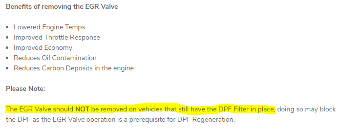

Regarding EGR & DPF interaction, I have always understood that the EGR is disabled during a regen.
This seems to make sense as EGR is there to reduce combustion temperature, wheras during a regen exhaust temperature has to be raised considerably to start the DPF burning.
So I wouldn't have thought deleting the EGR would affect the function of the DPF unless someone knows different.
Every day is a school day as they say.
EGR can have an effect on soot generation, thereby affecting soot buildup in the DPF, though I would expect less EGR to reduce soot loading since there's more fresh air entering the engine allowing more complete combustion (all other things being equal).
EGR's job is to dilute the inlet air so that there's less oxygen in it without affecting the volume of air present as a NOx mitigation measure. For combustion to initiate there needs to be a certain distribution of oxygen and fuel vapour in the cylinder and this is dependent on the gas volume present. Reducing the amount of excess oxygen means there's less of it present to react with atmospheric nitrogen and therefore less NOx emissions.
The problem with an EGR delete tune on modern engines, is that EGR functionality is tightly integrated into the rest of the engine's operation and it's difficult to disentangle it cleanly from the rest of the ECU code, which stores up problems for the future.
1 hour ago, silver1011 said:
I don't think they understand it very well. EGR is always fully closed (I.e. no recirculation) during regen. The extra oxygen and NOx are used to oxidise the soot.
