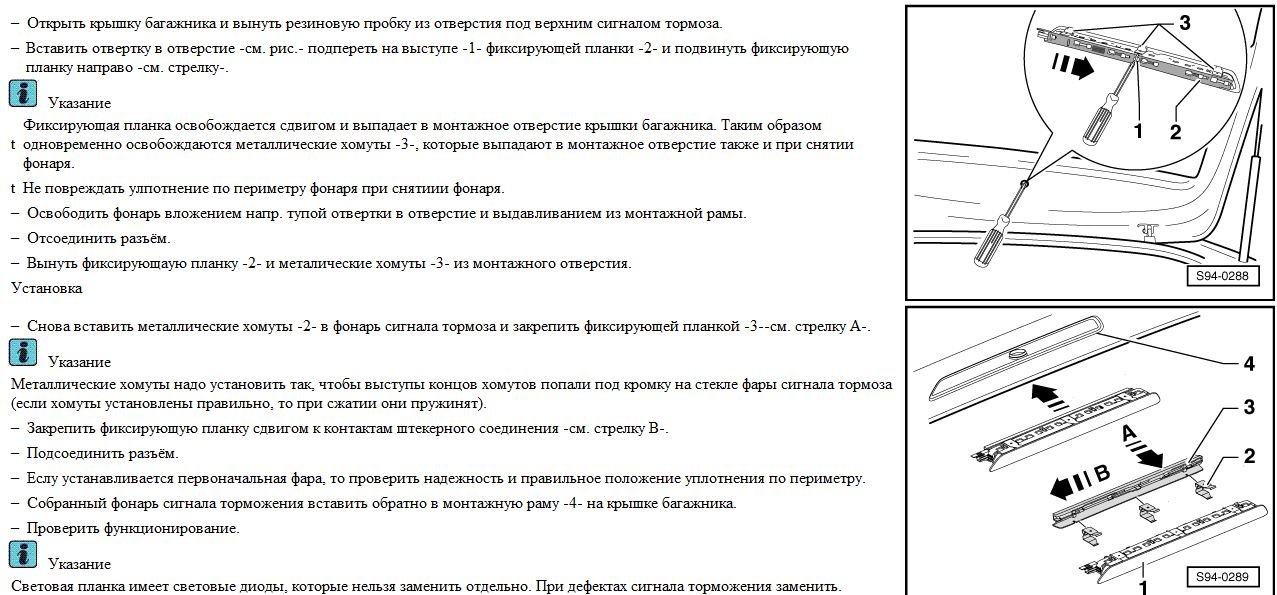

Found this instruction for Combi/Estate, but on Russian :(
You can see at there is no easy access, only one hole ca 0,5cm in diameter ...
I have try to "feel" the place with the screwdriver from the picture, but without success. It's very hard to do it on "blind".
