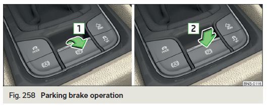

If the parameters for the auto-release of the electronic parking brake are not met (i.e. door open, seat belt unfastened etc.), you usually get a warning on the dash when attempting to set-off (expecting it to automatically release).
Make sure the drivers door is closed, your seatbelt is on, and that you haven't deactivated the auto-release (by pulling up and holding the button up), the button only requires a quick pull. If you have inadvertently deactivated the auto-release by holding the button up for too long, you'll need to manually turn off the electronic parking brake by pushing the button down, or you'll be trying to drive off with the brake still engaged...
