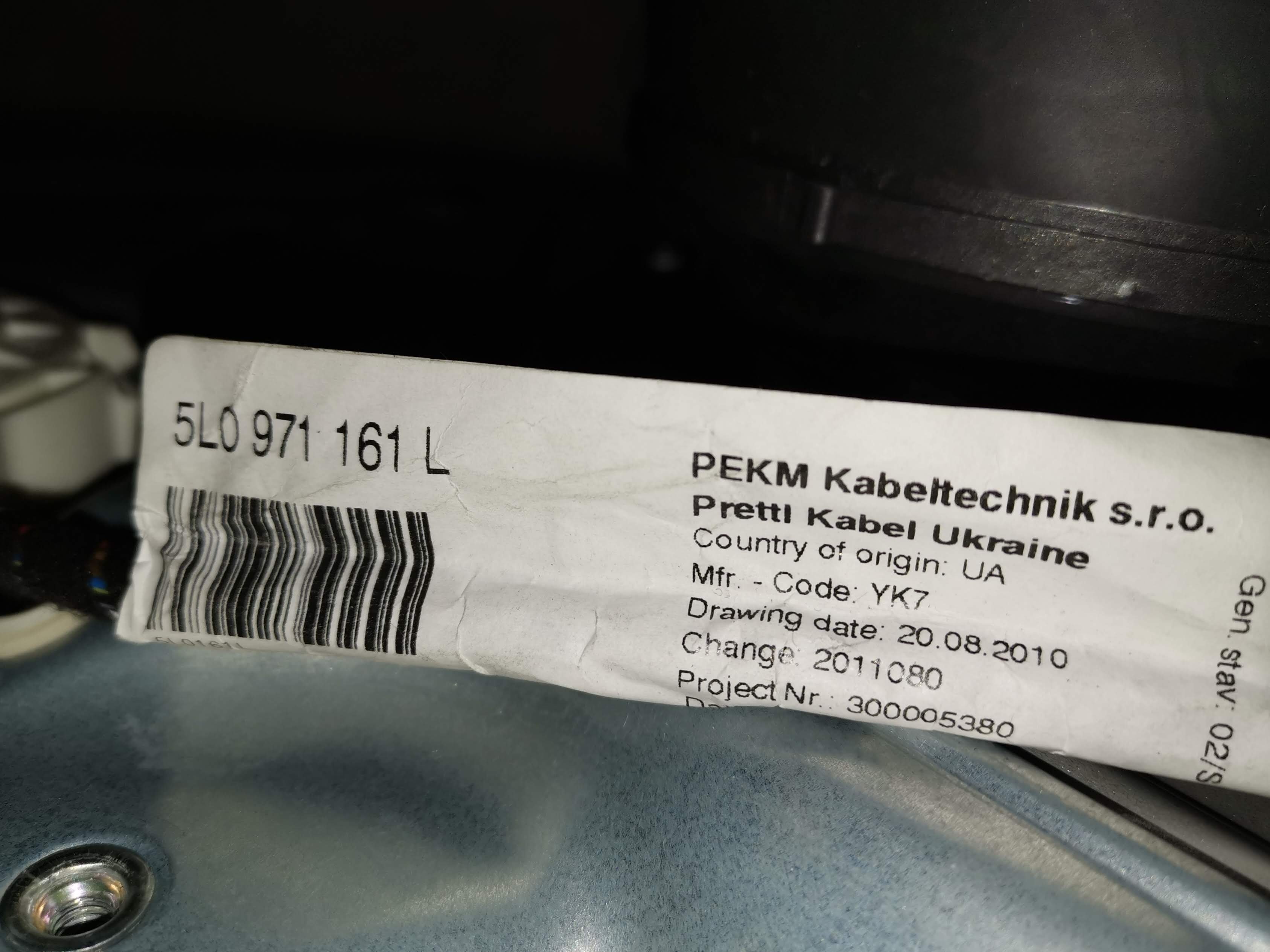

Hmmm..   My feeling was this too.  I couldn't really see properly inside the rubber part as I was unable to disconnect the plug at the main body part (how does that connecter come apart?).    I took a photo of the sticker attached to the loom so I could get a quote on the part.   www.skoda-parts.com came up with the reference number and quoted 61,47€ plus 15€ delivery - not an excessive price in the car parts world.
If I can find out how that connector comes apart I'll have to take the gamble I guess.

The connector must be designed to come apart easily, so whilst I don't know myself, it should be obvious when you look at the replacement part.
Hopefully the replacement will have the longer loop between the doors so it won't fail again, so may well have a newer part number.
If one has gone the others will be failing soon, particualry the drivers door, so once you know how to fit, it may be a good idea to think about changing them as well? Seems a lot cheaper in France than uk though.
