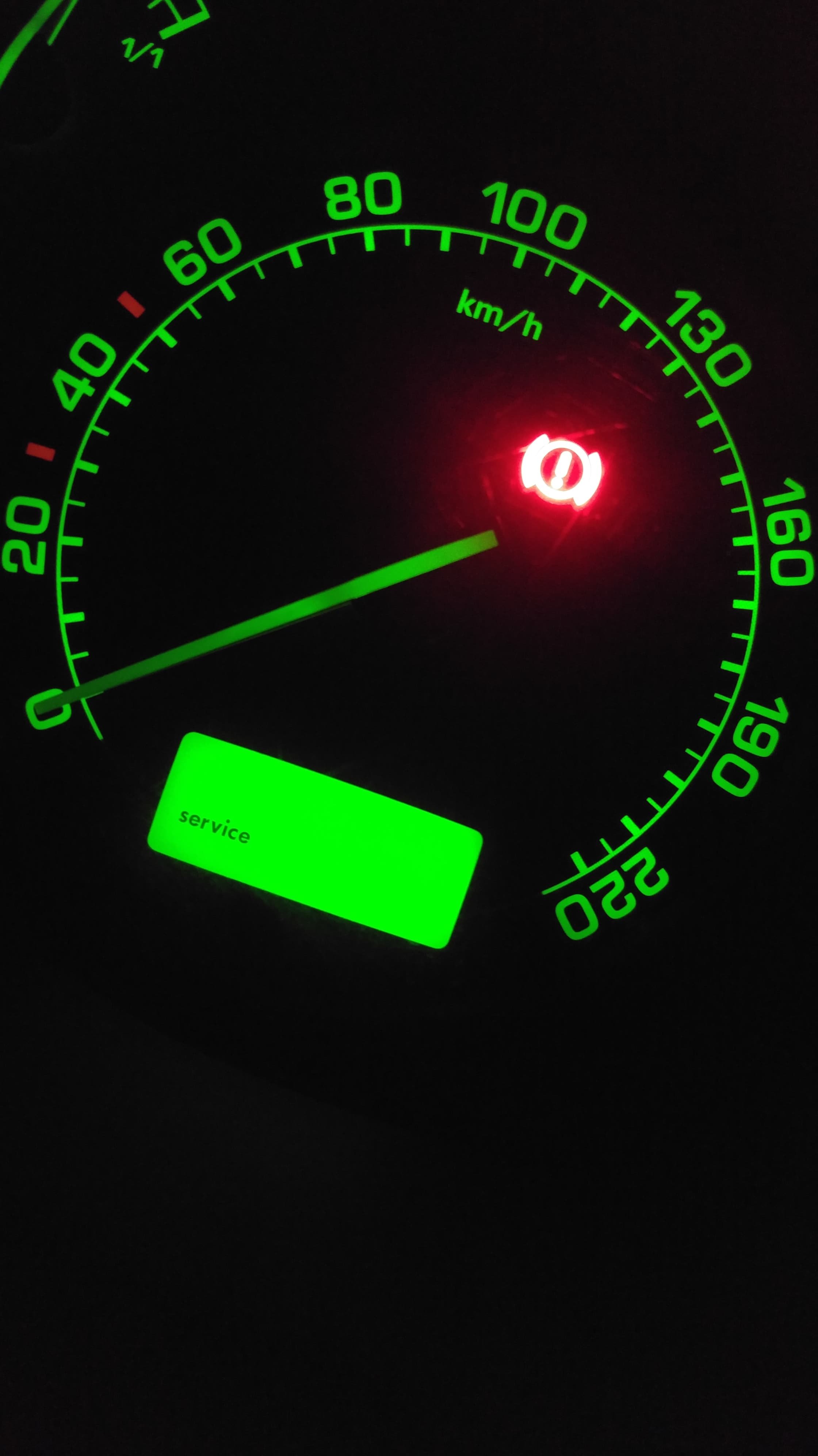

Hello, I have a problem, today I reset my trip kilometers, when I turned my car off everything was fine, after 20 minutes I started my car the service singe appeared (like in photo). After several minutes driving it disappears. Maybe someone knows what does this mean?
That looks like the brake warning, which would suggest either your handbrake isn't fully off or your brake pads are wearing thin.
My hand brake was on, thats why the light was on, i'm talking about service in the box where the kilometers should be displayed.
Oops, my bad  I just saw the warning light and reacted :(
The service alert comes on at startup when the car thinks it's due for a service. You should establish what sort of service plan it is set for - fixed mileage/period or variable mileage based on oil condition amongst other things - and then (at least) plan for an oil change with the appropriate oil.
I changes my oil 2000 km ago. And reseted my service. Maybe I will have to reset it again.
I don't know what would cause your service light to come on again; hopefully someone will jump in and enlighten us :)
When you serviced it 2000km ago, was it due, ie light on?
If it was set (vcds) to annual, and you did it early without the service light being on, it may now think its due on its annual setting even though youve done it?
Worth getting it plugged in and checked..
Everything is fine now. The button for reseting trip kilometers was sat down to the end, I pulled it out, ant the service is gone now. Thanks for help :)
