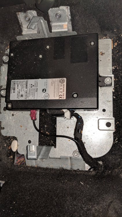

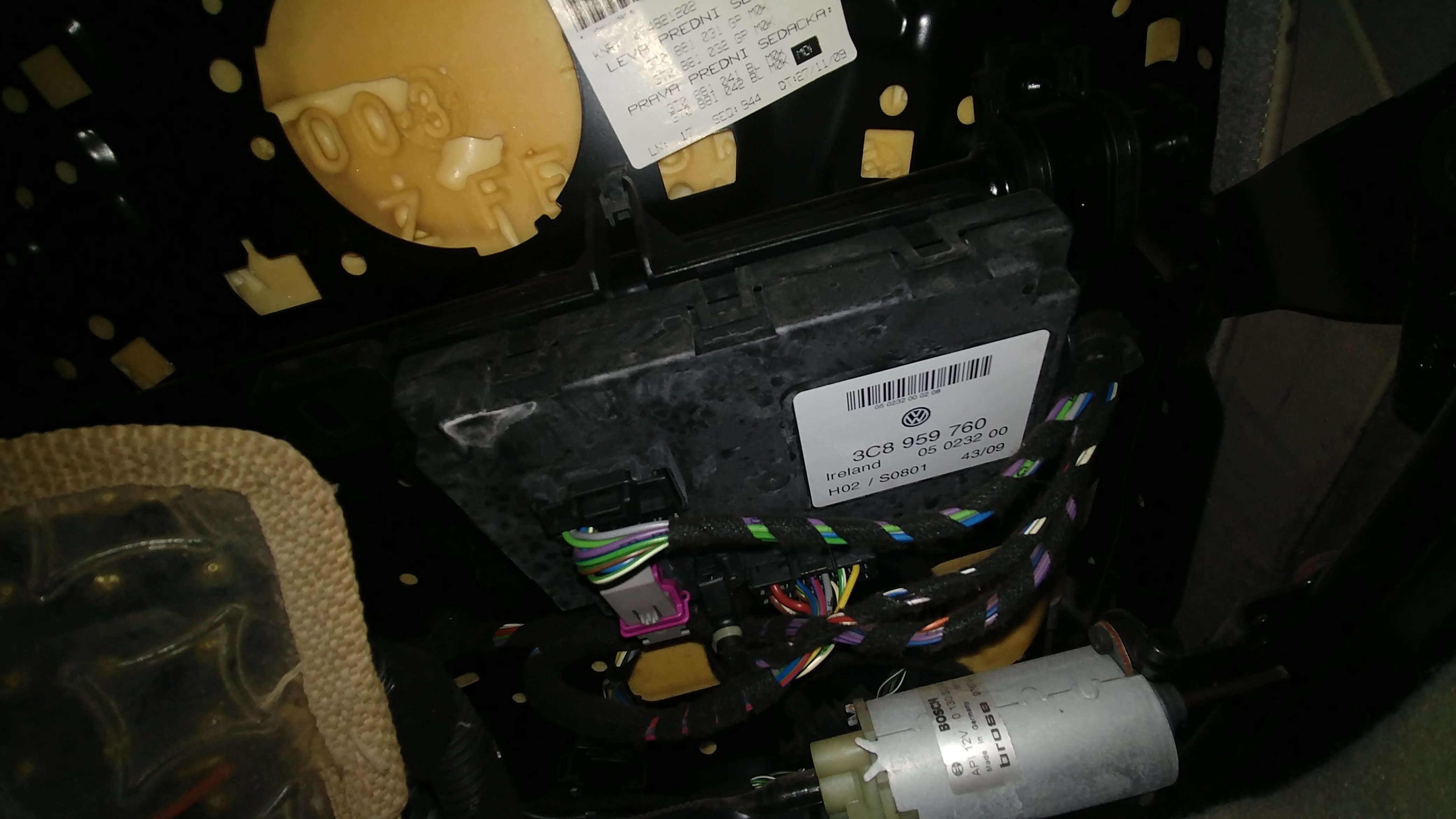

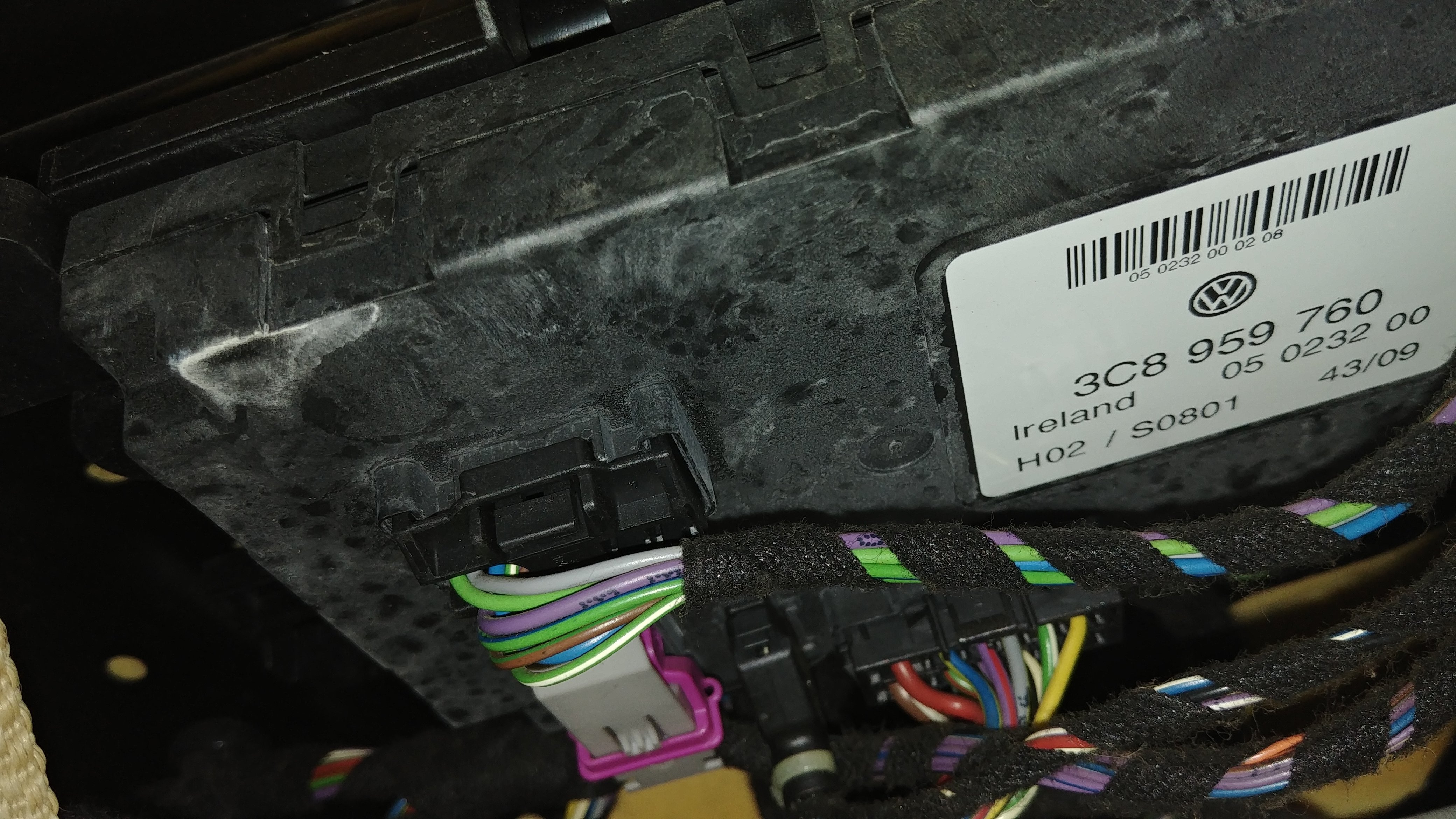

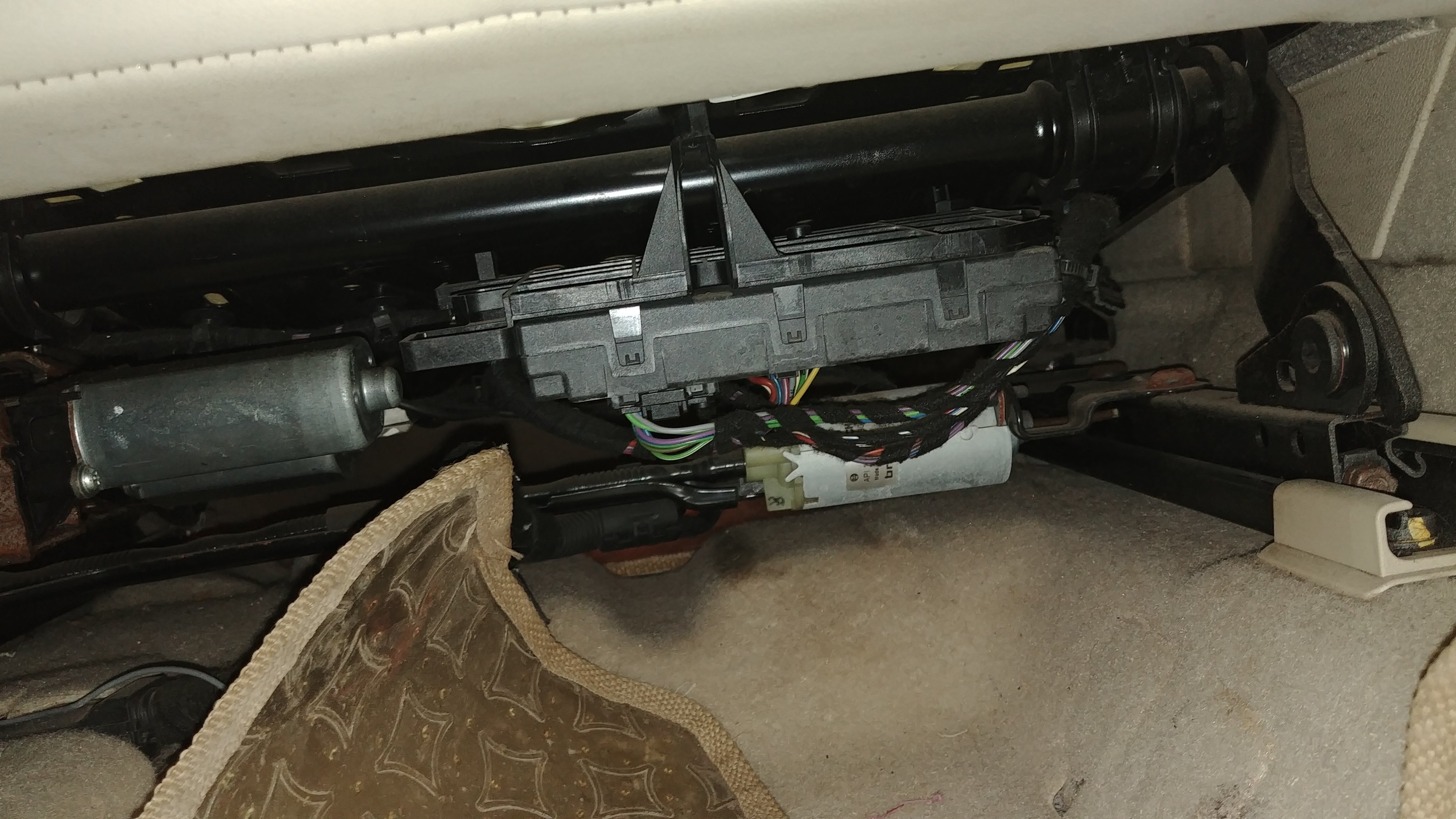

Hey, so I just managed to click some pics of the box/module underneath the seat. Please have a look and thanks for your inputs
Thats the seat control module

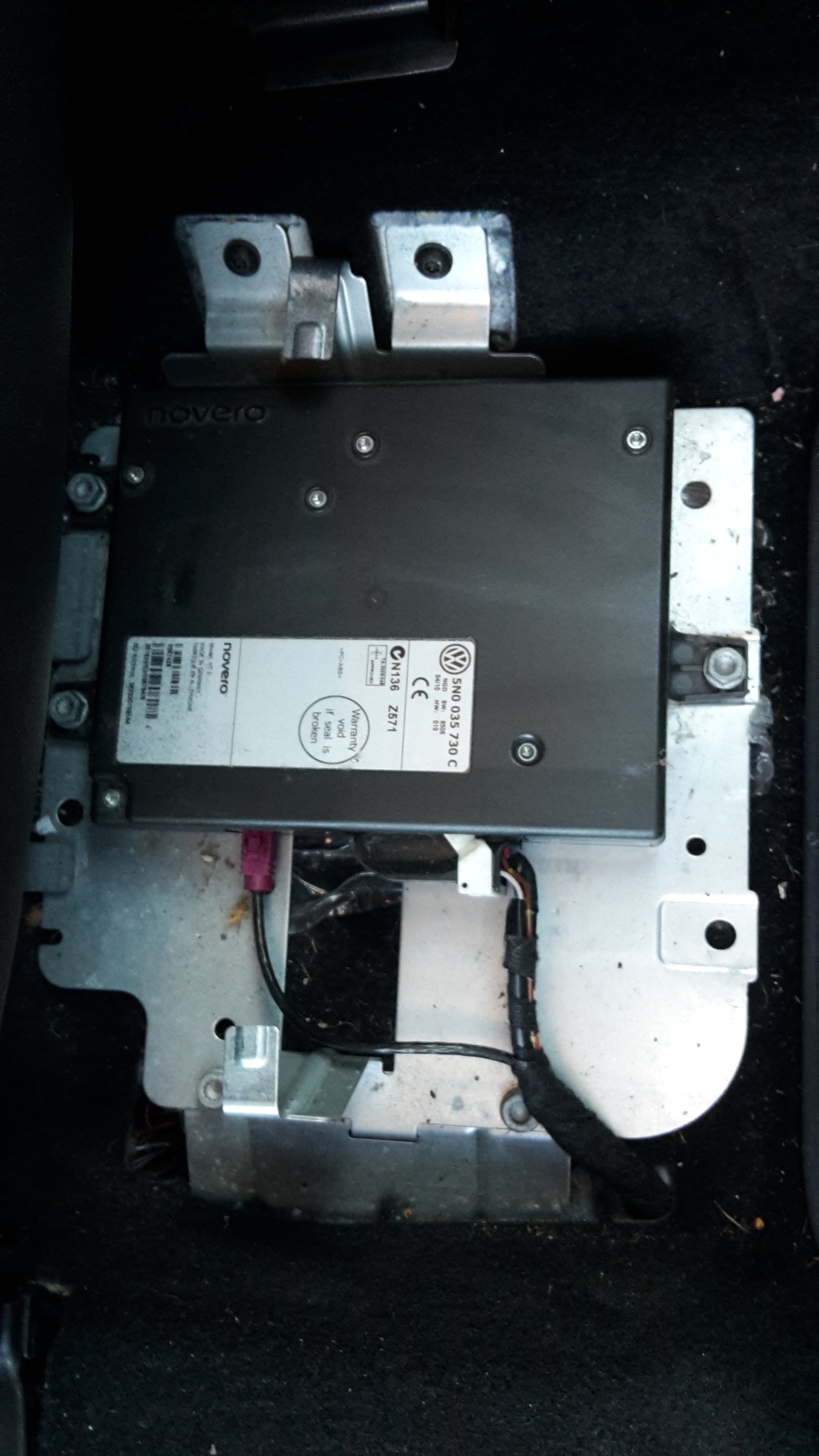

If you have BT it is under the seat on the floor:cool: under black plastic cover

To steal photo from other post
what you're looking for is on the floor and by the looks of your 1st pic i cant see the mounting bracket
pic is as you look from outside the car with seat all the way back, it usually has a black plastic slip on cover

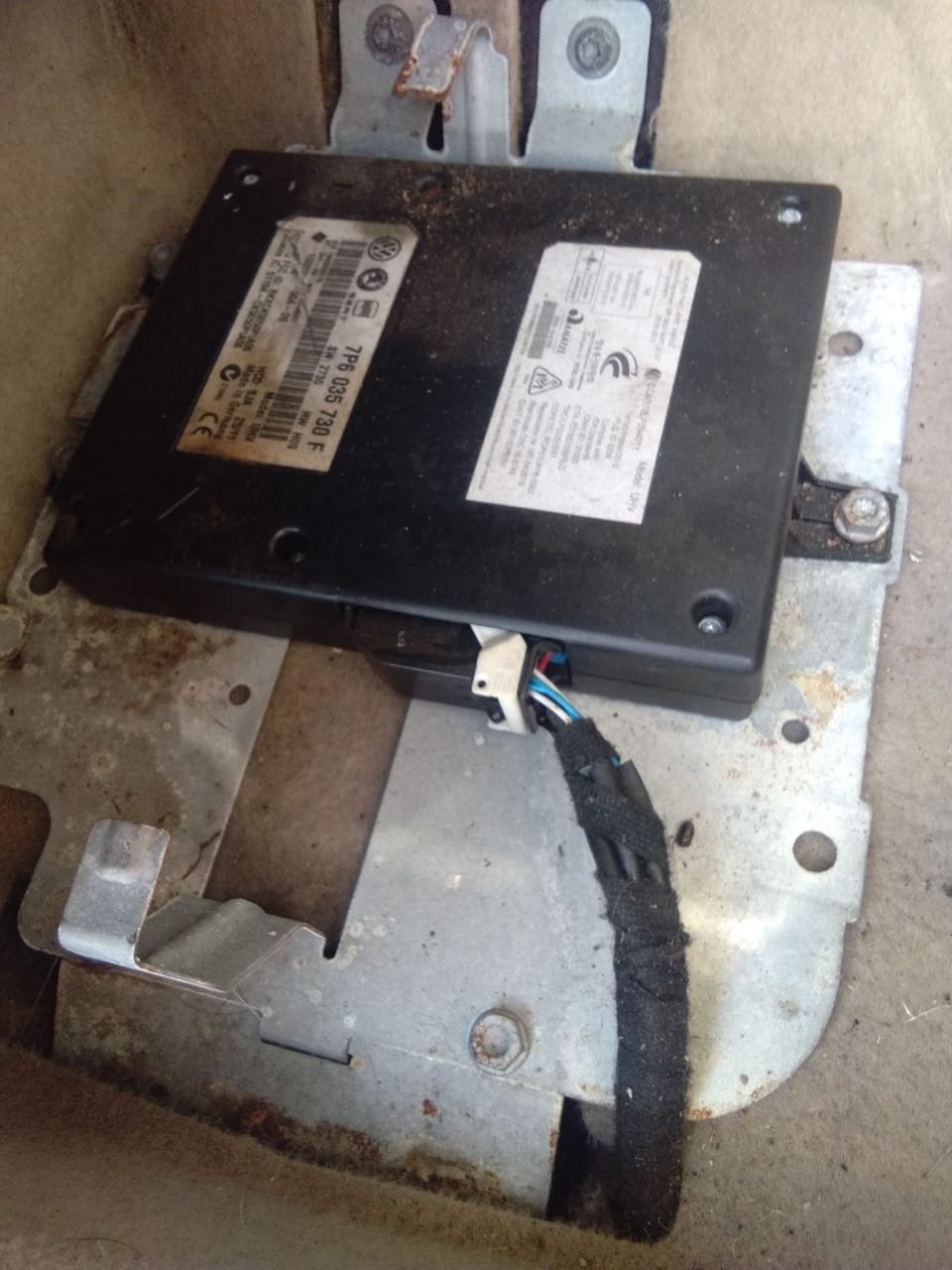

Guys, to update on what I had previously found that I didn't had a Bluetooth module in my car. I have found a guy who is selling it seems to be a Bluetooth module but the serial number seems to be a bit different that what we discussed before. Can someone plz confirm if this will work
Can someone plz help me out on this
If my eyes don't deceive me that is a revision F
so very new,
I also notice a lot of rust and water staining. I wouldn't want to plug that module into my car.
