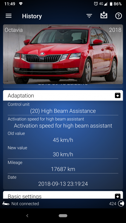

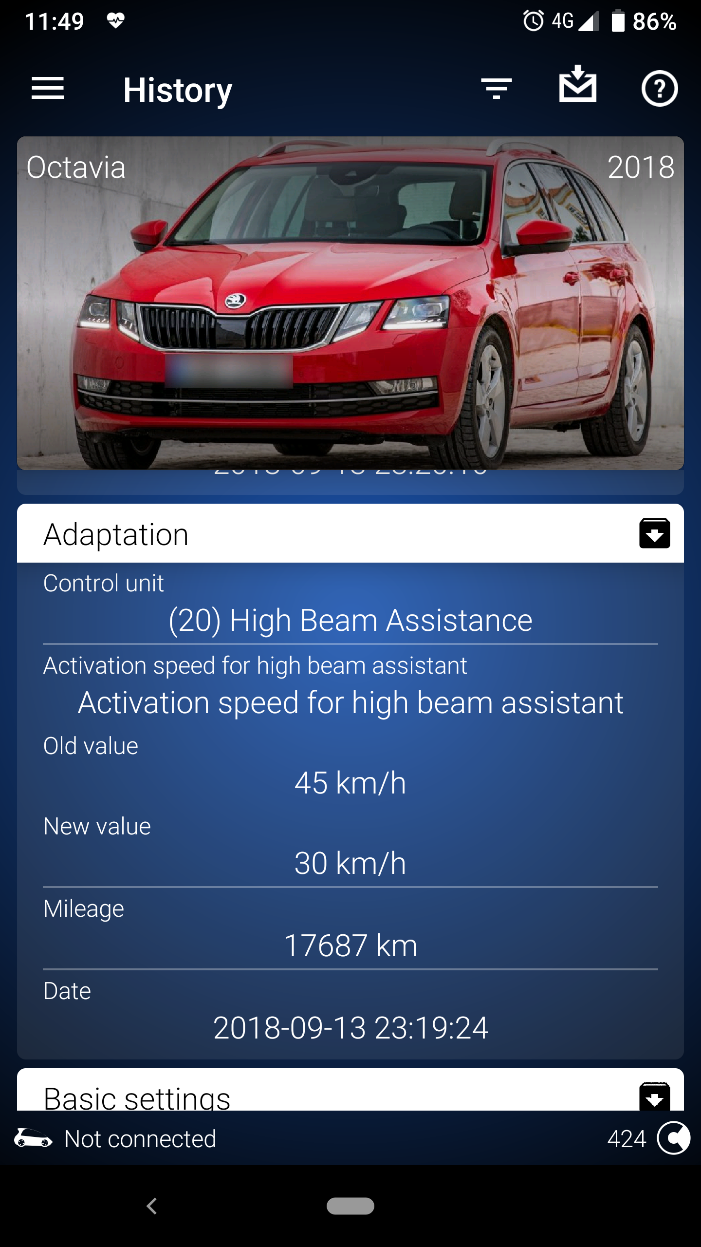

Hope this is helpful for you, I have changed my HBA to a lower activation speed because of tight country lanes on my commute. I've screenshot the change from my obd
Thankyou for the information! Am i seeing that correctly? Control unit 20?
If so, it's a control unit I don't have ;-(
@Maggle thats what I was thinking!
Yes
I'll have to check my tablet as well, I use both my phone and tablet with OBD eleven and that's from my phone, I'm not sure how well it syncs across device's on the same account.
Failing that I will connect up to the car tonight and post my findings then.
@Stonkerthankyou very much. I think we are on a loser here if that module number is correct but I appreciate you taking the time to look!
Module 20 is the "low spec" camera which can only do HBA, module A5 is the "high spec" camera which can do lane assist & traffic sign recognition and can be coded to do HBA.
