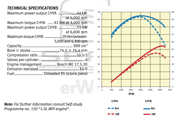

I read that up to 3000rpm the 59 and 75 bhp engines have the same map, after that the fueling is restricted on the CHYA engine. So unless you rag it, you wouldn't notice a difference.
It would be interesting if the dyno plot above showed the "before" power as well.

Below is an original, unmapped power graph

Here's a link to the official specs for the Citigo with all the gear ratios for the different models - ignoring the automatics, there are three different sets 44kw, 50kw and 50kw Greentech hope this helps:
https://cdn.skoda-storyboard.com/2016/05/TD-CITIGO-en-1.pdf
