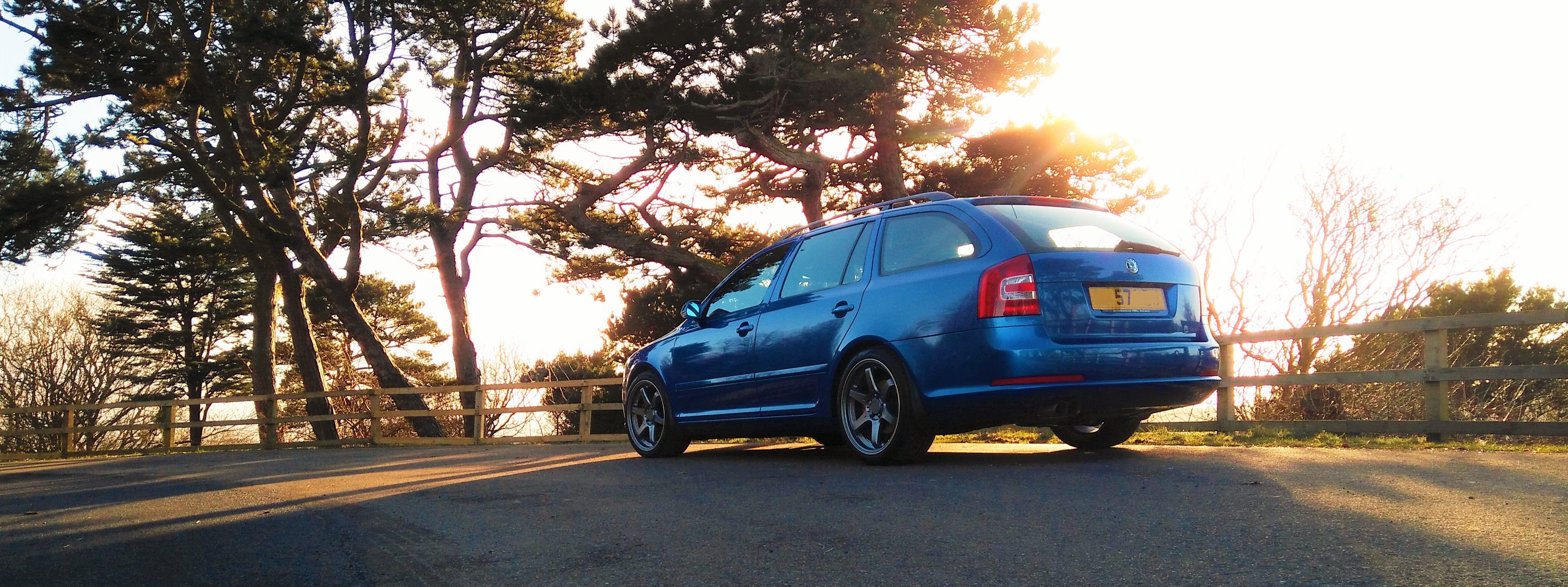

Anyway, here it is:
It's first wash by me -
The garage had machine polished it. So it has very few swirl marks. I have had to clean some cutting compound out of the nooks and crannies from this today.
Then a coat of Autoglym HD Wax
I love the way the black powder coated wheels hide brake dust! The black grill works well too.
It will stay standard. It's fast enough and handles ok if you drive it smoothly and properly. If it were mine it would have a set of Eibachs and 18" BBS CH reps on it, but it's not!
The 17's probably make for a nicer drive to be fair. It has aging General branded tyres on it, which I can tell are hardening. They're ok but they're not a performance tyre and are on a performance car, so whilst they are coping admirably, the difference better tyres will make I expect to be noticeable. I'm an Avon tyres fan.

I no longer have the car, it was sold to fund a van. 🤨 I really miss it and do regret selling but hindsight is a wonderful thing.
From memory, I'll let you know what I did to the car.
Turbo back exhaust with 200cel sport cat
RS Tuning remap - somewhere between 250 and 260bhp
Audi R8 red coil packs
Retrofitted cruise control
Eibach lowering springs specific to the estate
Whiteline RARB
Seat Leon FR interior
18" Fox Motorsport wheels
Race Blue coded front grille surround
I think that's most things covered.
