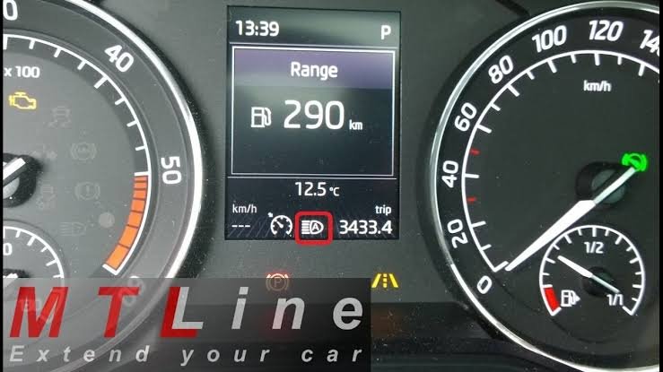

If you have HBA the headlight symbol in the maxi-dot has a small "a" in the middle. Select lights to auto and push the high beam toggle all the way forward. If you don't see the "a" then you don't have HBA but it can be enabled through vcds or obdeleven.
Like this...
I'll check
I have the A in the middle - so just High Beam Assist (so I do get the speed related dipping and main beam)  but not SLA
