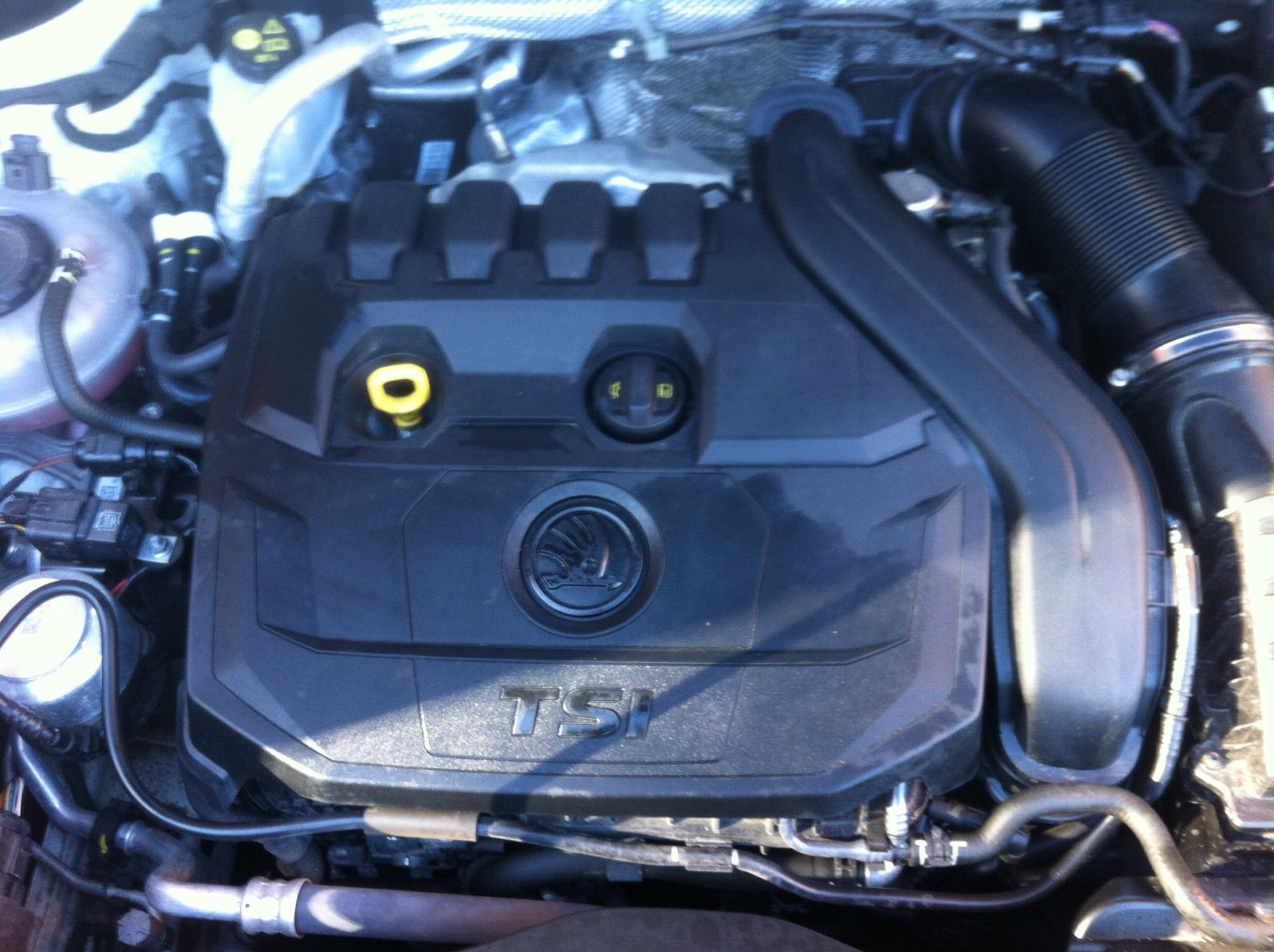

They have made the 1.5Tsi engine bay tidier with ACT hidden. Needed 0.25 litre oil top up so took a photo for comparison.:mmm:
