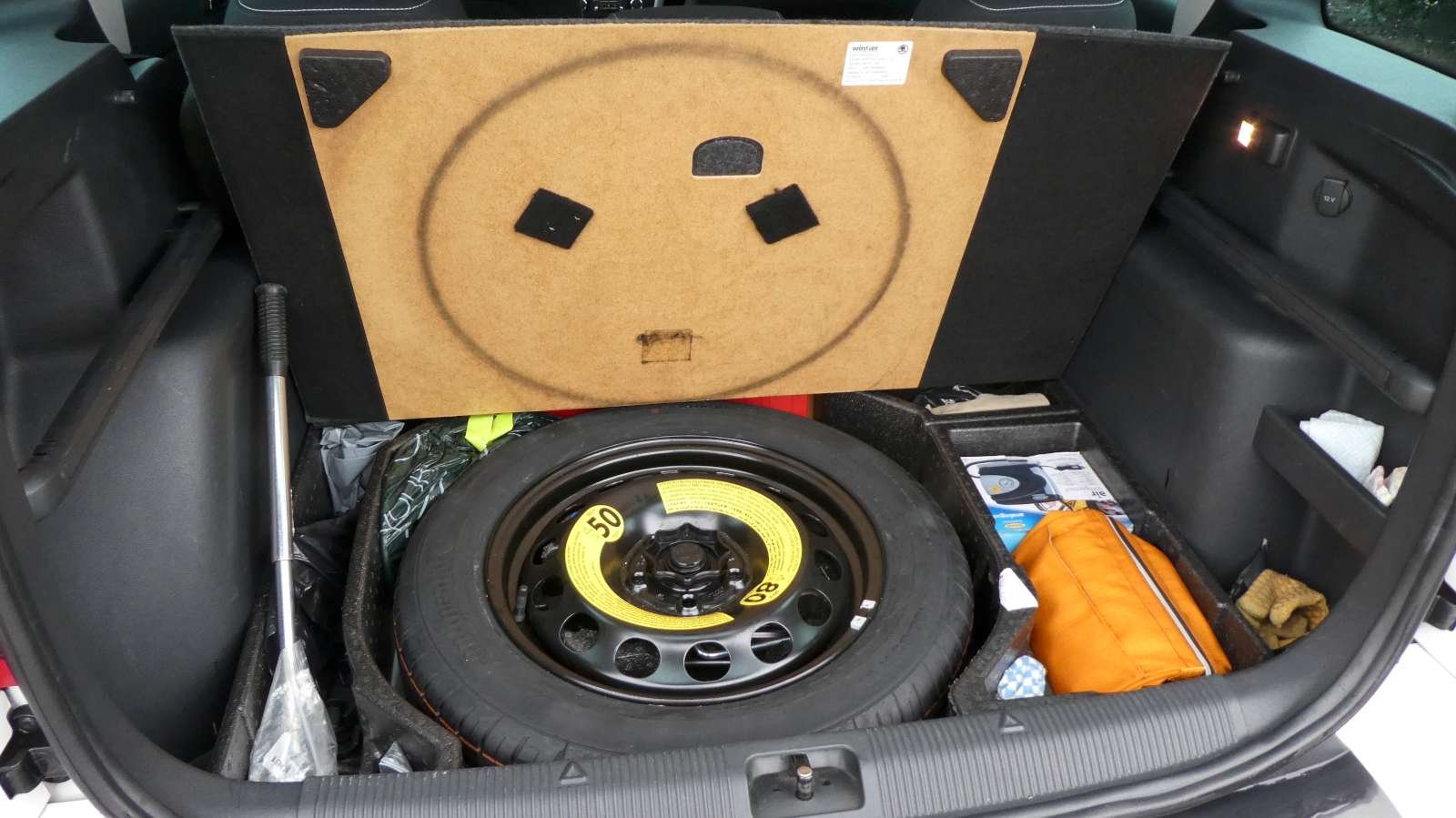

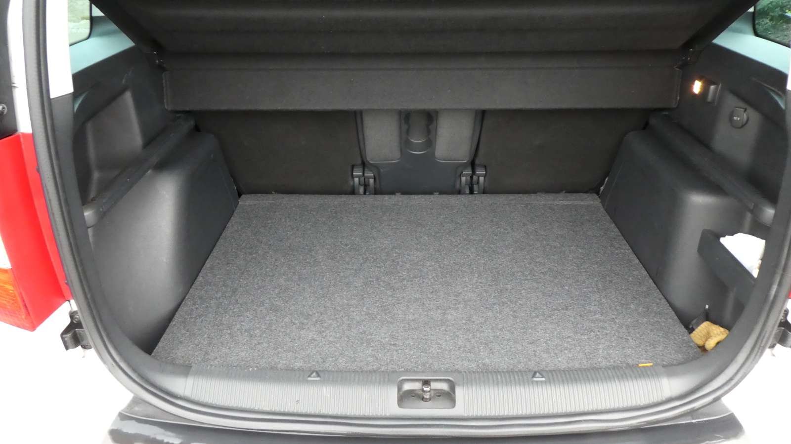

When the spare wheel and kit is in place the boot floor is more or less flush with the entrance into the boot. The attached photos may help.

ps - if you were to swap the spare over for a damaged road wheel then it would sit a little higher in the well. This is allowed for as the boot floor has a hinged strip in it allowing for the extra 30mm
