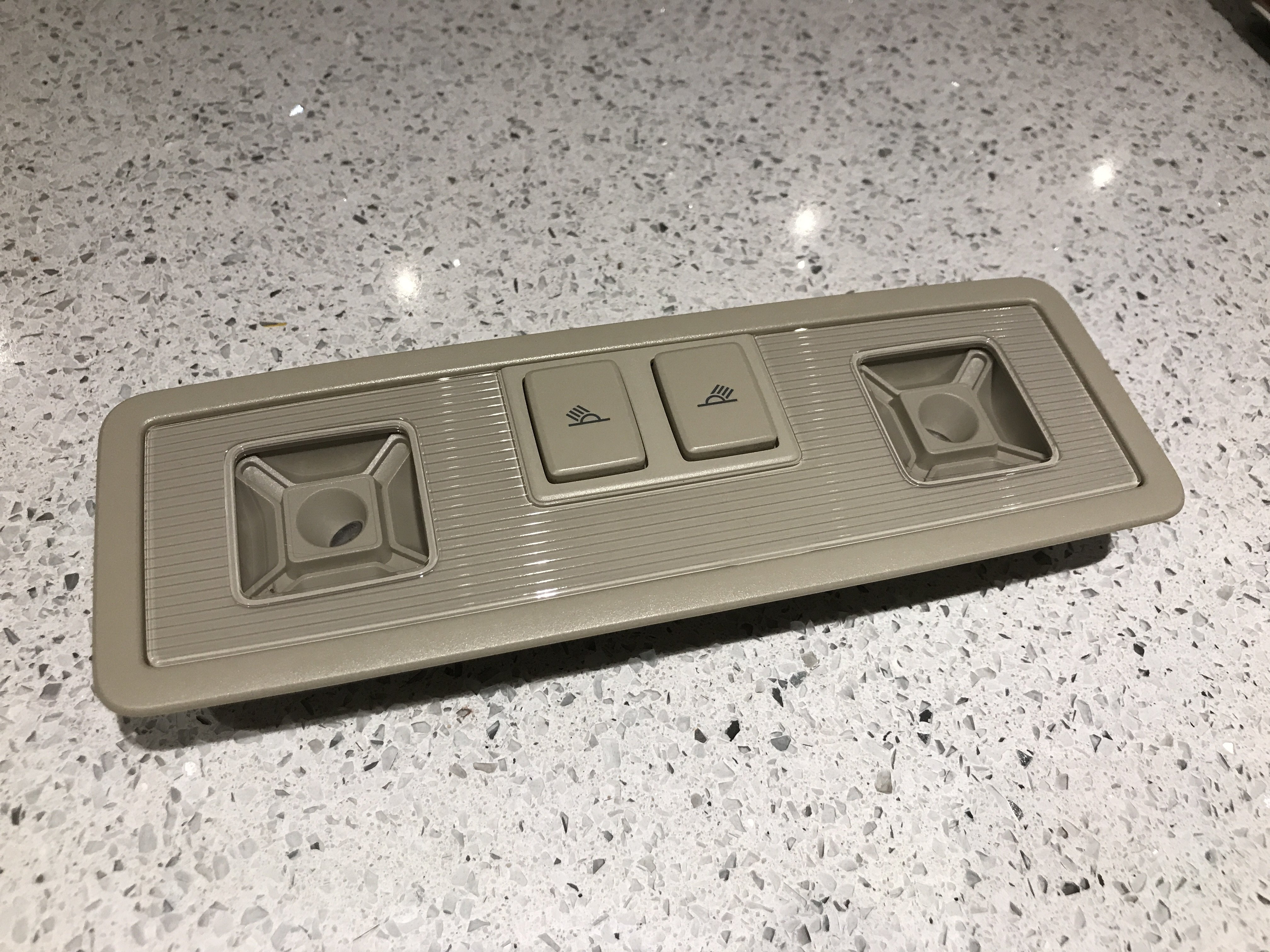

Has anyone else encountered this issue?   It’s a 2016 Estate with no pano roof.   I removed the light unit as it’s driving me mad, photo of it attached.
I'm thinking it’s simply a faulty switch.  There’s nothing in the lighting settings that covers it.   It should be covered under the warranty I have on the car when I bought it I believe.

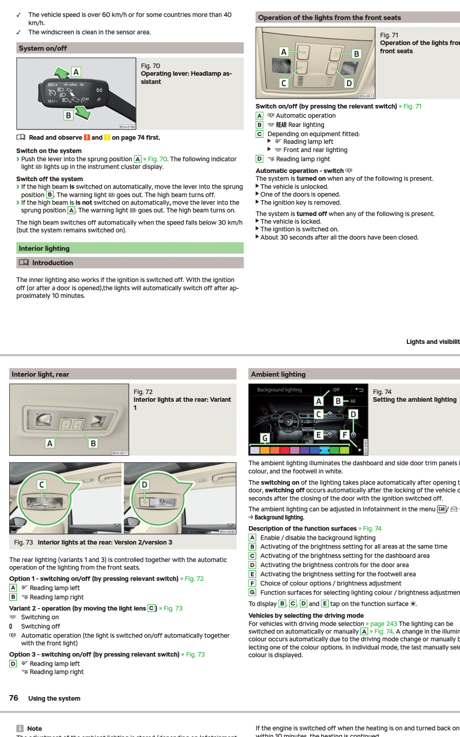

So from my understanding, for auto operation, from the first diagram, switch A needs to be on (in) and switch B needs to be off (out)?   And then both switches in the rear off (out)?
Edited by daveb99
Yes, and of course doors closed. They will turn off after several seconds or when the ignition is turned on.
When I first picked my new Superb up, I had the same problem for a few hours before the penny dropped that the driver can switch the rear lights on (B).

Update - I’ve now realised that the interior light switches are ON when in the OUT position, which seems very counter-intuitive.    That’s what I was doing wrong......all now working perfectly in auto mode.  Thanks for your help xman.
