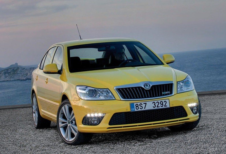

The vRS (facelift) uses the same headlights as the non-vRS models, but gets a pair of LED strips in the bumper too, just above the front fog lights.
These LED strips perform the role of DRL ( Daytime Running Lights), at full brightness, and side / parking lights at a dimmed / reduced brightness.
As a result the regular 5W incandescent sidelight bulbs in the headlight are redundant. Fitted (to fill the hole) but not wired up.
They've had many an owner / MOT tester confused...
