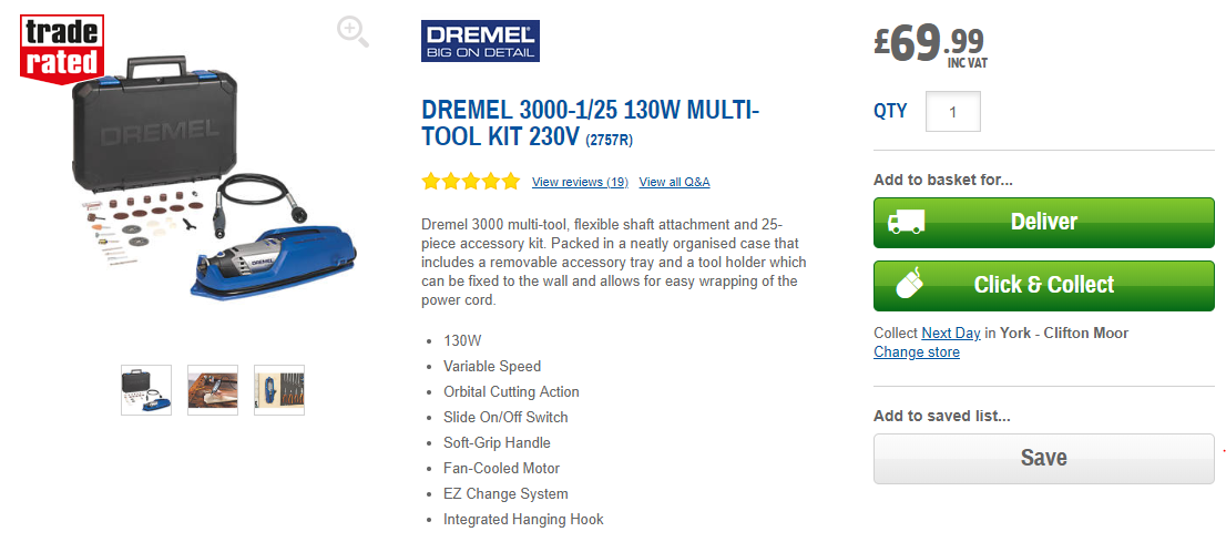

I'm looking to get myself a Dremel 3000 multi tool, or equivalent.
Corded, no need for cordless really, so I'm looking around £45 (15 accessories) from Amazon or £70 (25 accessories, including the flexi shaft) from Screwfix.

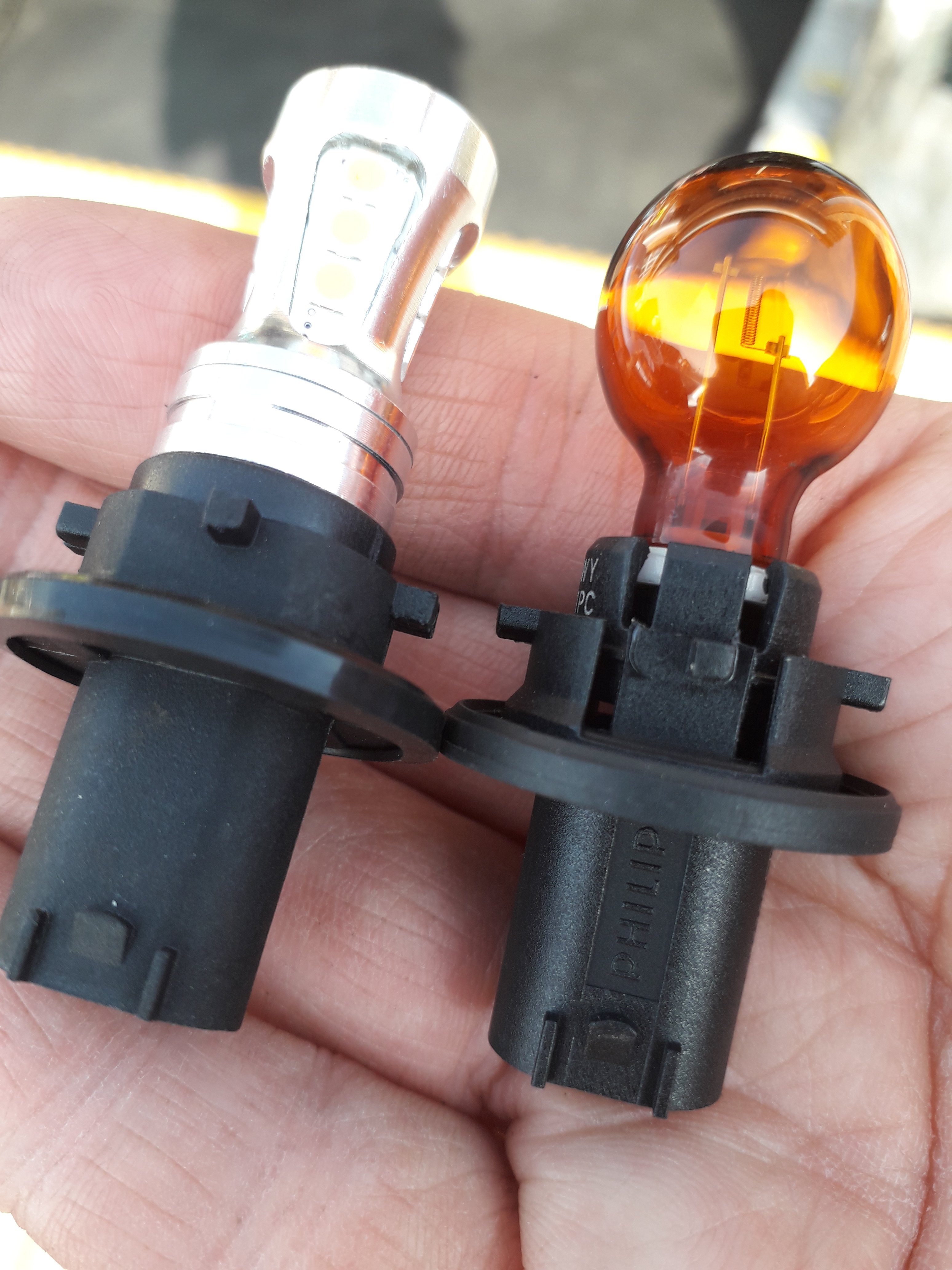

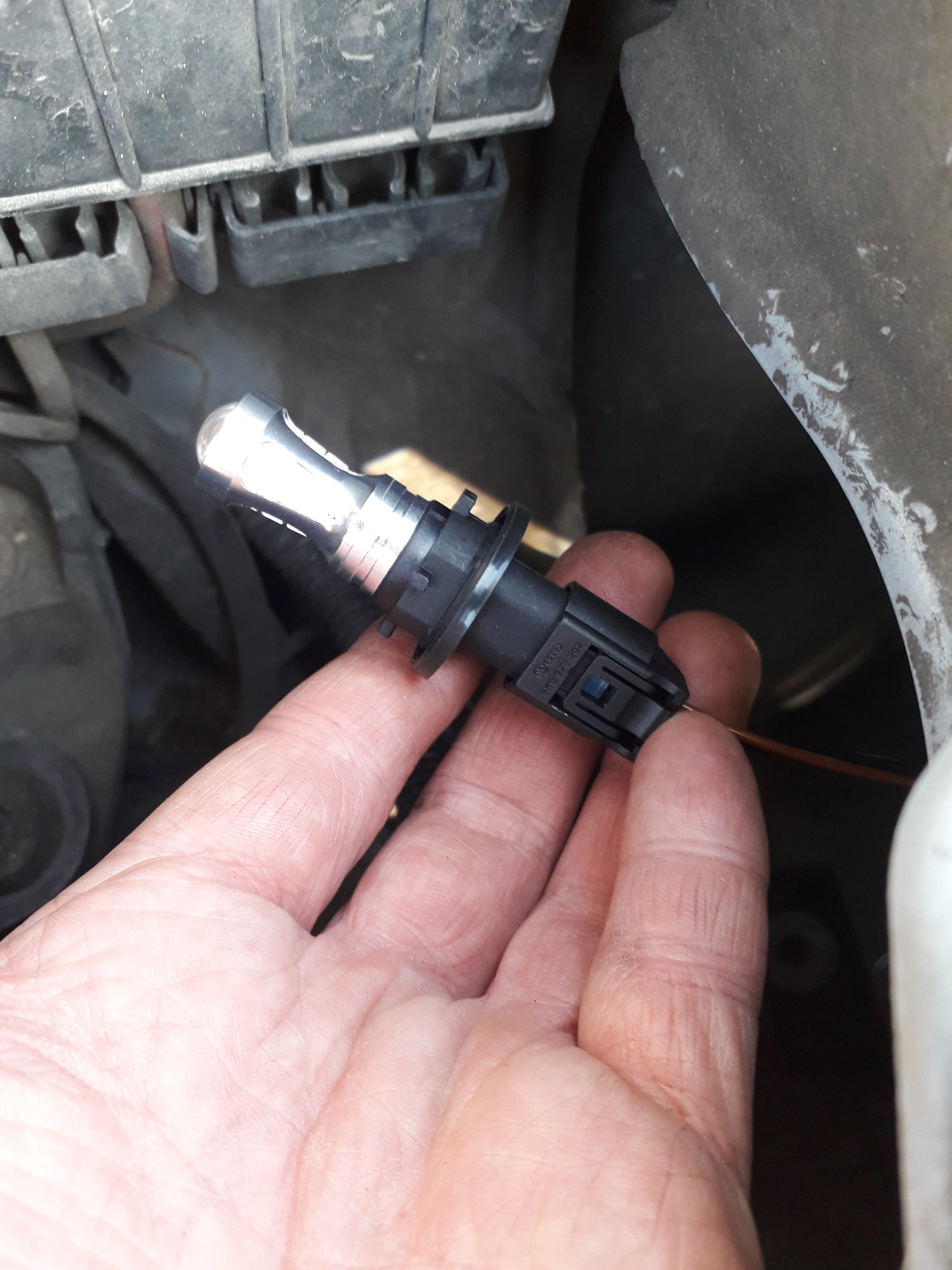

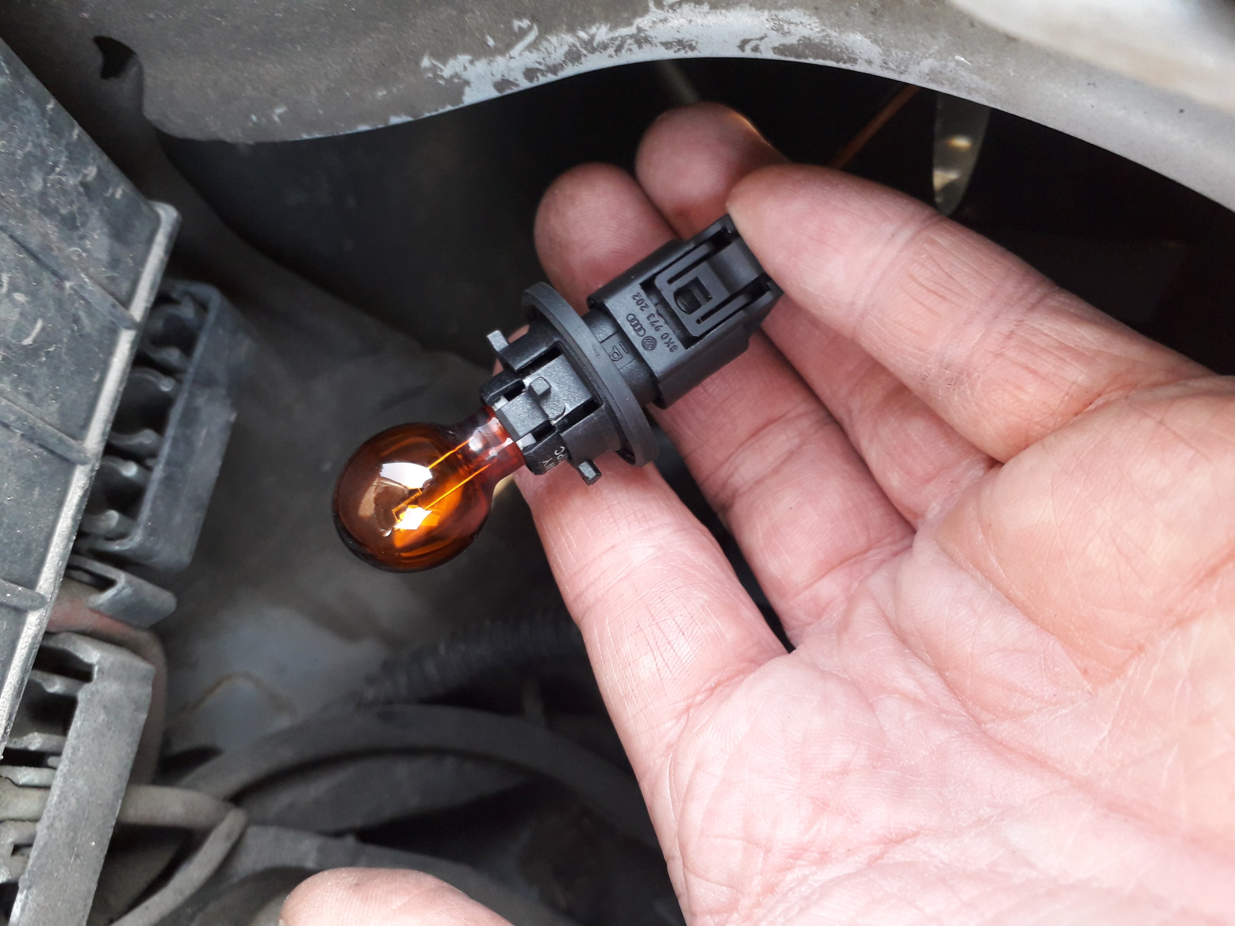

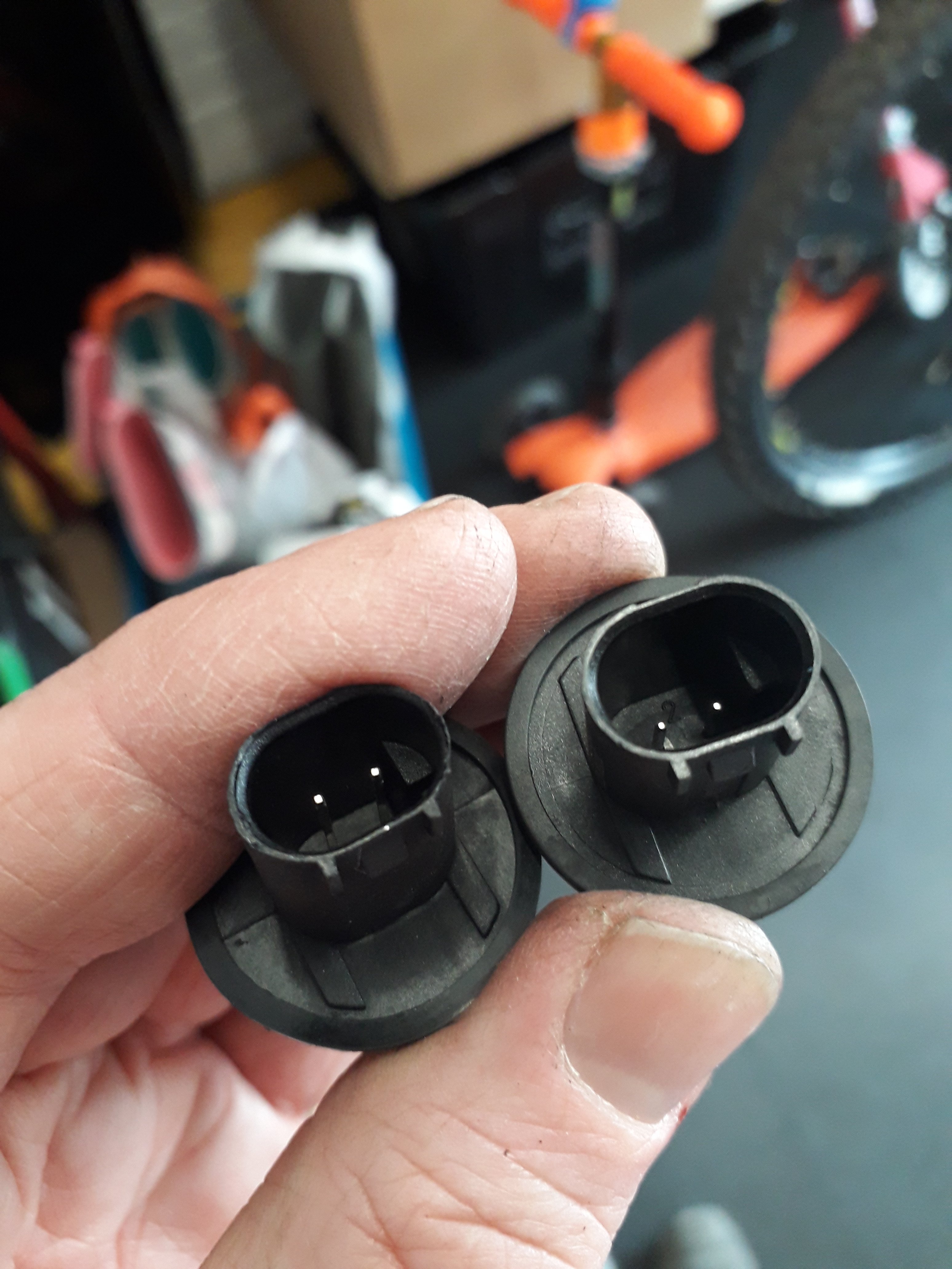

The main reason for purchase is to shorten the metal contacts on the LED bulb on the left, access is really tight...
The new bulb won't fully seat in the bulb holder as the 'too long' contacts versus the original is preventing the bulb from sliding all the way into the bulb holder and from the latch clasping shut...

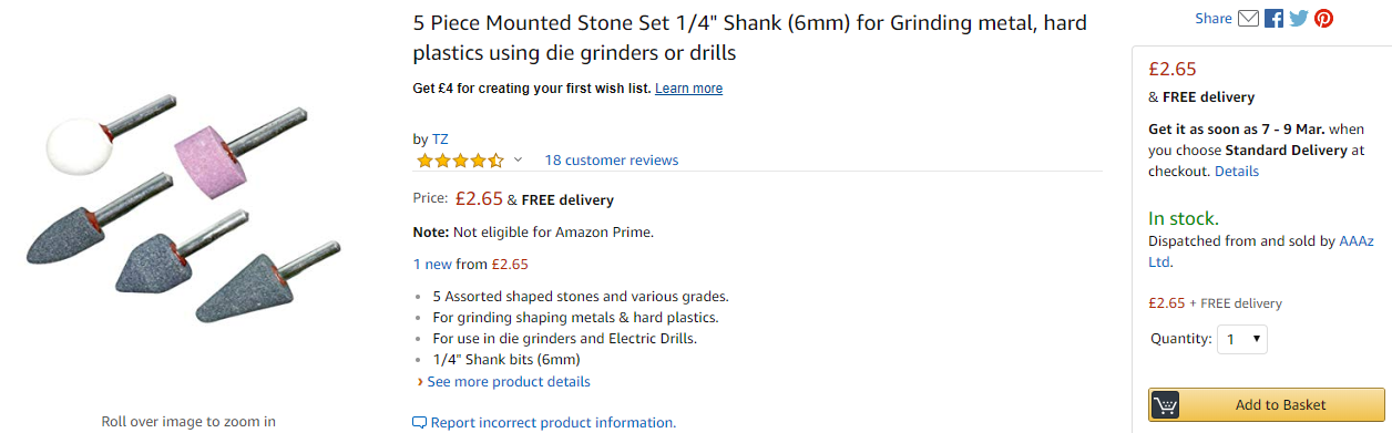

Nice idea, much cheaper too...
I'm assuming one of these could be used to shorten the contacts, without bending them?

Using a bit that's designed for a rotary tool or die grinder running at 20-50,000 RPM would not work very well in a 2000RPM drill, just to stop you from being disappointed. (I know I have tried it)
If you want to shorten those pins You would be better off with a pair of small sidecutters and trim them down rather than trying to grind them

The pins could be hollow so any attempt to shorten them would result in a less than ideal outcome!
If they're solid then the white tool above would be the one to use.

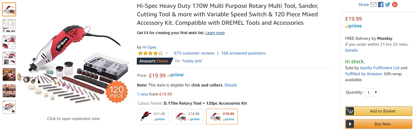

There's a Hi-Spec tool on Amazon including some accessories for under £20 - and it's surprising what other (albeit infrequent) jobs they can be used for.

A lot of kit for £20...

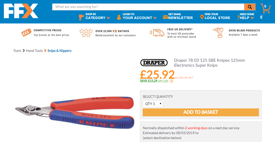

I like the look of them, I was worried about access for any type of wire cutter or pair of pliers, but they'll look as though they'll do the job!
Cheapest I could find them...
I'll see if I can find a cheaper alternative...

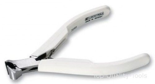

Those won't be any good and even if there was enough access, they'd be the wrong type.
The ones you'd need are like this but even then you'd be restricted for access.
BTW they're £130

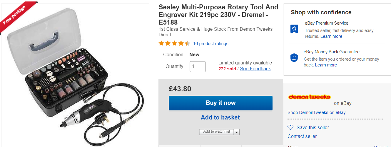

Think I'm going to give this a shot...

I think those would be fine, they are only a soft metal pin and with the angle of the head you should be able to crop some of the length off.
I think in practice you might end up just bending them with a grinding tool but its your call, its worth having the Sealey tool kit anyway it will come in handy

If you're going to get other uses out of it then get one. If it's just to shorten the contacts on that one job then just undo the connector, usually just a a tiny tab that secures them, pull out the wires with the connectors and shorten them with a pliers and clean up the cut before re-inserting them back into the plug.

Yeah but Lindstrom cutters are the mutts nuts. I've got a pair of flush cutters from Openreach that retail around the £40 mark.
