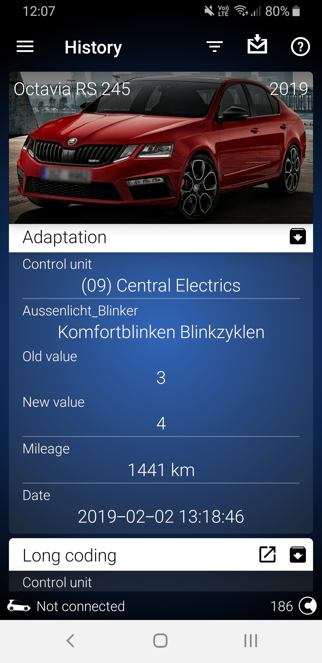

Set mine to 4, it didnt complain...

I can confirm you can program up to 5 flashes, but I find 5 to be too many, so I've coded mine to 4.
99% of the time, they work with 4 flashes, but occasionally, they revert to the factory 3 flashes all on their own.
A shutdown/restart of the car usually resets it back to my programmed 4 flashes though.
No idea how/why this occurs, but it's so infrequent I don't worry about it any more.
