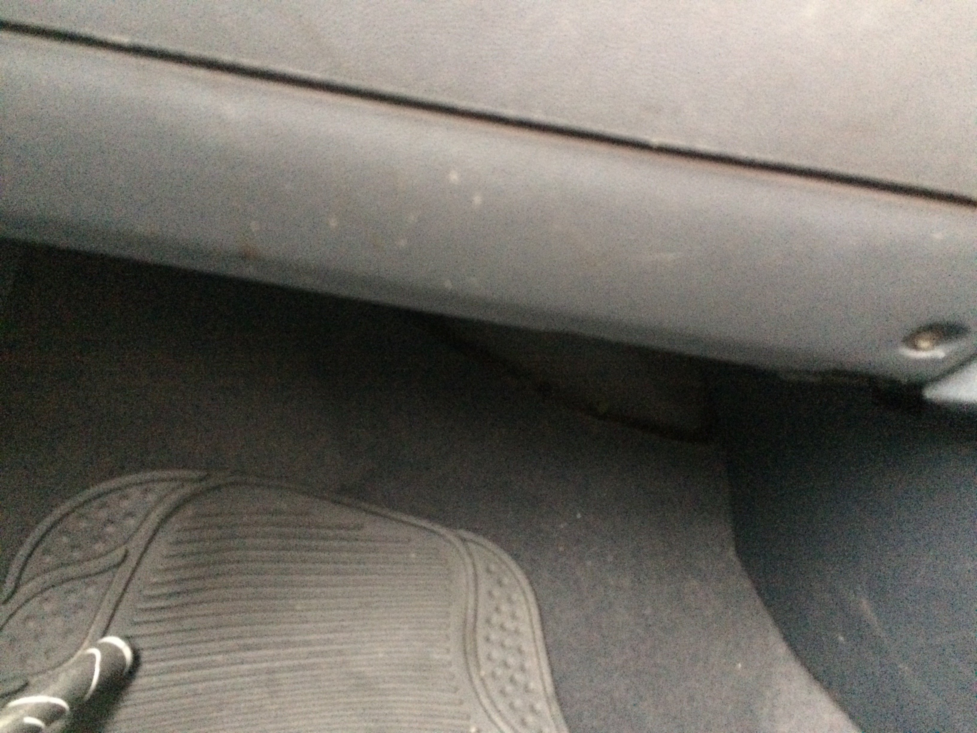

Another annoying rattle coming from my car is from the panel beneath the glove box (rubbish photo below).

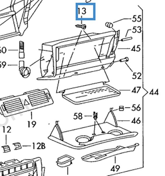

Can anyone point me in the right direction of the screw and rubber washer part numbers?
Screws are part number N 90698606. There is no rubber washer.

Cheers there were def some in mine as they dropped out when I unscrewed it a couple of years ago!
Maybe someone had put them there. I've had my glovebox out a few times and no washers. Nothing on ETKA either.

@Wench @TMB - Which makes me think that a previous owner of Wench's car was trying to sort out a rattle in that area. Wench, if there's a good car accessory shop near you, ask them about suitable size grommets, from TMB's last I'd guess 4mm internal diameter would be best, but it may take 5mm if they're going between 2 panels.
