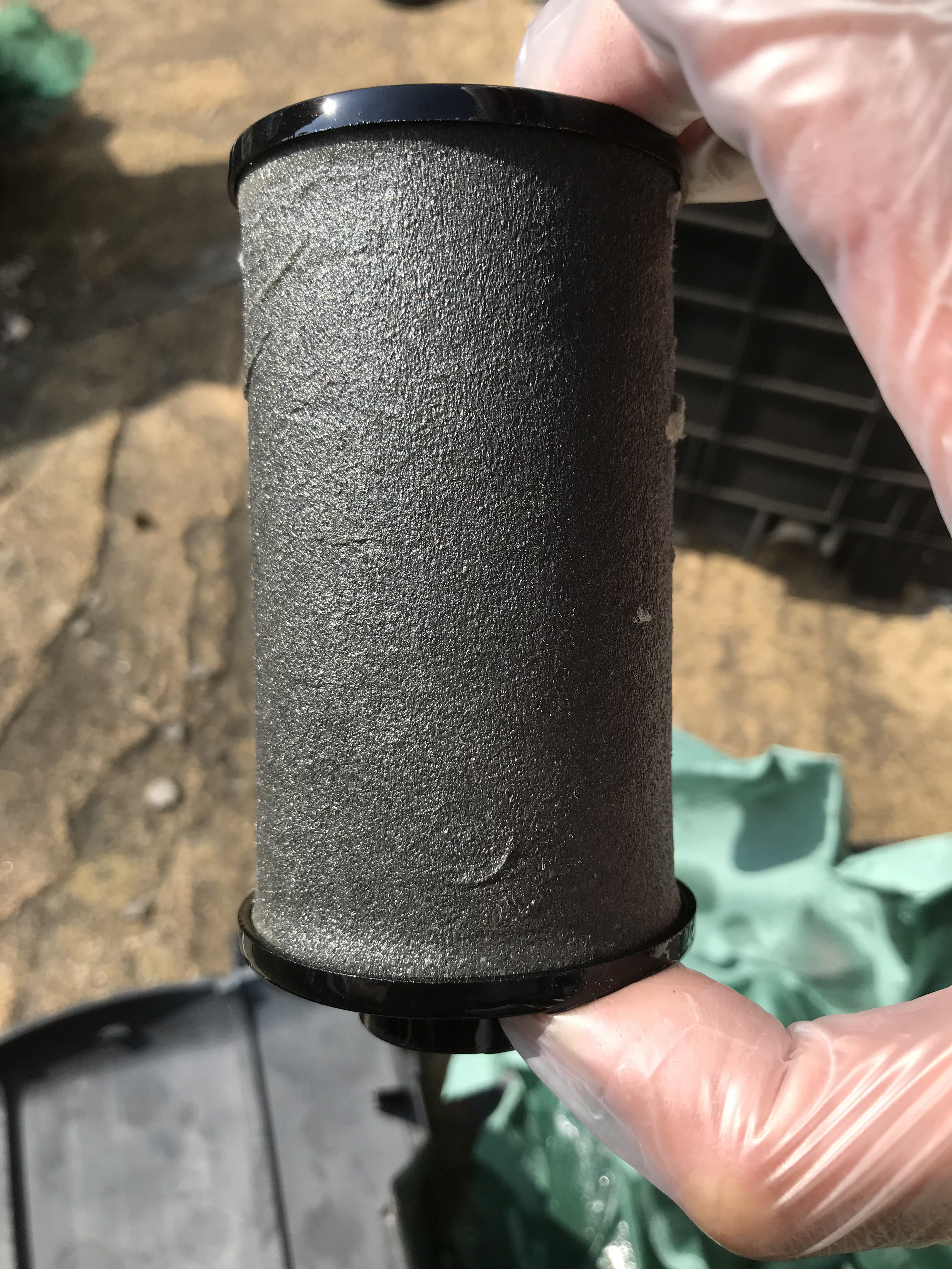

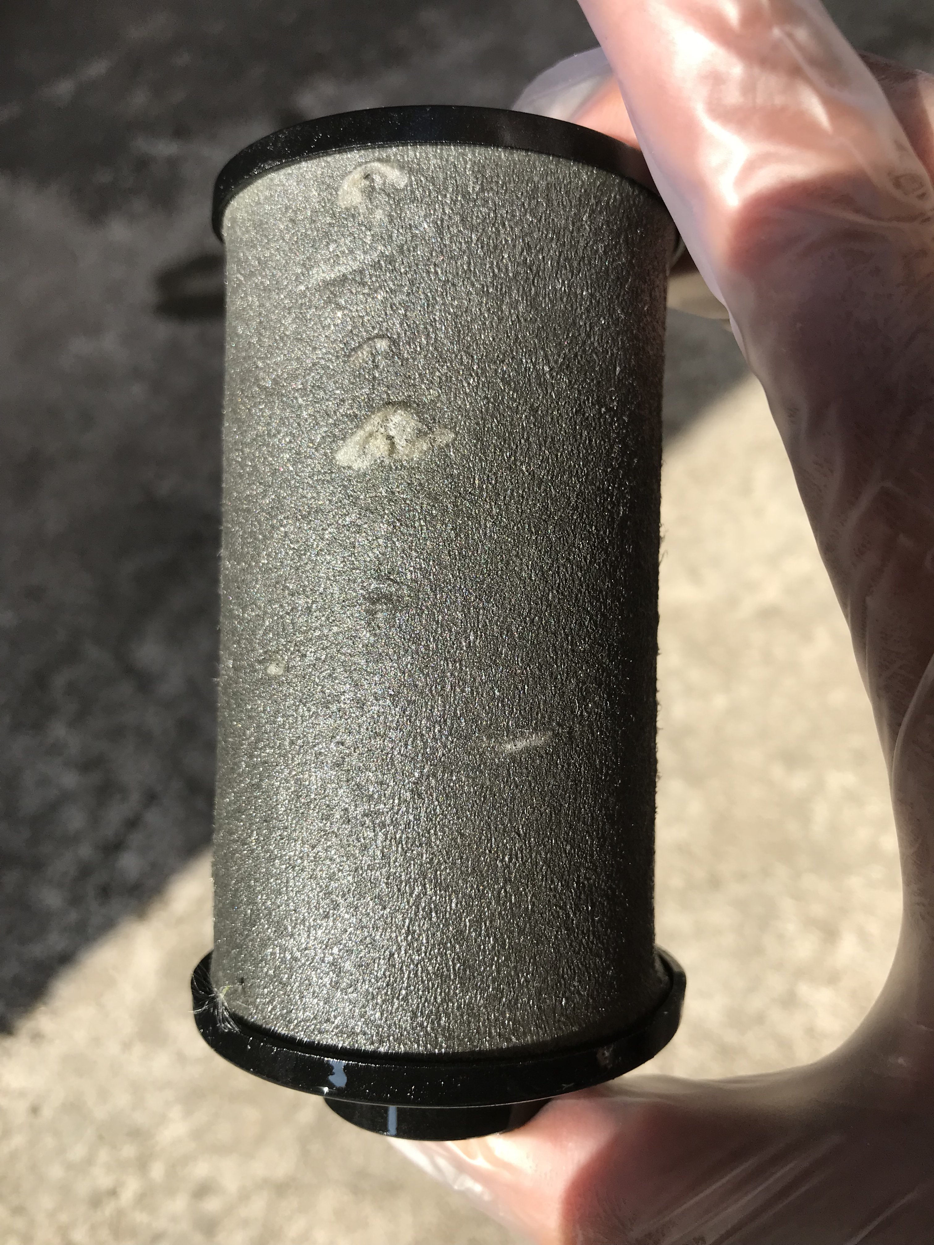

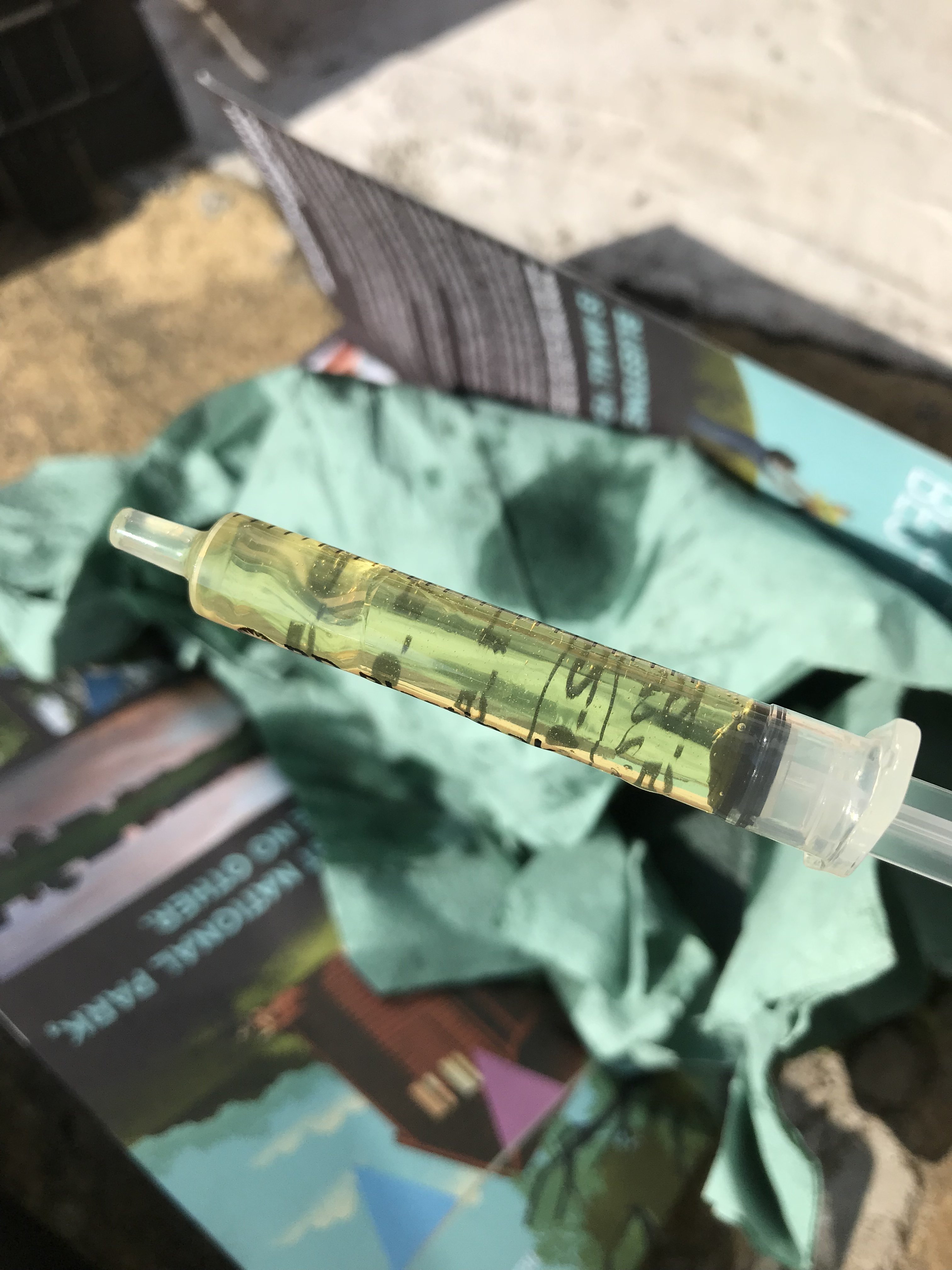

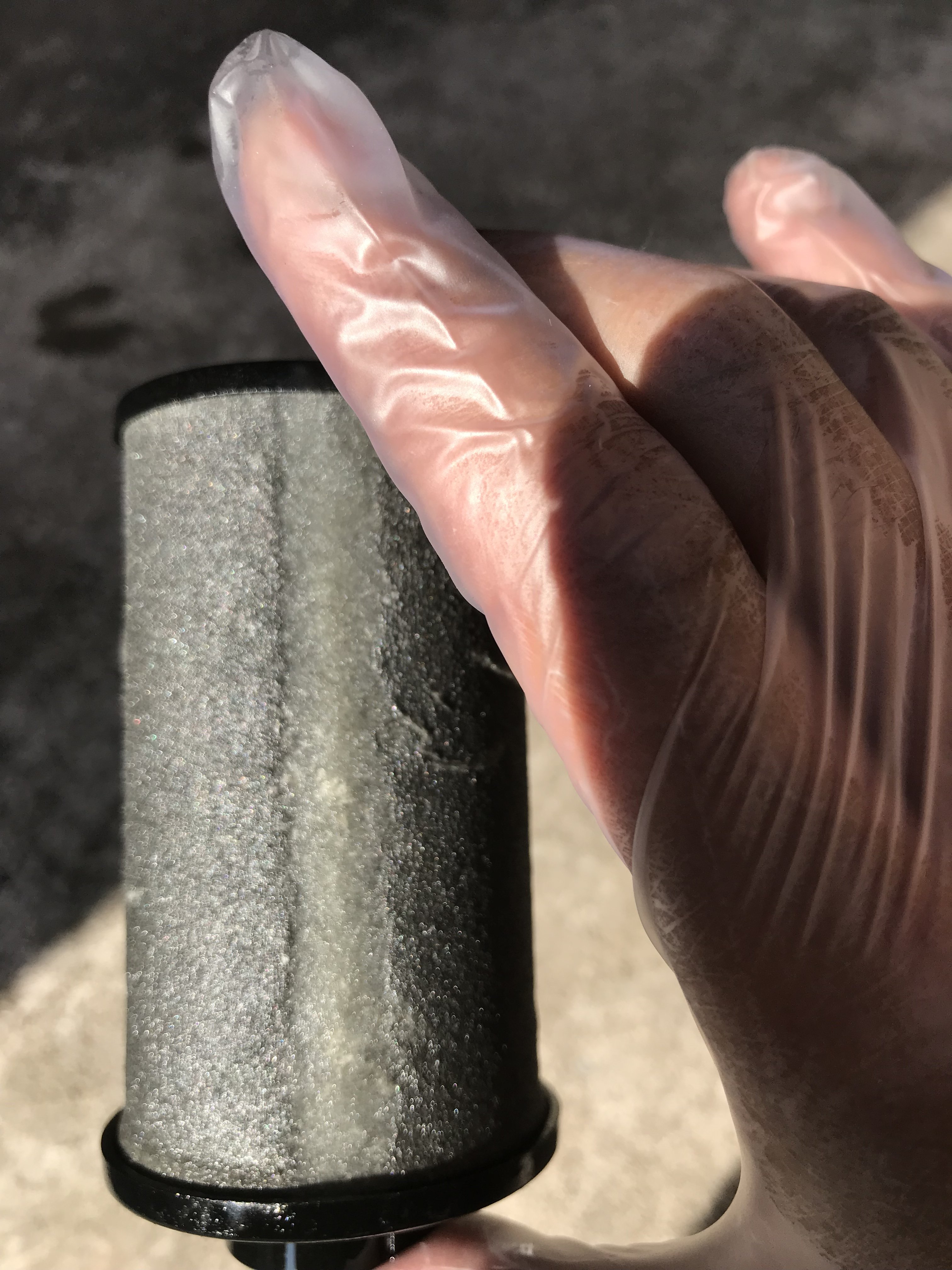

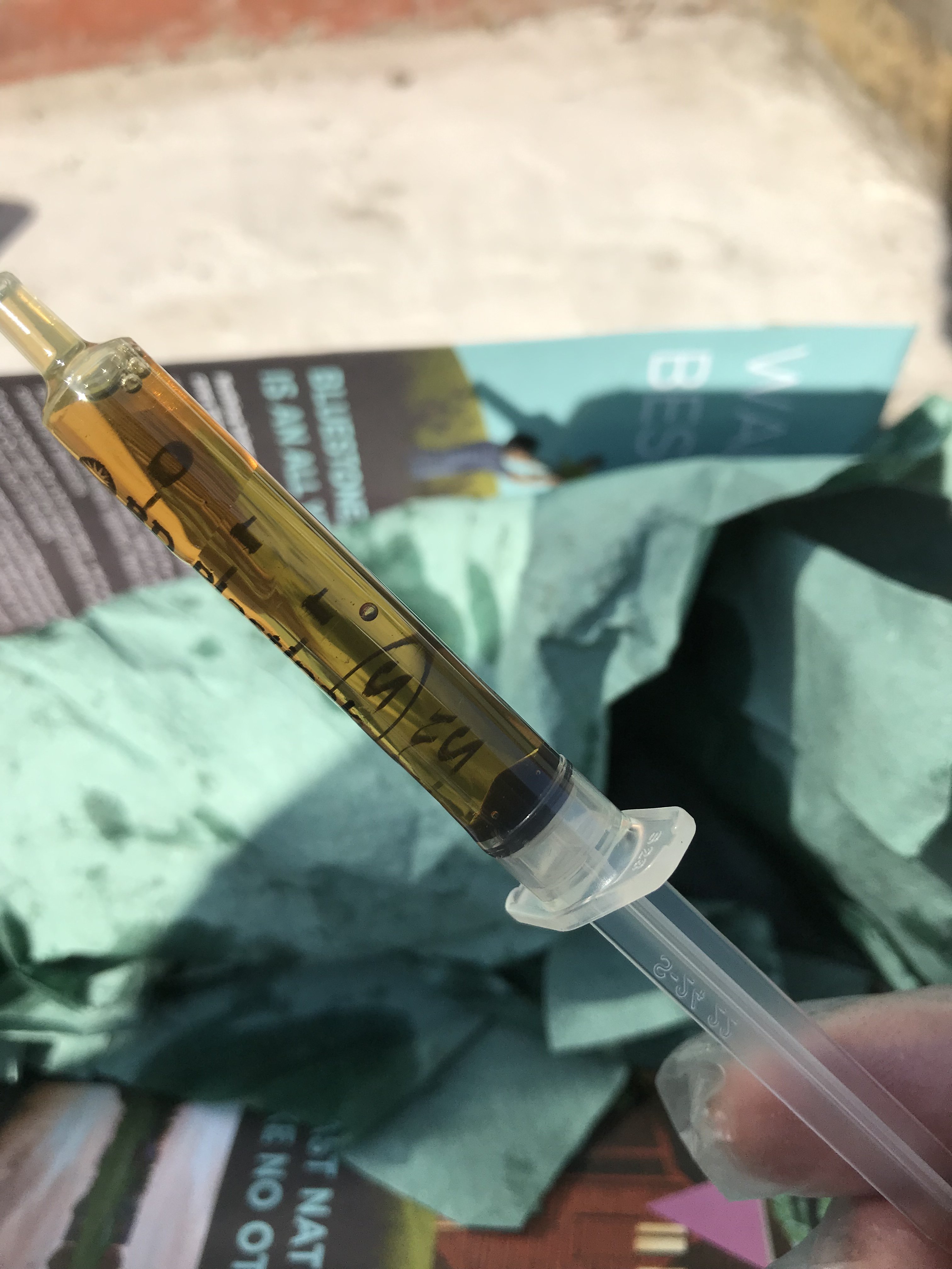

Have done an oil top up as I type. It appears to me the filter was not changed. I say this because to gain access to the filter had to remove air box, battery and battery tray. On doing so the bolts and screws seemed untouched. Anyway I continued. On taking out the filter it doesn’t appear newish at all. Attached are some picks of the filter, old oil and new oil. Any thoughts or am I being paranoid.
Had to attach additional pics separately as 10mb is largest file uploads.
I’m guessing they may have changed the oil but not filter. Vehicle has done approx 500 miles since the oil and filter change was supposedly meant to have been done
Will drive it around and see if there’s any improvement. Will request a gearbox replacement from volksworks who will arrange for a refurbed box and install if this fails. I’m just really pee’d off that central vw in erdington did not do a filter change which they charged  me for.

That "old" oil doesn't look too bad, I did my own dsg oil change last year and the fluid was a lot worse than that.
From what I understand there's usually quite a lot of the old stuff left lurking in the internals of the gearbox after draining so I'd expect it to be a bit darker than the brand new.

The photos of the oil certainly suggest it has been changed. That filter though, I don't recall mine looking like that when I changed at 38,000miles.  It looks  pretty gunked up. maybe that is causing a hydraulic pressure issue. Are you changing the filter?  I would also have some words with the garage with photos like that!

Having now studied the self study on dsg, read up on the various issues and spoken to maktrans in Warsaw. I am inclined to believe that the filter is somewhat blocked and is restricting oil flow to the n215 and n216 clutch solenoids. I have taken the old filter apart and noticed there exist no valve like engine oil filters to allow oil flow on restricted filter medium. My gut feeling is that given the dsg oil pump is driven by the flywheel which in turn is driven by the crank there is a restriction in oil pressure to engage the clutch and this perhaps may be the cause of my issue. I will keep you all updated as to the progress as it may help someone somewhere down the line.
