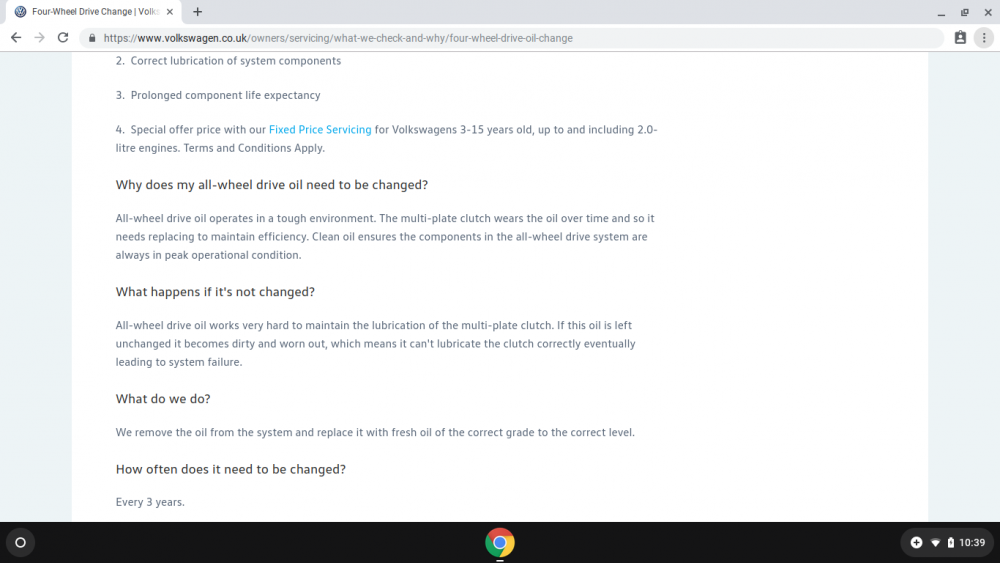

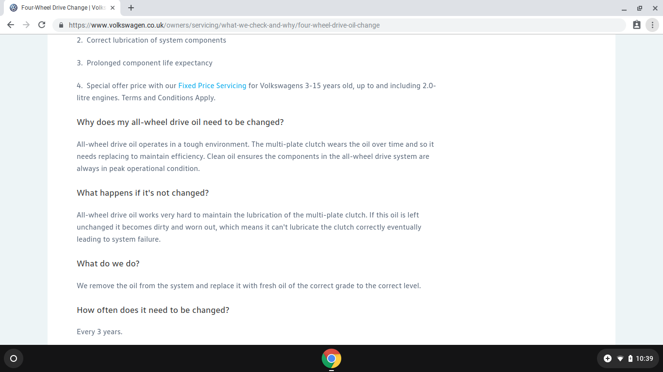

People will continue doing Preventative Maintenance to reduce risk of damage and expensive failures.
That is what Service Guidelines and Schedules are about.
Plenty will have gone 4, 5 or more years and 40,000 miles plus with no issues, and clean draining of the consumables.
Others now change at 3 years / 30,000 miles just because the Guidelines were changed from people with unfortunate experiences.
It’s only the Haldex that has a recommendation to change at 40k.
Transfer box I am not sure about, but differential is not normally serviced?
Mind you at your miles it is probably worth doing and good to hear the Haldex can last that long without a filter change.
