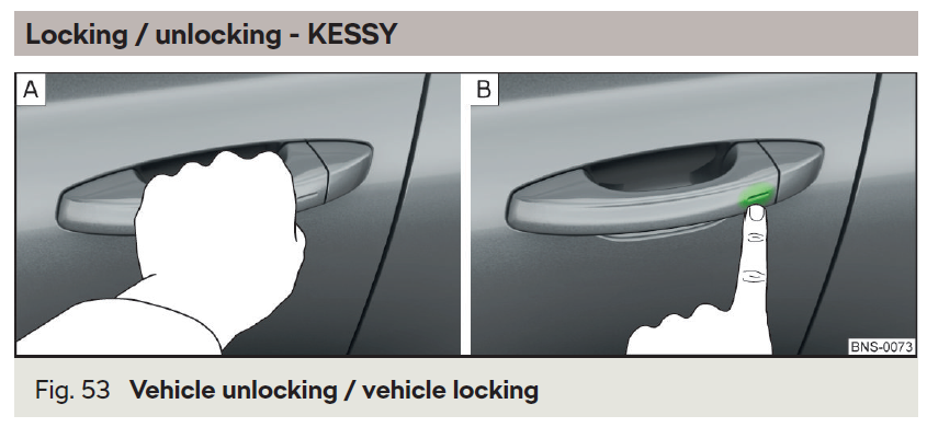

Also if you have KESSY then two slides of the hand on either door will open both
Now that is interesting, two strokes of the sensor for me just re-locks the doors!
You have to slide your hand behind the handle, not the sensor on the front
Oops, i’ll Get my coat......!

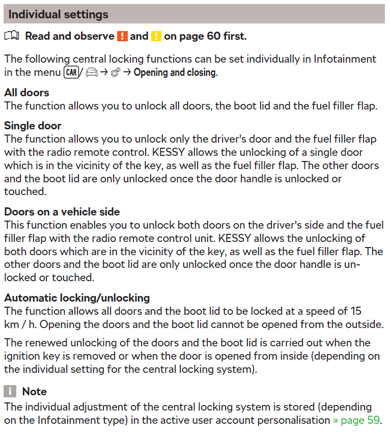

Think I'd just set it to 'one press opens all doors'.
Not sure the Karoq is high on the carjackers list, plus my hand bag is well secured on the choke lever.
I’d agree ‘silver’ but the wife has a colleague that suffered a incindent recently where some scroat looking for “any spare change please?” opened her rear near-side door moments after she returned to her vehicle in the same car park MrsB uses.....no real harm done but her team are all a little nervous now.
Is the key / car customisable to open as required, like the seat and mirrors, I seem to recall something Regarding the Golf having such a feature?
Looks like a yes then?      .....or maybe not....!

The car can get confused if you touch the moving part of the handle AND the sensor at the same time. To unlock just touch the handle OR the sensor or use the key fob button.   Similarly it can get confused if you try to lock the car touching both the handle AND the sensor.
Tom
It only gets confused if you do it wrong. It isn't overly difficult :D
