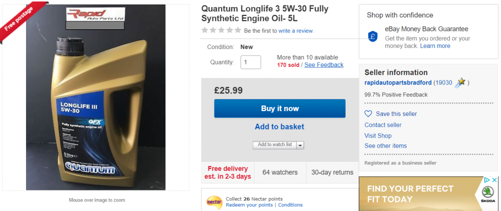

Or forgo the fancy brand name and use the same stuff the main dealers use for a fraction of the price...
