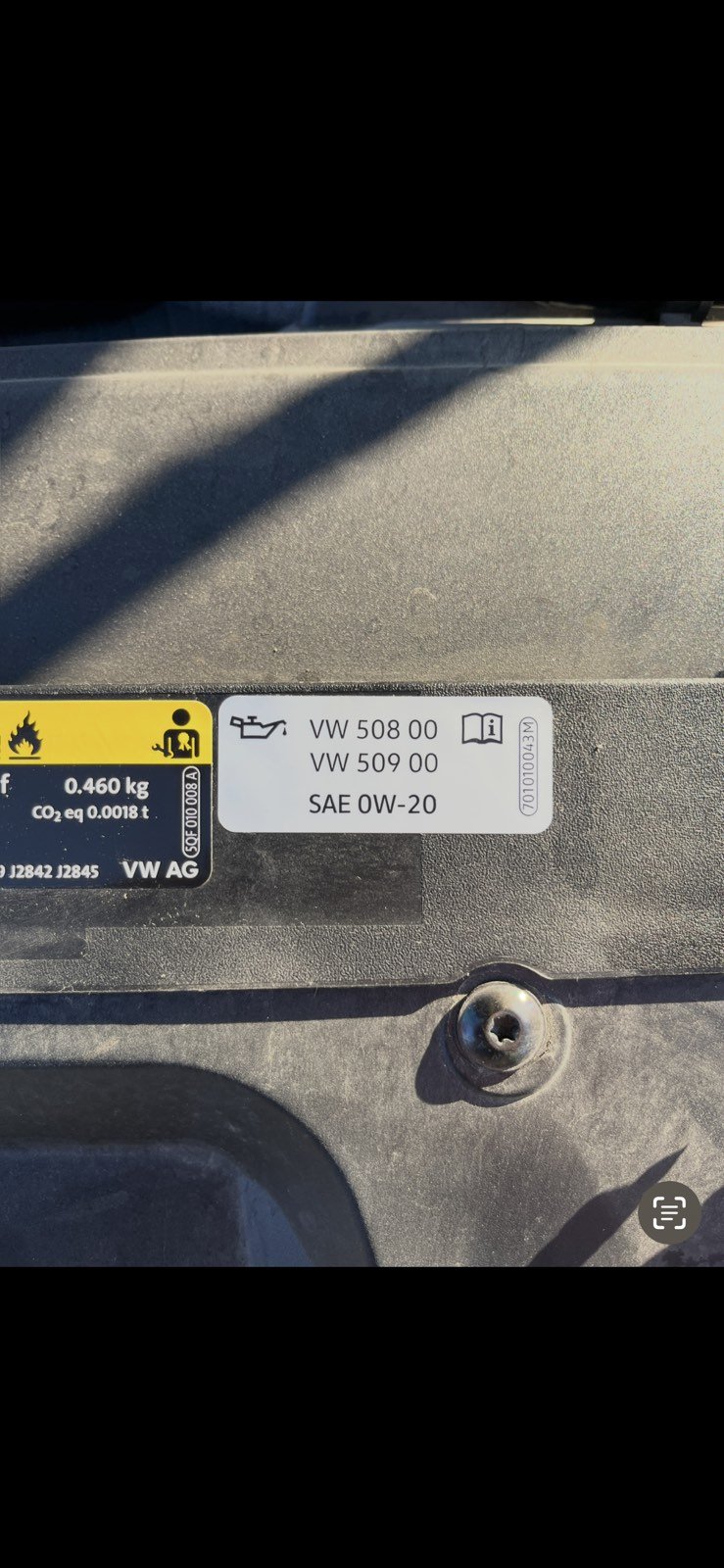

Anyways, upon opening the engine bay there is a sticker notifying oil use of VW 508 00 / VW509 00 / SAE 0W-20.
Well this is confusing. If it was only the Hot Rating different i would be ok since i am in Greece and generally the weather is not too cold, :) but this suggests a different Viscosity as well.....

The 0w 20 FS IV is right if the sticker is there.
If you do not want to use VW 508 00 / 509 00 but VW504 00 / 507 00 instead you could use 0w 30 FS III.

As @Ootohere says, use what the sticker says or if you want to change, try 0/30. 5/30 would be a bad idea IMO.
It's a complicated business, choosing an oil. Manufacturer-specified oils may not be best for the health of the engine, but may prioritise low emissions and fuel economy.
