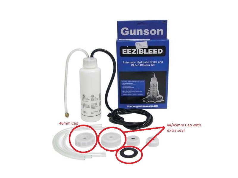

Hello Guys,
I usually do a lot of my own servicing but don't generally touch brakes however I'm wanting to flush and change my brake fluid as its been a couple of years since its had any work done on the brakes and is probably due. I've got a Gunson Eezibleed and read through several how-to's and am fairly happy with the procedure, however the kit comes with four caps that go onto the brake fluid reservoir - two are obviously too small however the other two are listed in the owners manual as:
1) 44/45mm - this is a smooth circular cap and appears to have two rubber washers with it
2) 46mm - this cap is gnurled
I have highlighted them in the attached image.
I have dry fitted both caps to the reservoir and both appear to fit and screw onto the thread without issue.
I've read several horror stories about these kits not sealing properly with the reservoir and brake pedals dropping to the floor and want to avoid anything like that first time out so was wondering if anyone could advise as to what size cap i should be using and how to configure the seals.
Thanks in advance
I used the same kit in my mk2 VRS. I’m sure it’s the knurled cap that you use.
To make sure its airtight use plumbers ptfe tape around the bottle neck and the brass nut that goes into the cap. You can also use it around the brake fluid reservoir too.
Before you try to pump brake fluid through dry fit it and pressure it up to see if there is any leaks that way you won’t spray under your bonnet with brake fluid. Remember to reduce the tyre pressure too to around 26psi.
When you come to change the fluid remove as much of the old fluid as you can from the reservoir first but leave a few mm in the bottom to prevent air entering. Fill the reservoir with clean fluid then connect up the eezibleed.
Make sure the bleed nipples are free before starting the job. Use a six sided socket so it doesn’t slip and round the nipple off. Once you checked them, nip them up and then use a ring spanner to open and close the nipple.
Don’t rush the job and you’ll do fine.
