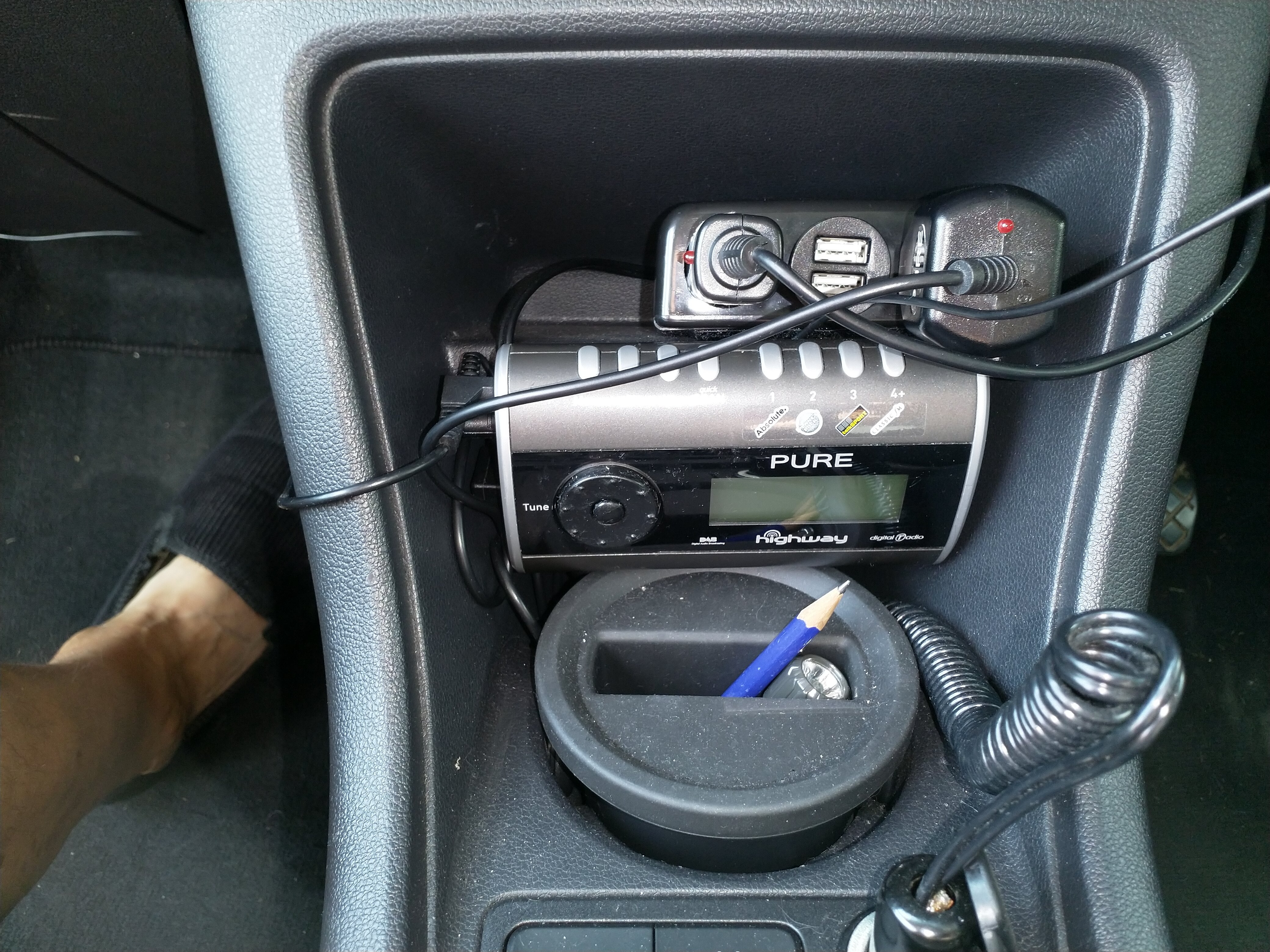

This is my set up.
5 hours ago, peter3197 said:
This is my set up.
Is that factory? Looks almost stock.
Nice little Pure Highway off ebay. Starts up with the ignition, works a treat and doesn't look too bad.
