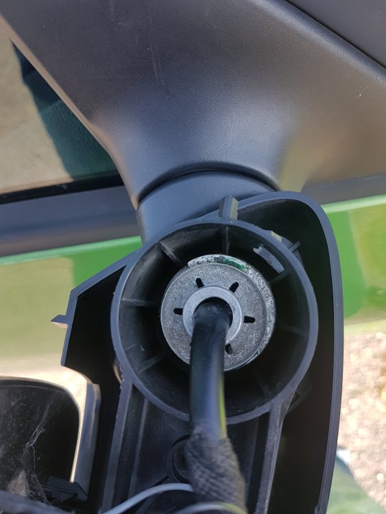

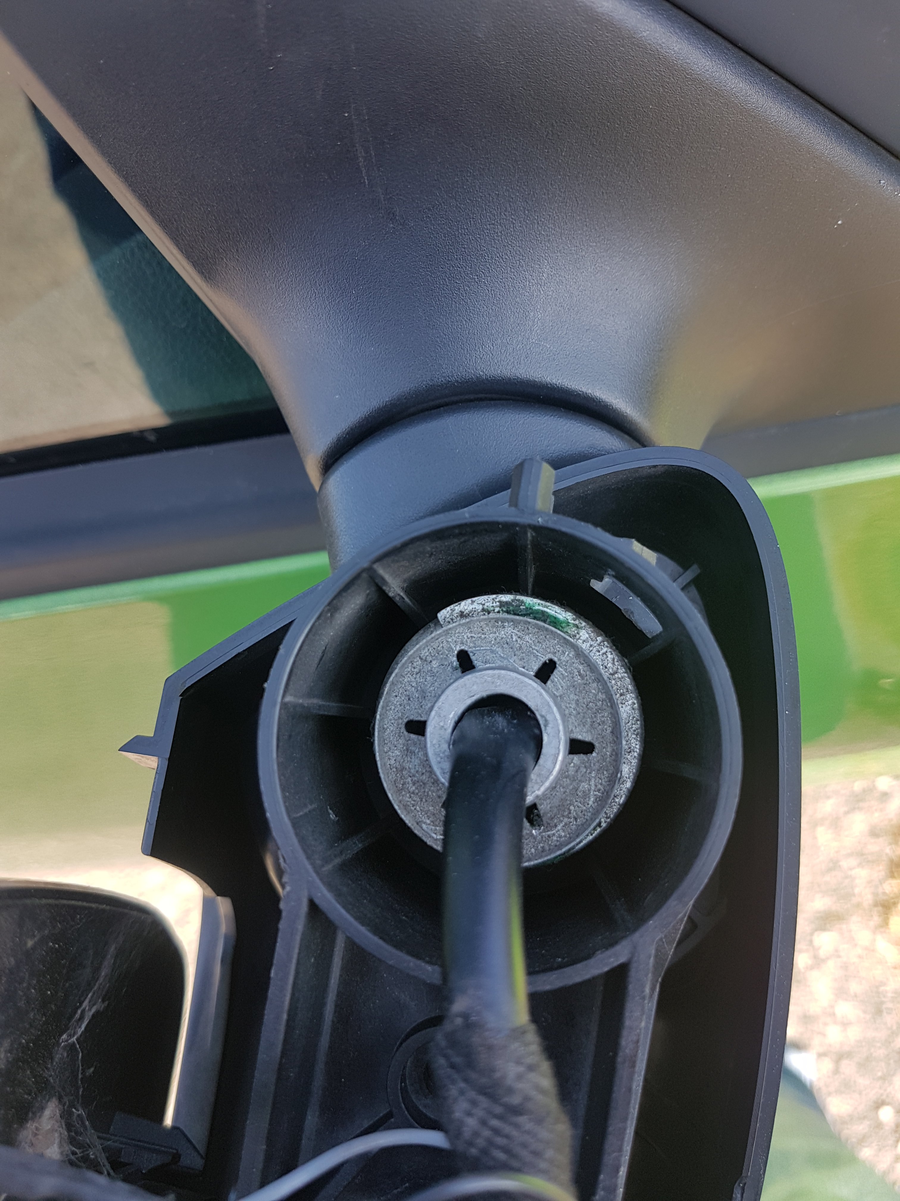

The bottom trim is just missing some plastic at the end so it needs replacing the bottom trim must be able to come off at the joint surely I can't see how though well and truly stumped and no one seems to know.

It doesn't come off so I wasted my money should of got a full unit which I have to do now lol
looks like the diagram shows a screw, the mirror you have, a spring clip washer or star washer. It looks like you could prise off that washer tab by tab and perhaps re-shape it or fit a new one but may be too painful a job.
I think you are mean to come in directly from below, screw number 5 in the diagram. It has a little plastic cover hiding it. it is not accessible from inside the casing.

I took it off mate there's a metal frame inside it seems to be one piece there's nothing I can see to get it off I've removed the old one will have to order a whole unit thanks anyway.
