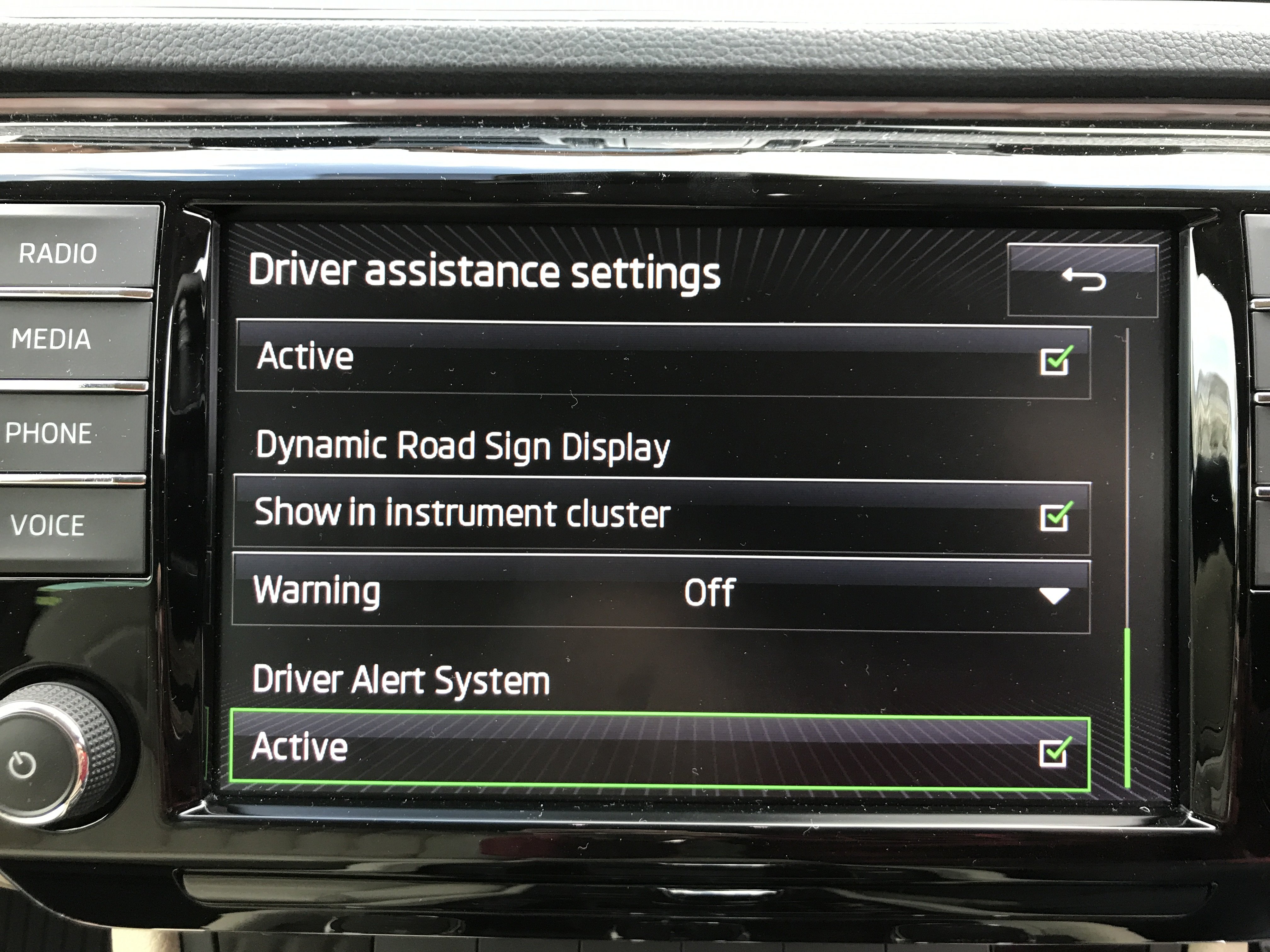

Have the menu settings of ‘Rear traffic alert’ or ‘Driver Alert system’ got anything to do with it?

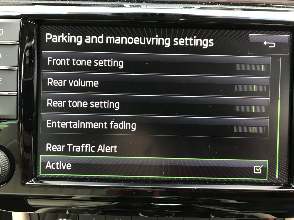

Don't know about that, but you might be able to lessen the annoyance. I've got so used to it that I may be wrong, but I don't think mine mutes the music altogether. There is a setting in the infotainment that controls how much the music quietens by when satnav announcements kick in for example. Try playing with that setting - it may be that you can reduce the music volume reduction (if you see what I mean :)) to zero or at least not to mute altogether. Easier as a start-point than wading into long coding...

correct - there is a setting in the infotainment that allows u to specify the volumes associated to the parking sensors audio settings.
its called "Entertainment fading while parking", under Volume settings.

Thanks, yep, I had already tweaked the audio settings to fade out music so I can hear the parking sensor beeps.  When you have music on and are parking, it’s a good idea to have it fade out to say 25% volume.  The issue is that when it does its 'false alarm' beeps when you pass objects or vehicles at low speeds (ie in normal driving, not parking or manoeuvering), you also get the music fading out - very annoying.
