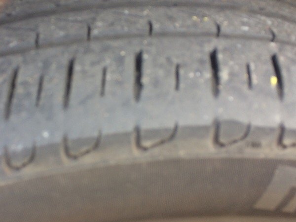

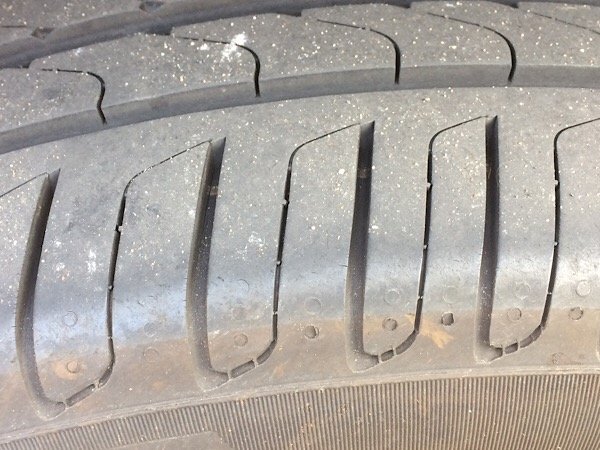

I have Pirelli’s on mine. It has done 20k.
I use winters for about 3 months a year and swap front to back when I have the summers refitted and I have the same wear.
It is on the outside, right on the very edge of the tyre. and only about an inch wide.
i run the tyres at the recommended 2.2 bar and use a calibrated gauge. I guess that it’s just normal for my often spirited driving.
Front
Rear

@CFB - I've seen wear patterns like that on cars with driven front wheels before (both Front and 4WD), usually worse on the LHF wheel because roundabouts.
Yes mine are much the same after about 20k. (Not entirely sure as had winter tyres on for several months)
I have swapped front to rear to even out wear so all will be changed at the same time.
Years ago a tyre manufacturer recommended Not to change wheels from front to rear.
The placing of front wheels to rear doesn't stop the tyre from wearing in the same manner.
When the two front tyres shows wear, (down to limit) change just the two fronts.
A radial tyre will carry on wearing in the same way, no matter where its placed.
The idea behind it was, if you have a fault, (tyre wearing badly)  placing to the rear doesn't erase the fault. The fault is still there, & will then effect the same wear on the new tyre.
You also need to take into consideration, the front lock on the Yeti is extremely good. And this will increase the side wear on the front tyres.
Edited by Carlodiesel
But front tyres wear out twice as fast as rears at least. I would prefer them all to wear out at the same time so I can fit a matching set all around. By swapping around at about 2/3 wear to front and 1/3 at rear then they will all have same life.
And I don’t agree the wear is the same. Fronts scrub off the outside edge much faster than rears do.
